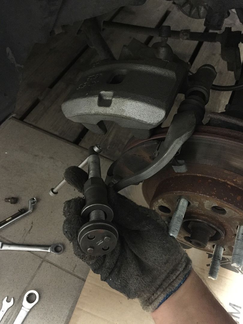

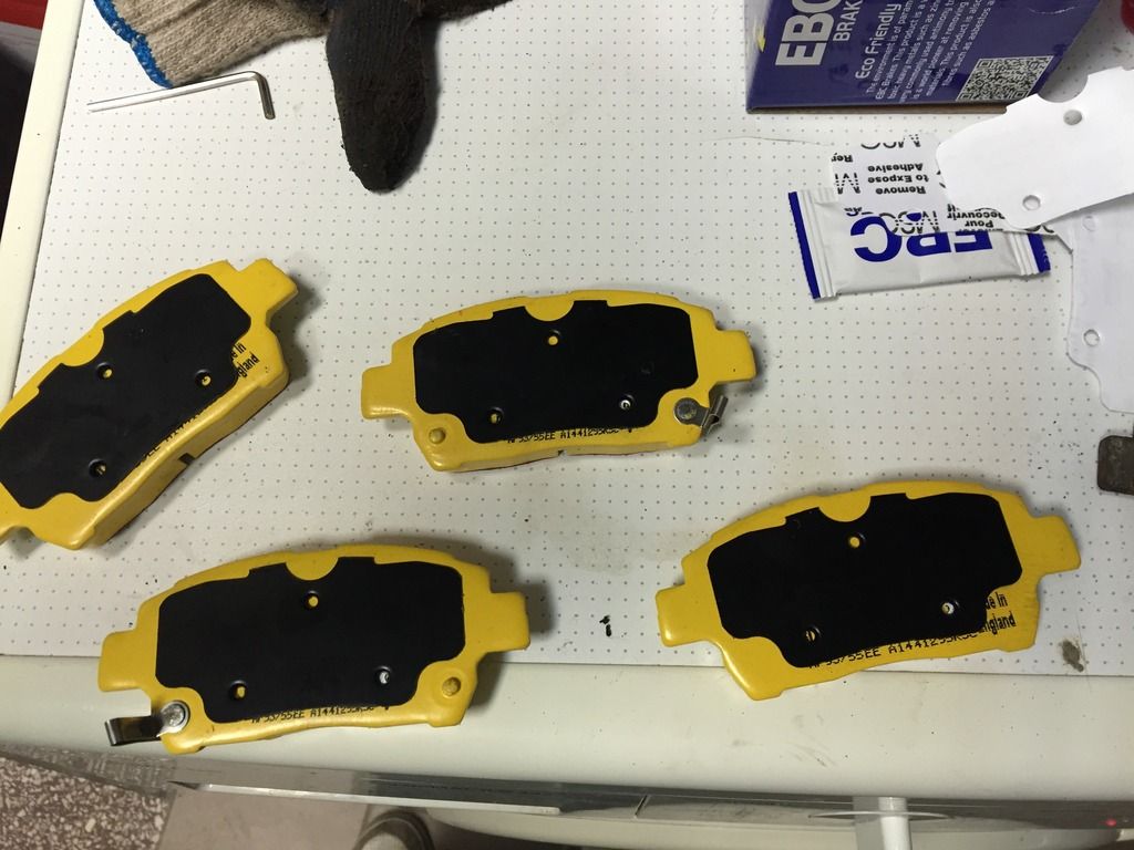

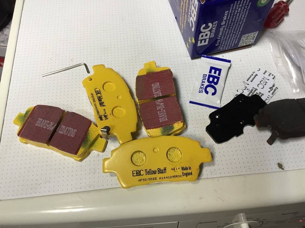

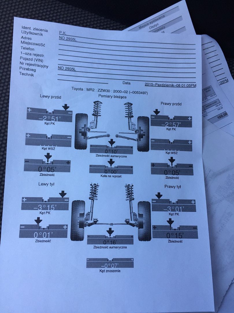

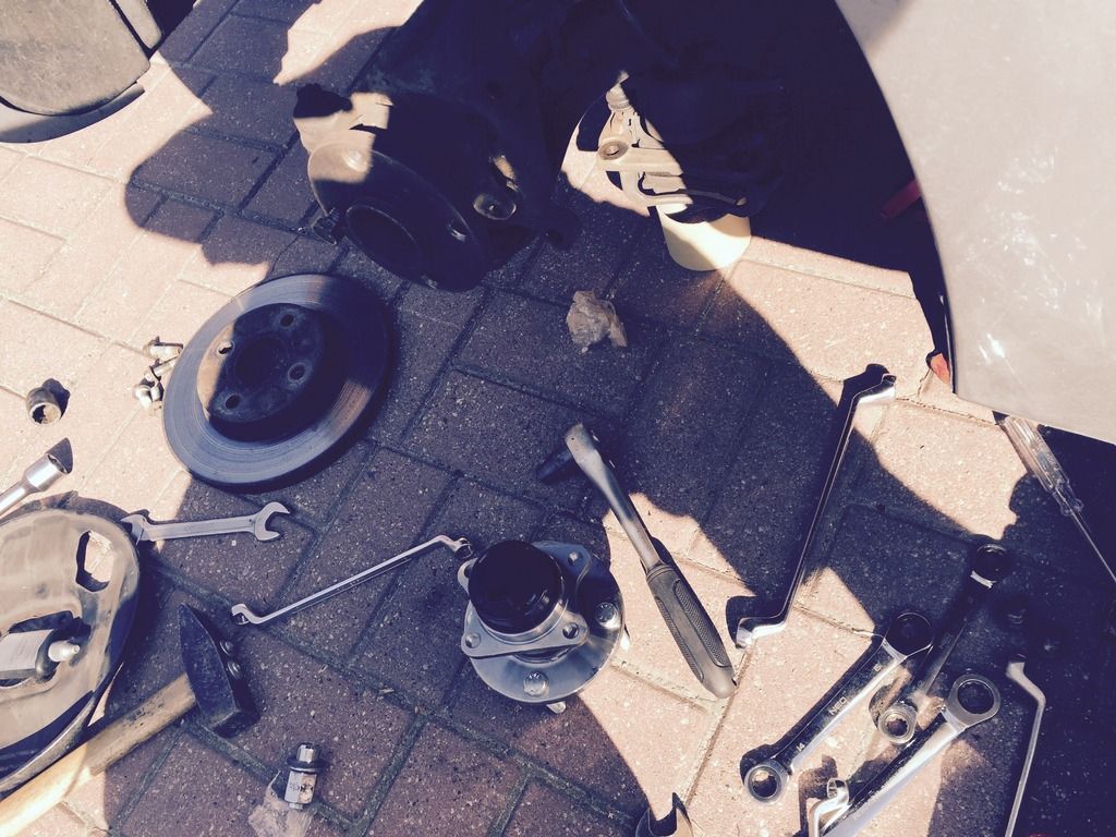

recently I replaced all pads to ebc yellows, replaced rear shocks (for stock facelift for now), replaced front bearing, front dust covers, did all the geometry -3 degree camber all around and set my antirollbars to the stiffest setting

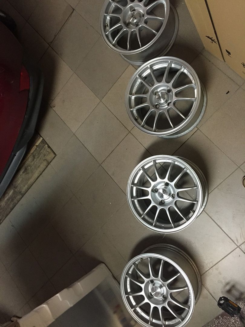

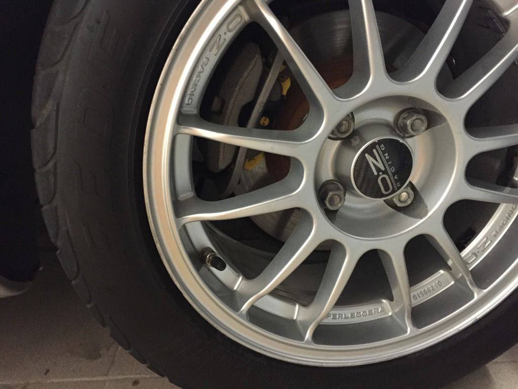

And today I decide to replace my wheels for lighter ones, oz superleggeras 15x7. They weight only 5kg a piece!

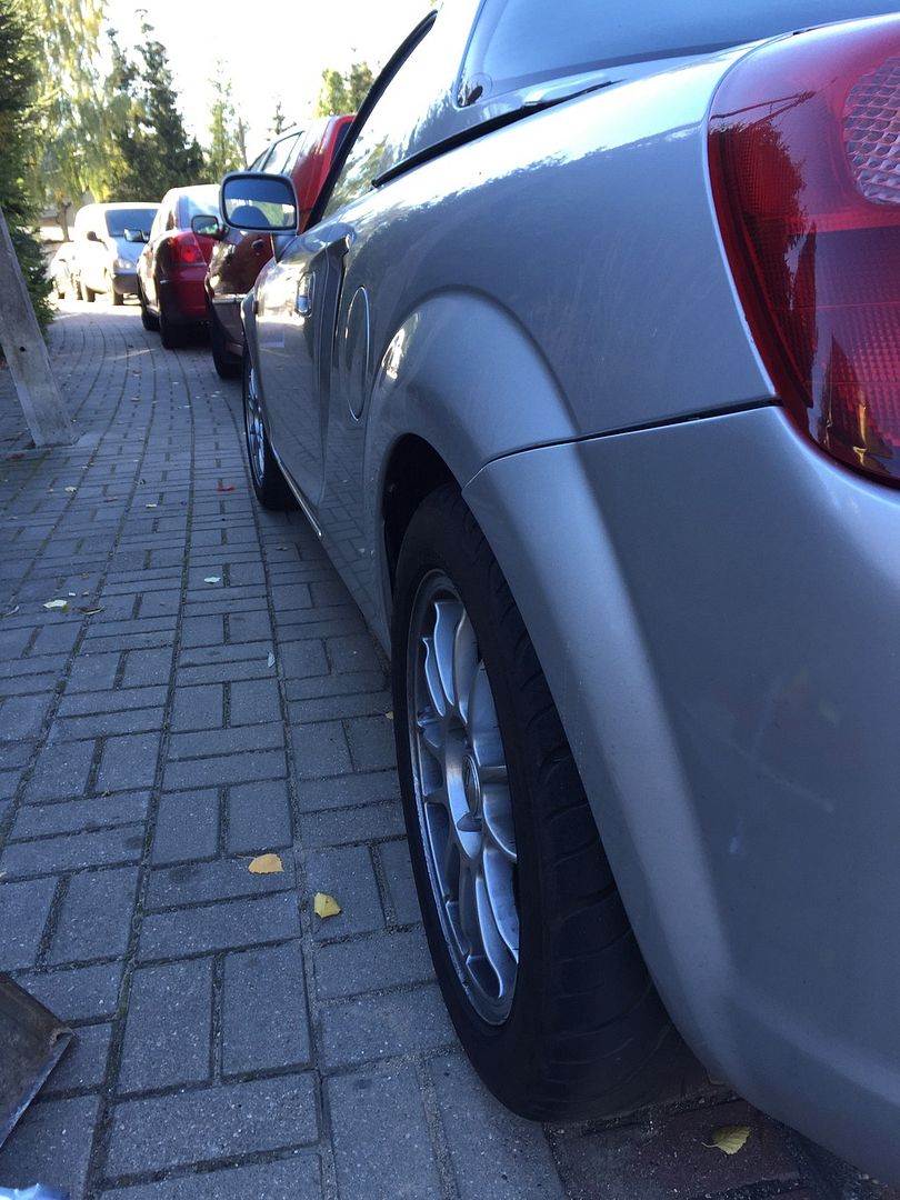

Brilliant! Love how you've set the negative camber. No farting about with bolts or arms... Just widen the hole! Haha

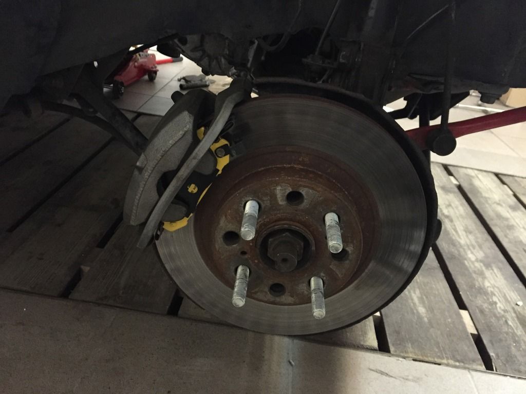

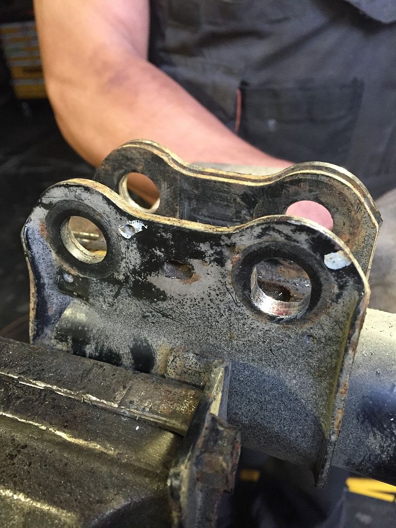

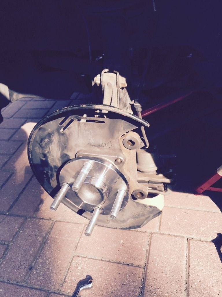

today I did the geometry and it turned out that some of my rear wishbones bushings are shot   s:cry: :cry: s:cry:  are there any polyurethane bushings for rear on the market? Especially I need the ones that sit inside rear axel carrier
#162
I'm sure GT4-Play can sort you out but...I expect you to be able to make your own bushings by now!  s:D :D s:D  haha
#163
Yes super pro make all the polybushs for the rear apart from the one on hub at the bottom.
Also a cheeky nudge on antiroll bars   s:mrgreen: :mrgreen: s:mrgreen:

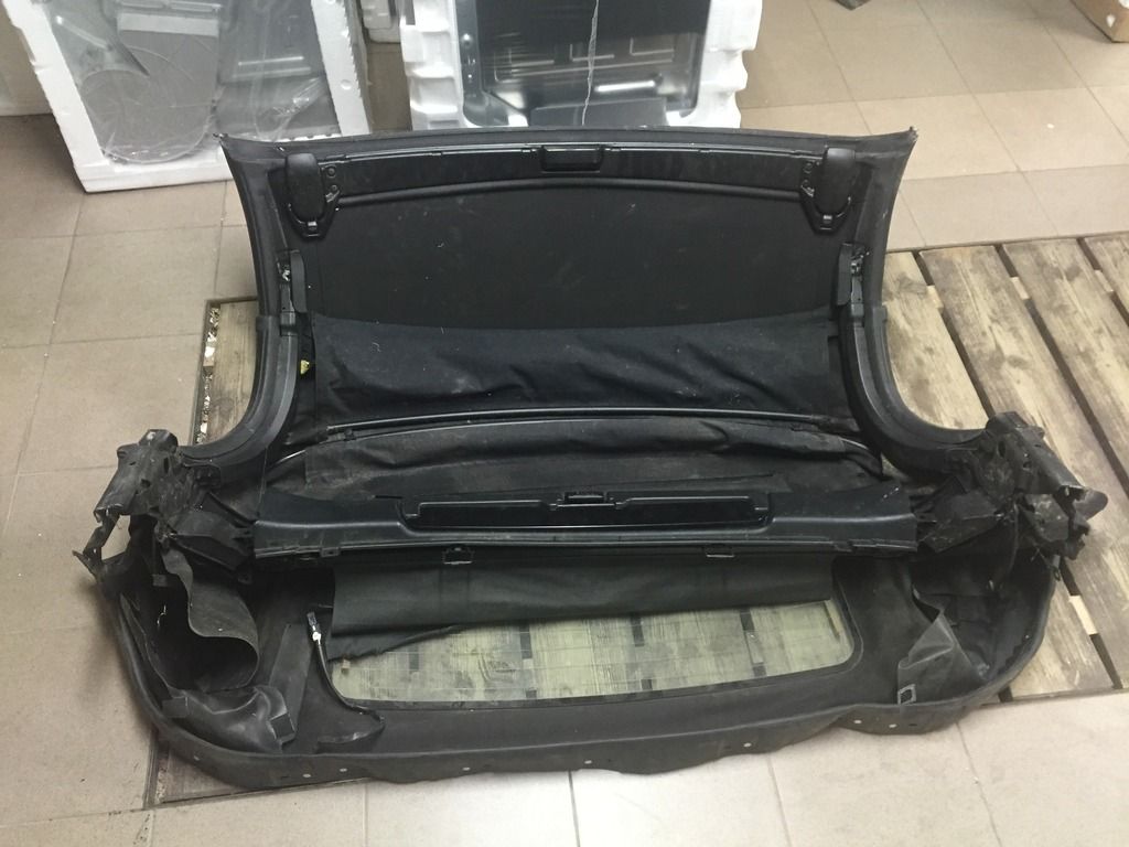

I have already made cad project of all rear bushings and search for company to fabricate them. I have 3 offers now, neither is cheaper than full rear set of superpro bushes with shipping form Australia   s:D :D s:D   also i'm waiting for package, I bought ripped softtop for cheap so soon some weight reduction

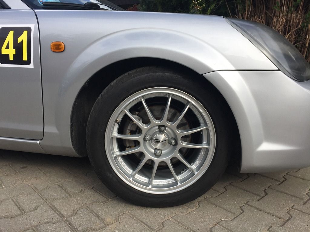

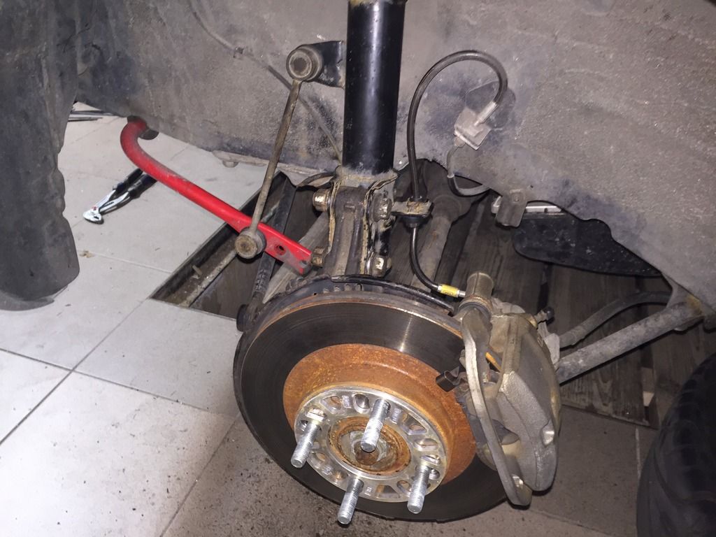

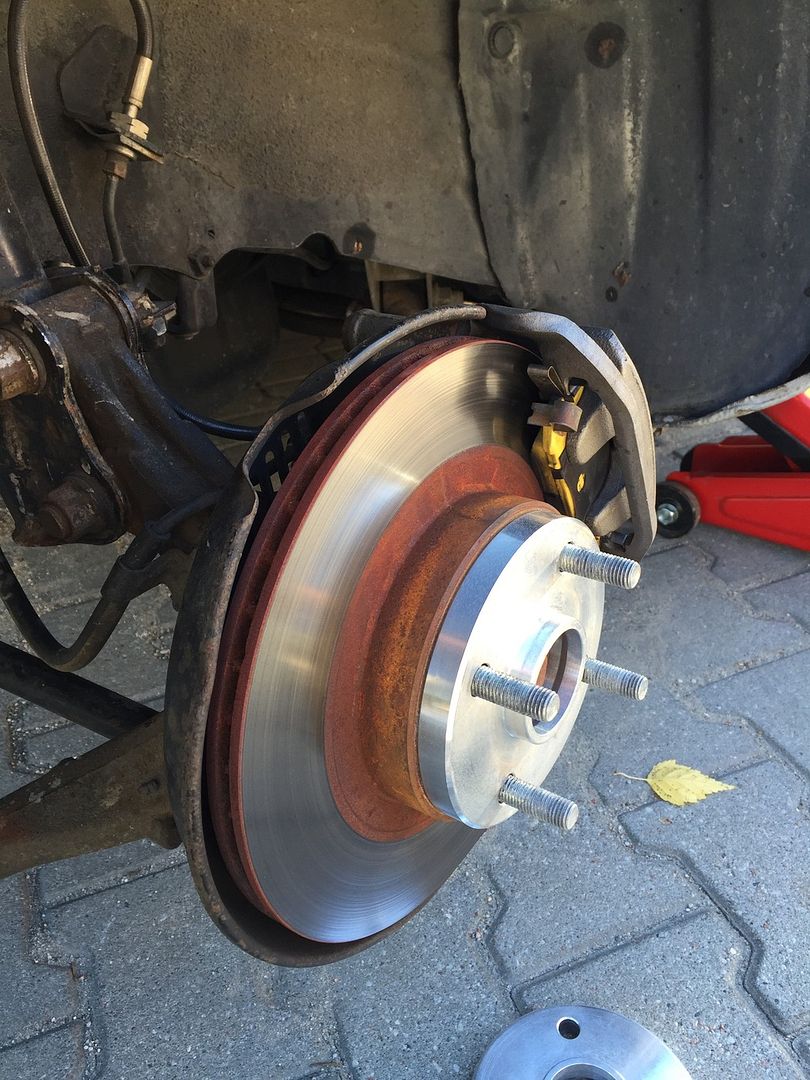

Mounted spacers for wheels, rear 15mm, front 5mm
I decided to seoften a little bit rear arb to get more traction shooting out of corner on loose ground.

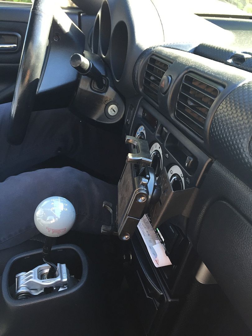

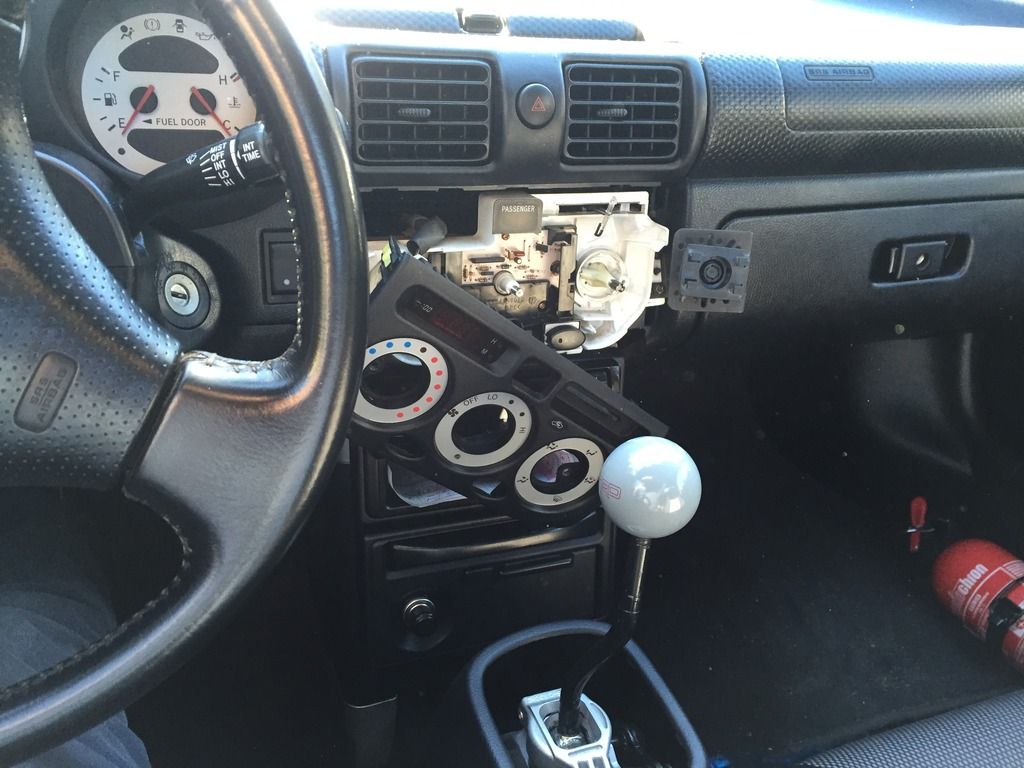

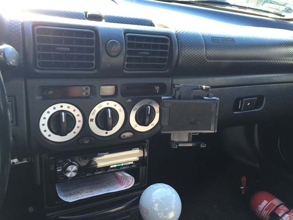

Smartphone mounting kit

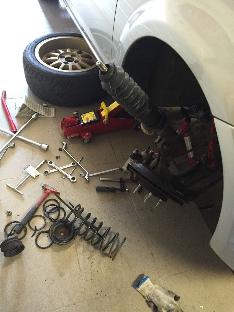

gemoetry and rear suspension check
As I said before, rear bushings are shot, I will propably buy full superpro set

I replaced oz wheel covers for carbon ones

I'm going to have to copy that smartphone holder idea. Very clever to screw it down under the heater panel

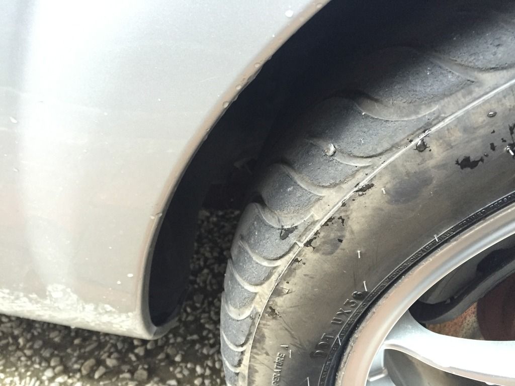

Did the front have much damage after plowing into the tyres? Surprised to see such a big lock up to be honest.
Street Triple 765 RS
jaworjawor
#171
suprisingly not much really, look closely in this photo, that's it
the speed at that corner was very high, it was my mistake I forgot which side to attack the chicane, then I messed up everything  s:D :D s:D

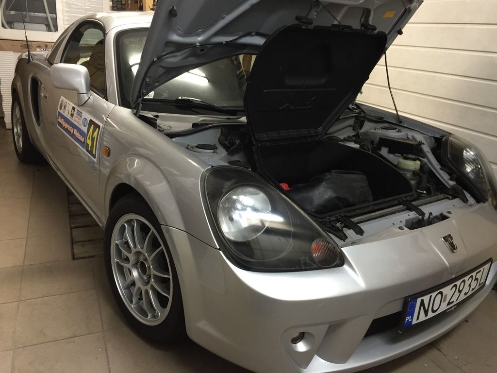

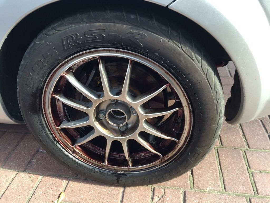

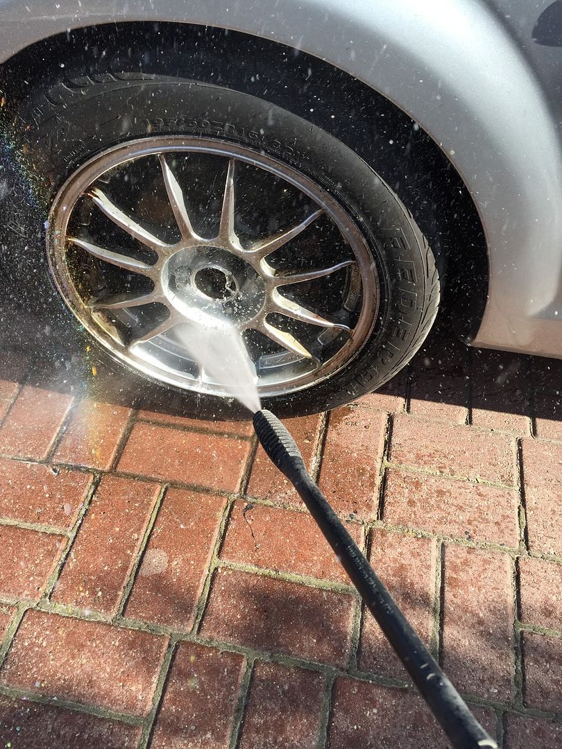

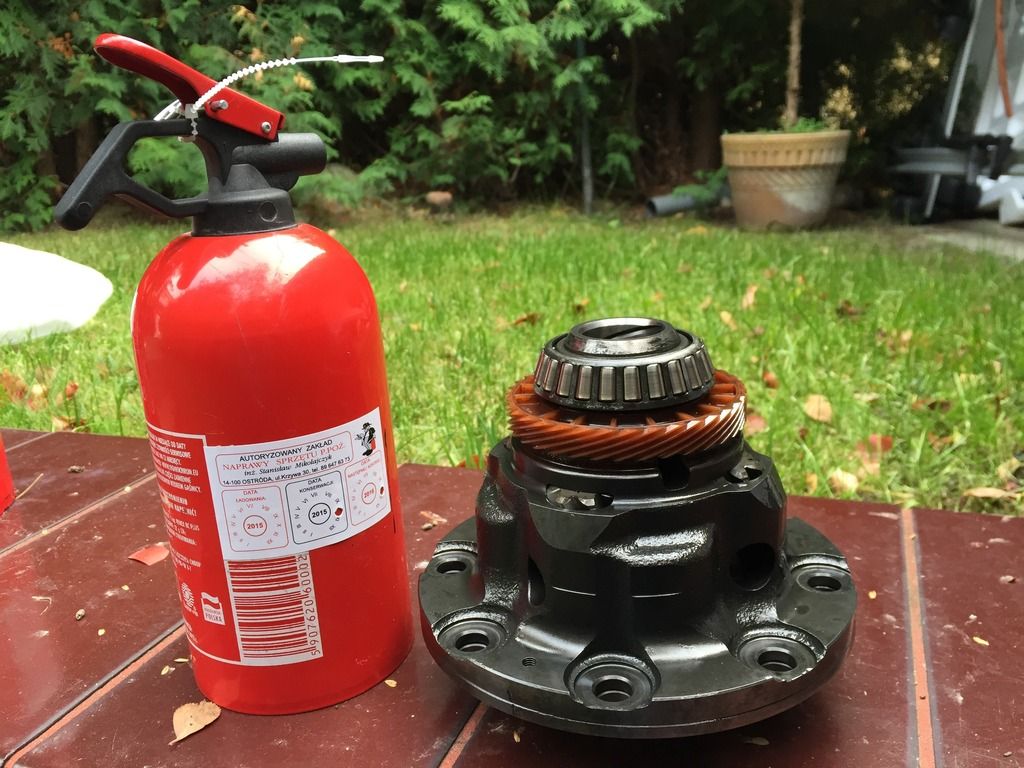

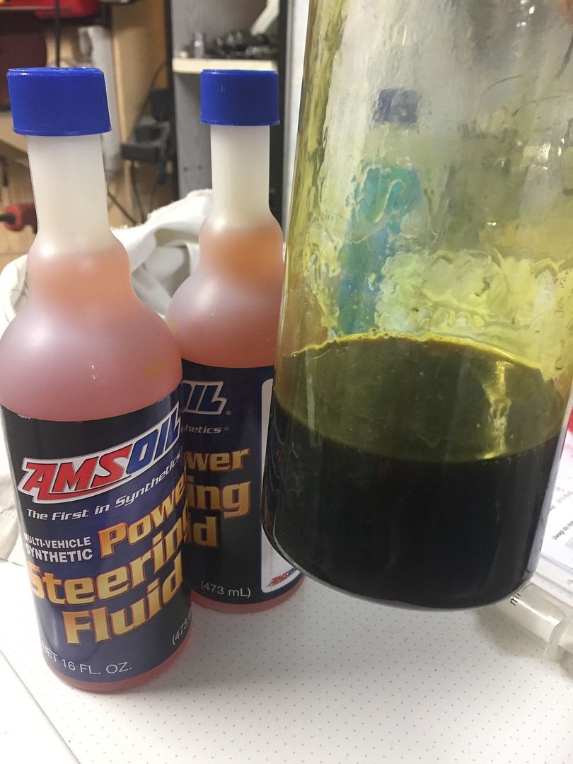

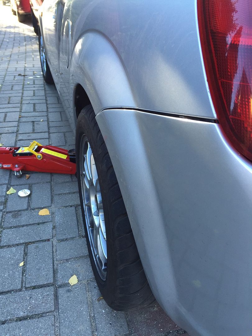

recently I repaired tyre puncture, checked fire extinguisher (lsd is not mine, I have one already) and replaced power steering fluid. The fluid is not easy to find it needs to be eh type, I found ansoil fluid which is suitable for toyota ehps. 1 l is enough tu flush the system

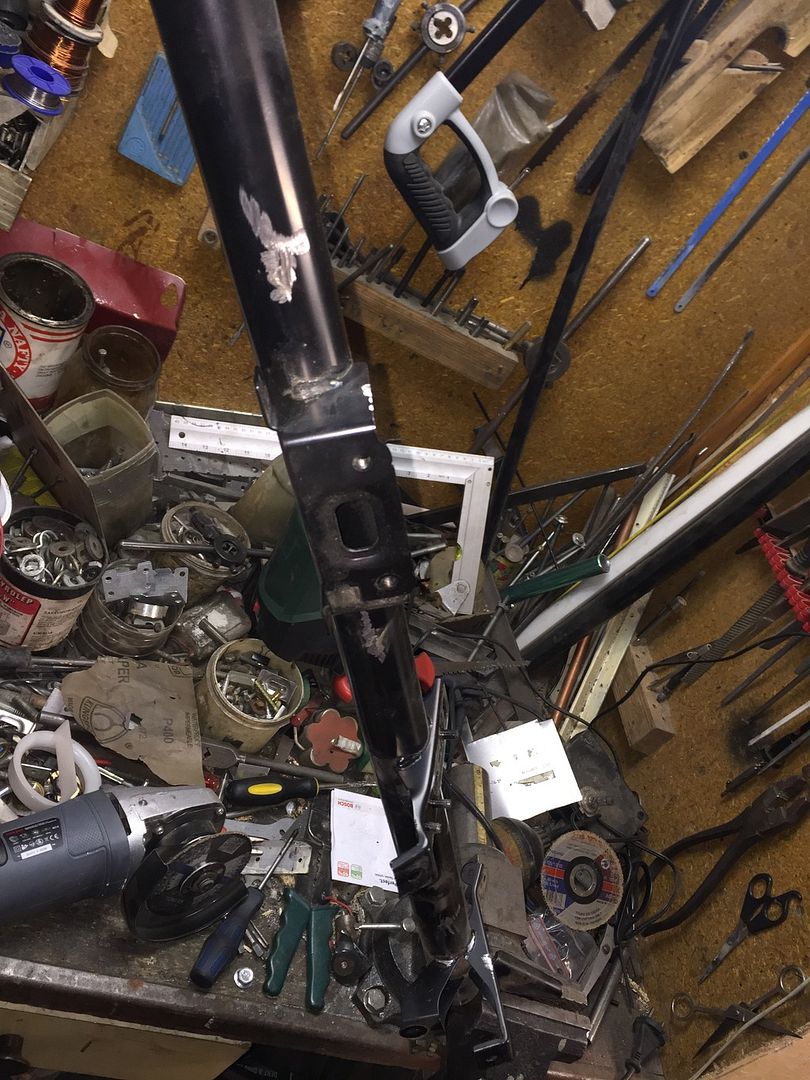

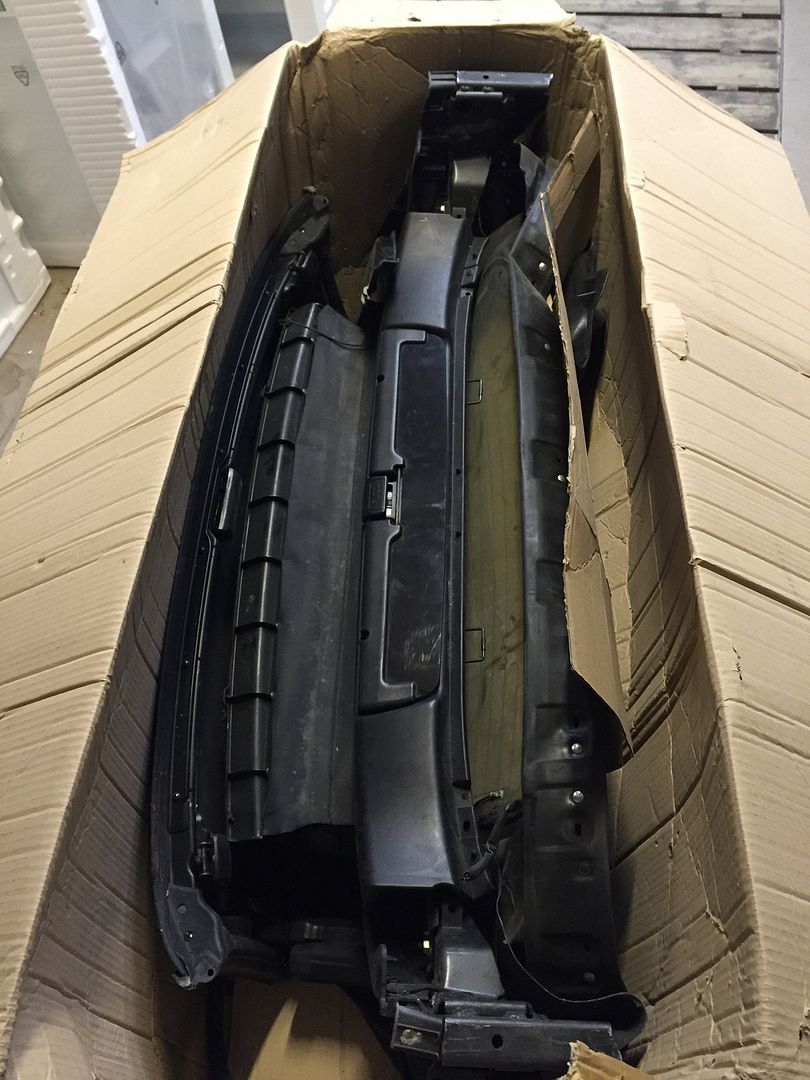

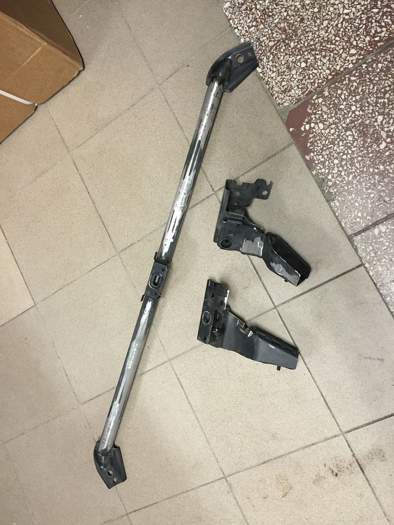

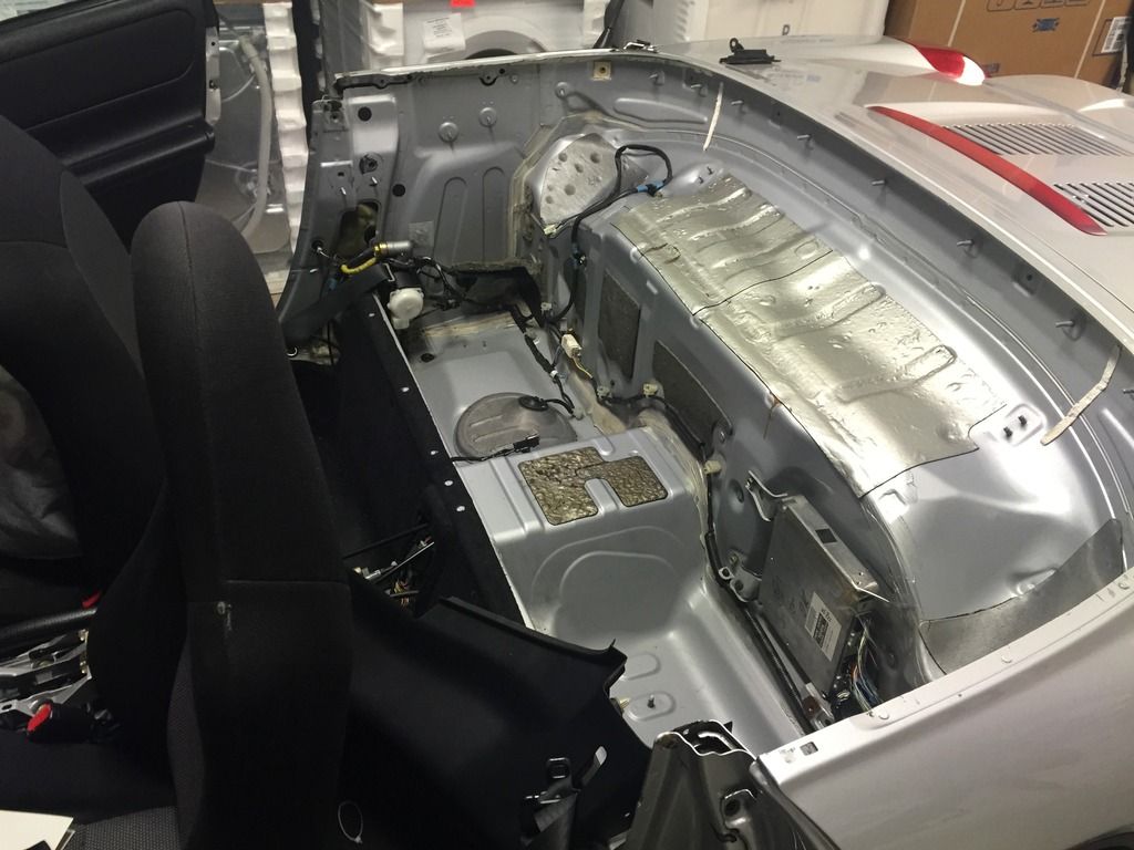

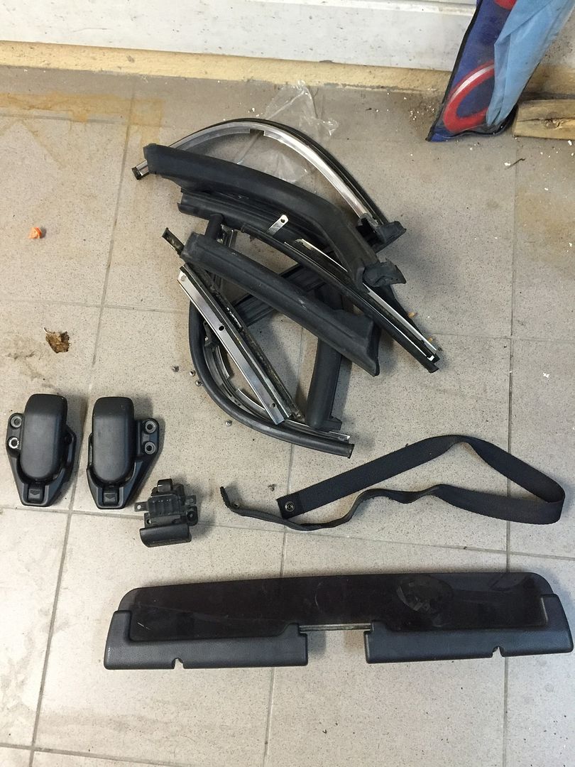

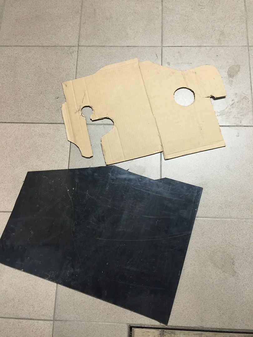

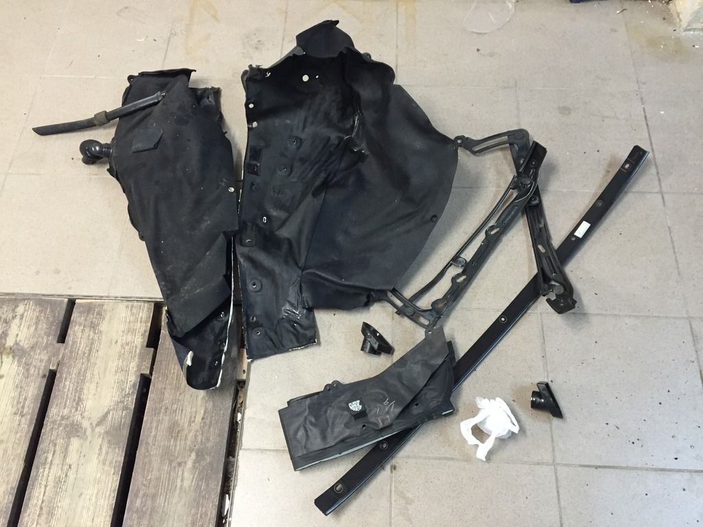

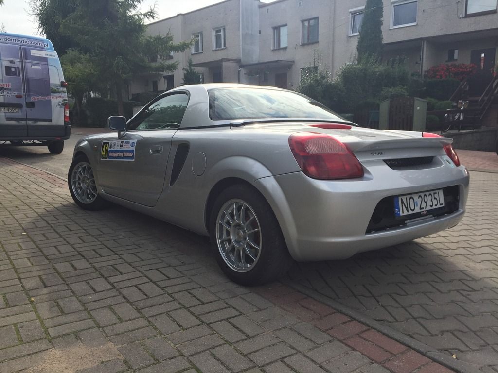

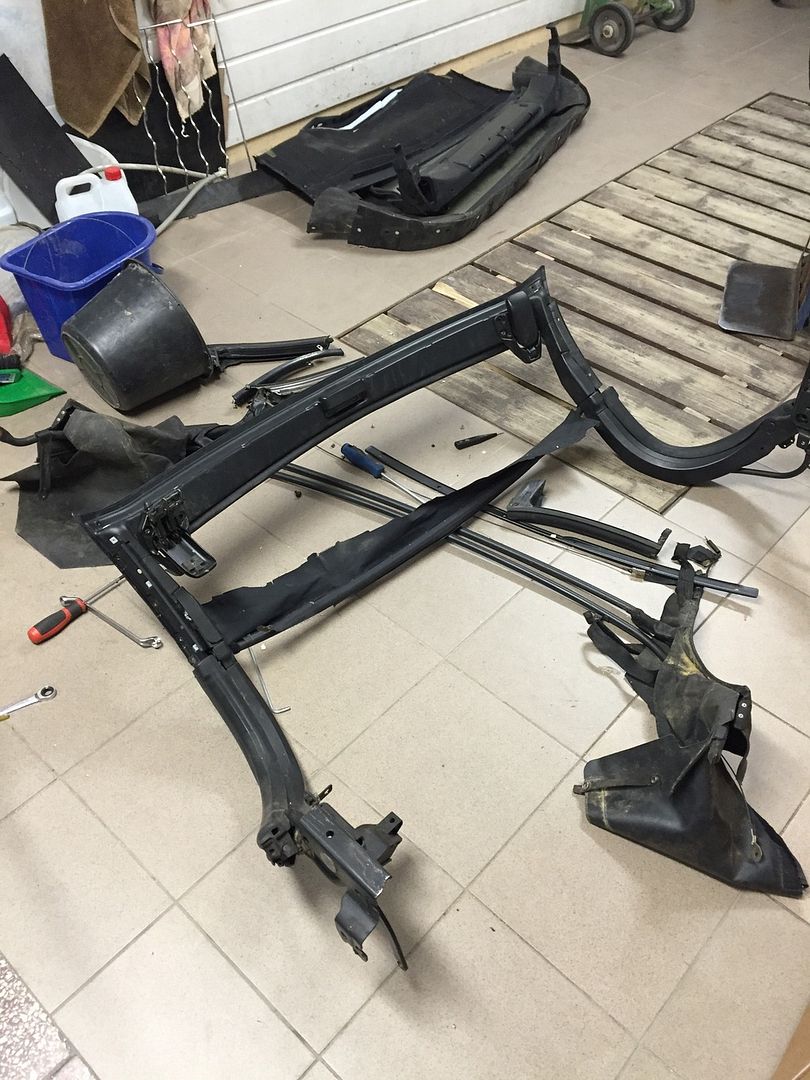

I decided to ditch my softtop. To do so I bought ripped softtop assembly, cut out the brackets with angle grinder, enlighted them a little bit
brackets, one after cutting out unnecessary parts. The bar was smoothed out, it will be my harness bar once I mount bucket seats
few hours later the softtop was out. I cleaned everything and packed my healthy sofftop to storage for better weather
complete sofftop assambly with everything related to it weighs 28,2 kg. The bar and side brackets weight 4,4kg, which gives weight reduction of 25kg, not bad. for reference complete hardtop weighs 22,6kg, so less than softtop and it is muuch much stiffer and safer. I removed some gaskets and seals from the ripped softtop I bought and thrown away what was left of it

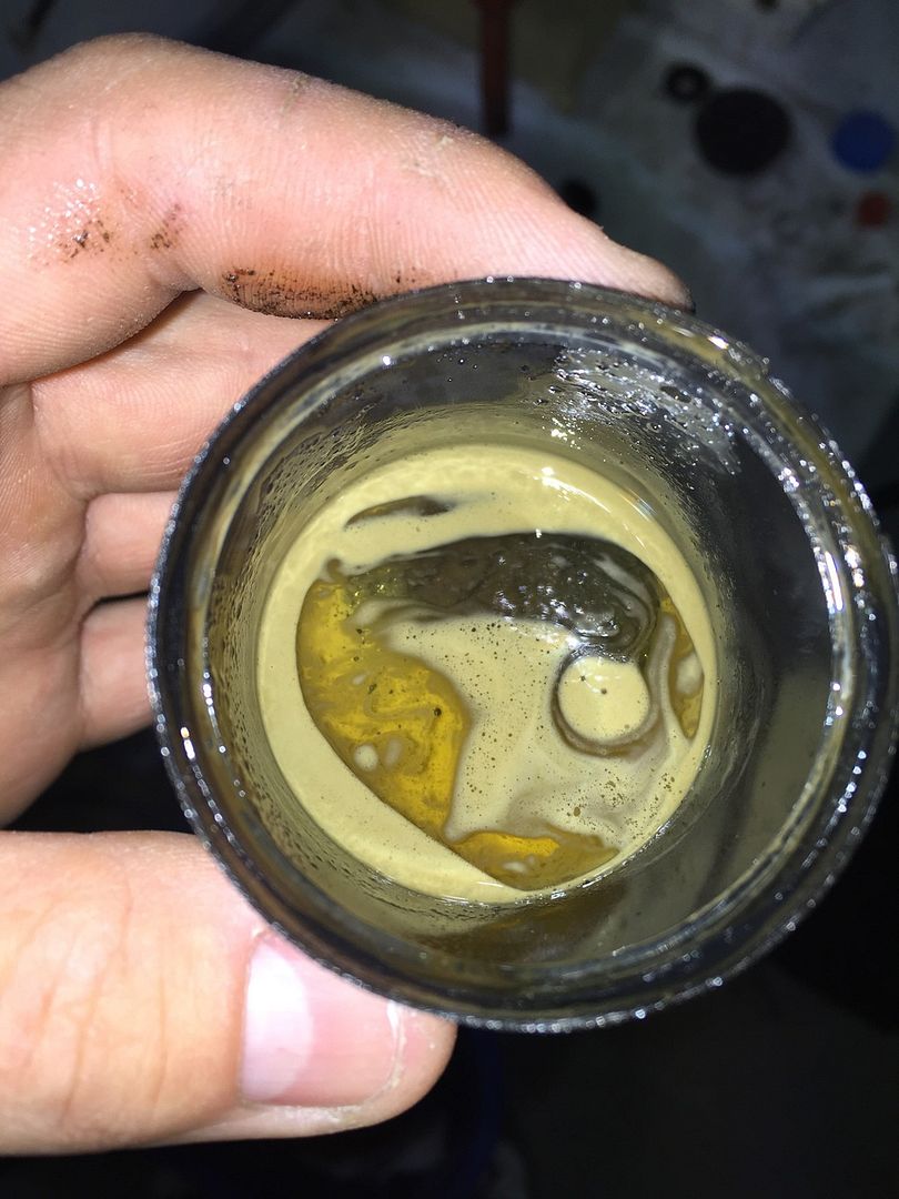

I also emptied my catch can, this is what was in it   s:shock: :shock: s:shock:

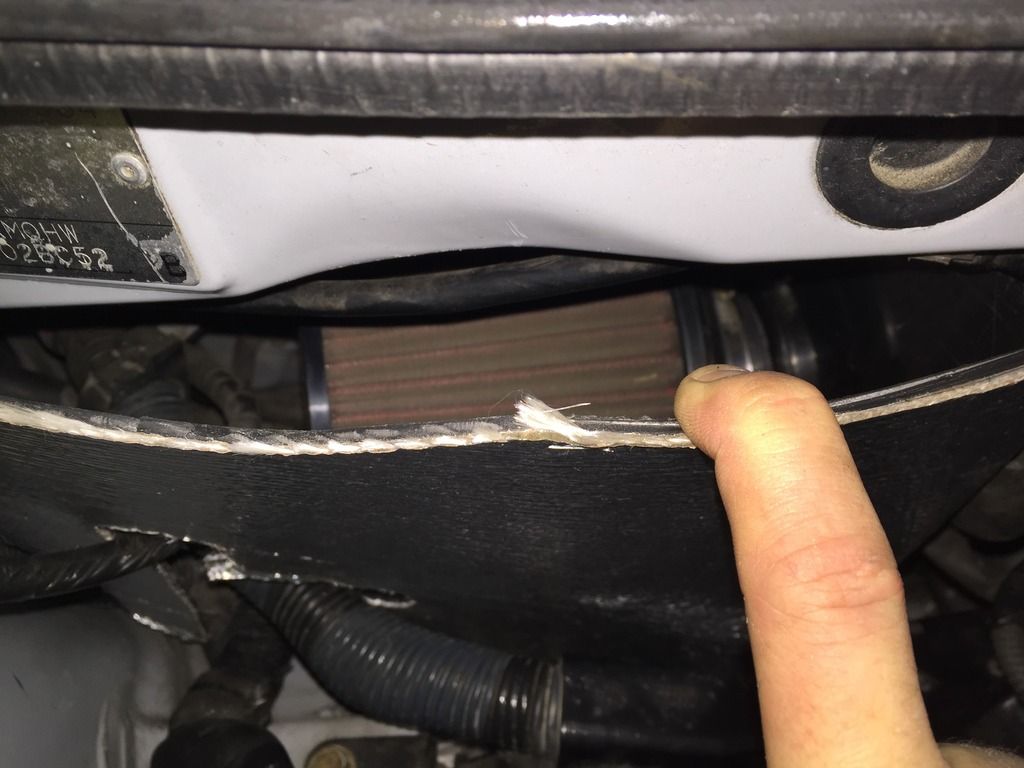

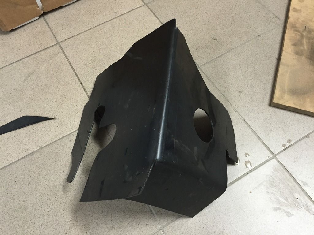

In the end I fabricated some heat shield for my intake, now engine breaths only cold air from side scoop
