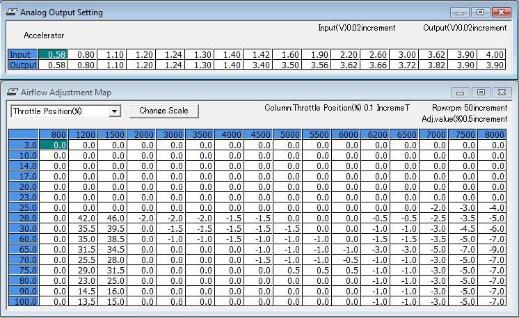

i am interested in doing this, do you have a circuit diagram and parts list?
mr2 2zz with T-Sport gearbox and 8200rpm Celica ECU, DIY lightweight exhaust, K&N Typhoon induction, MiesterR coilovers, Rear Strut Brace, Underbody brace, EBC Yellow stuff and braided hoses all round, Rota slipstream 16x7 6kg a corner, Lightweight optima battery, spare wheel, tools, radio & aerial removal. Wifi ODB2 reader with dash command app for iPhone
keljon
#57
forget that, seems the emanage ultimate can do this directly by putting the TPS signal through an analog input / output
found this thread
 m http://www.newcelica.org/forums/showthread.php?t=292366 m
"What I do is take the tps signal from the sensor and run it into the analog input on the ultimate. Then take a wire from the analog output of the ultimate and run it to the ECM TPS input."

And you seem to have done it AGAIN with convincing me to spend money!... .arrgh...  :-) :-) :-)  Hopefully Lee can suggest a way of keeping it in open loop based on the throttle position as you said..
jvanzyl
#64
Good news! Lee is going to use set the throttle position on the emanage to 75% (using the Vtec input) to force open loop  :-) :-) :-)  (apologies if I have all the words in the wrong order there... I literally have no idea what I'm talking about).
So it'll be interesting to see how it works out..

Quote from: "jvanzyl"Good news! Lee is going to use set the throttle position on the emanage to 75% (using the Vtec input) to force open loop  :-) :-) :-)  (apologies if I have all the words in the wrong order there... I literally have no idea what I'm talking about).
It's interesting indeed. Personally I would use a switch to mimic boost input.
I'd like to think that you could basically force the car into open loop when you want to, basically almost standalone. Then flick the switch when you need the ecu to play nice with the o2 sensors for MOT.
Alternatively, and a bit more complicated, can you not just leave it as-is and instead of using the MAP sensor, use a feed to mimic the voltage sent by the MAP sensor for 0.5psi boost (that's what Lee's is set to right?). So, tricking the emanage into thinking there is boost. But keeping the boost map zero'd

Quote from: "jvanzyl"OK  - so my question is, is 75% throttle an everyday usable way of engaging the emanage? I'm assuming here that it would engage after 4krpm anyway..  and that this setup in theory it would have no issue with an MOT test?
Well I don't know the ins/outs of the 75% theory. I think what Lee is trying to achieve is make it so that when you're trying to get a move-on but the car is still in closed loop (depends on rpm, temperature, throttle, etc etc), you can make sure it switches to open loop and follows your (more aggressive) map instead.
But when you're tootling around the car goes into closed loop as per normal parameters and runs for efficiency, as designed by Toyota.
