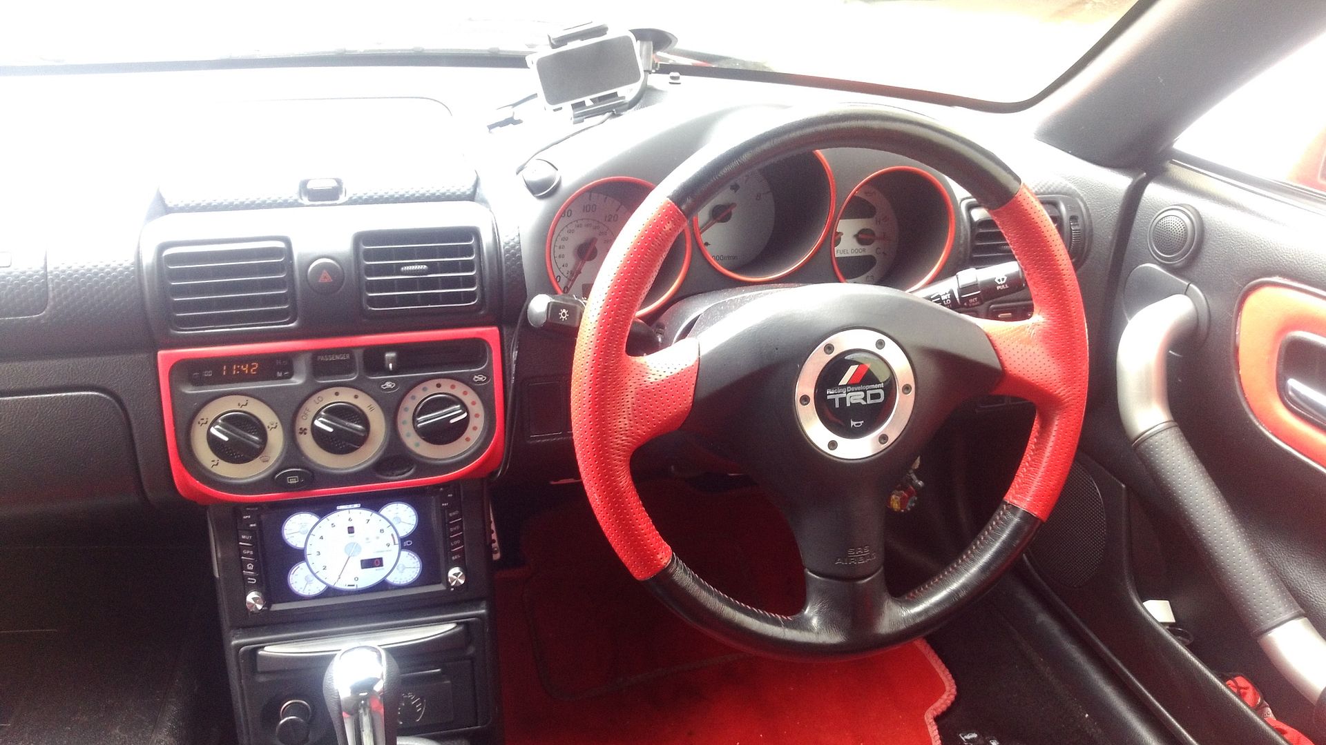

I have one fitted although I have the rexypow centre console,but still fits nicely with the standard set up.
All I had to do was trim the plastic surround from the original stereo and a wire harness/adaptor from Halfords.

Ahhhhh looking good. Do they recess back ok? What models are they?  Are they visible ok with the roof down?

kolleykibber
Hi. I have just fitted one of these. The two pictured here look great. I have a generic AN21-U running Android 4.4. Couple of questions for you if you will...
 Headcase, you seem to have some sort of surround, where would you get one of these?
Also I see you are running Torque. Did you run the CANbus lines directly from the ODB2 socket? I noticed that the an21-u does not allow bluetooth for anything but phone audio and media. I thought the mr2 is not Canbus compatible? P

lron
Quote from: "kolleykibber"Hi. I have just fitted one of these. The two pictured here look great. I have a generic AN21-U running Android 4.4. Couple of questions for you if you will...
Thanks!
Not 100% sure but that does look like the original PFL stereo surround in both pics. Unless you're referring to the red trim on the HVAC controls.
Same stereo surround on Andy's and head case. Only difference is headcases is upside down. The trim only came with the pfl Sony unit.
