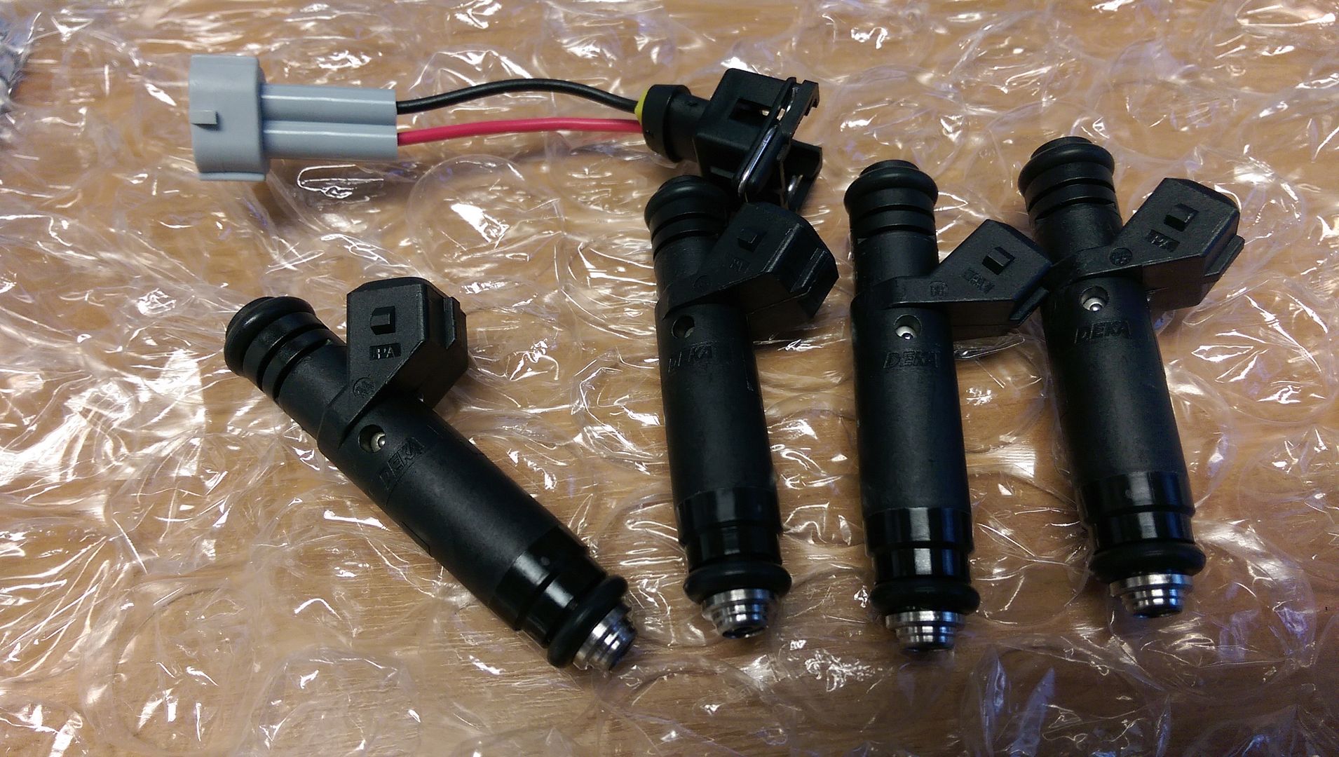

These turned up today, the adapters look wrong but might be both male and female connectors in one.

Quote from: "Mark A"These turned up today, the adapters look wrong but might be both male and female connectors in one.
How much were they? are they 630cc?
The adapter will be: Black Plugs into Injector, Grey acts as plug (Toyota Injector) for Injector plugs in bay.

Yep I was being thick thinking the grey adapter fitted into the Denso injectors, but it fits the loom so the connectors are all OK.
Yes Siemens Deka 630cc injectors priced at £169 with delivery and the P&P adapters.

could you confirm which adaptors you have?
is it these ones?
 m http://fuelperformance.co.uk/index.php? ... ct_id=5101 m

That's them, I sent him a picture of the green Mr2 injector and he did the rest, give him a ring and just ask for the same as a Mark's MR2 turbo
