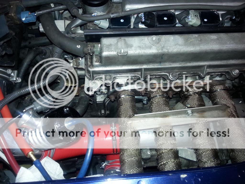

Couple of pics
Inlet to supercharger:
Top view, with extra support for manifold from bottom of block to the cross-piece
lamcote

Looking good. Is the plan to recirculate the air from the BOV outlet back in to the supercharger inlet pipe?
Silver 2004 MR2 -  Unmodified but very shiny.
#557
Was just going to allow it to vent.  Unless you have a good reason for re-circulation?

David and I have just chewed this over.  It seems that the re-circulate option is recommended 80 - 20 over simple blow-off.  So we'll put the plumbing in.
#565
She runs.
Well, she's idling OK and revving freely.  Don't know how she will be under load.  I removed the Emanage from the system, as it was just not behaving (probably a wrong connection).  So I started her up on the stock ECU (she's got 2zz injectors).  A bit on the loud side, but definitely legal. It was showing an eml (no code) with the Emanage in place.  No Eml with it out of the way.  Now to get the Emange to do what it needs to do...
