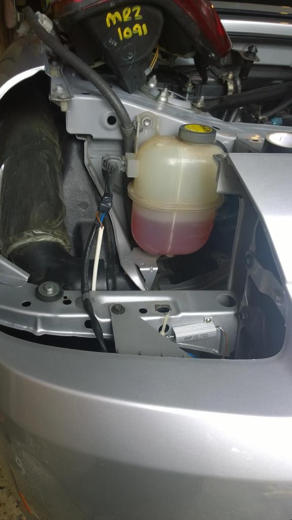

Hi, all done fitted resistor (27 ohm 50 watt £2 89p inc free next day delivery) behind left rear light unit, took about 30 mins, cleared code and went for a spin.

Quote from: "roguk"Hi, all done fitted resistor (27 ohm 50 watt £2 89p inc free next day delivery) behind left rear light unit, took about 30 mins, cleared code and went for a spin.
Did the code stay off?  I'm guessing this won't fix the P0136 for the same sensor?
Nice and neat. I guess if it's gonna fail it'll be in the first month or so of usage.
Keep us posted.  :-) :-) :-)
