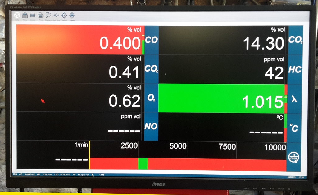

OK swung by my MOT guy yesterday afterwork and after 10minutes of chatting while car sat idling staying warmed up (had just done 10miles drive to get there) we hooked it upto the gas analyser to see what she is putting out.

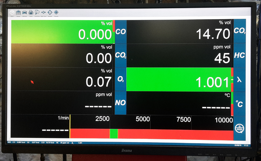

Sat at idle and fully warmed up straight away it failed on CO as expected with numbers pointing to cat not performing as it should, next we held it at 3000rpm for fast idle test and after about 1 minute of this the cat became active and emissions dropped to as they should be, left it like that for a minute or so and emissions stayed constant at mot pass levels, let it drop it back to idle and stayed good for about 5minutes before emissions then rose again and went back to CO fail level.
So it would pass the MOT as it is providing it doesn't get any worse, but when driving normally/steady its not getting cat hot enough to keep the cat active which is triggering the P0420 code.

Below are pictures from the tests, first up sat idling after 10mile drive to warm it up...
And after holding it at 3k rpm for a minute or so...
