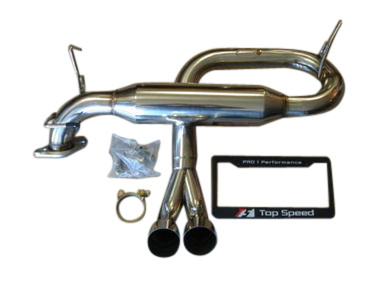

Quote from: Gaz2405 on September 16, 2019, 10:36Or ask Malian to make their centre exit lotus style one with just one back box.
That already exists.
The issue is that space limitation then dictates a very slim ´box´.
Also; any such style exhaust has the extra bends and rerouting of heat; form before function.
If you source an old OEM box, you have the flange and bends ready made.
As a perspective here the Fujitsubo solution. It has a free flow main box, a resonator and an additional absorbtion damper:

Gaz2405
Quote from: Petrus on September 16, 2019, 11:18
Brilliant that's the one I'm after....

Quote from: Gaz2405 on September 16, 2019, 11:37Brilliant that's the one I'm after....
Be warned that it is LOUD. It has minimal abosobtion damping only.
Also, the cat is the main restriction.
