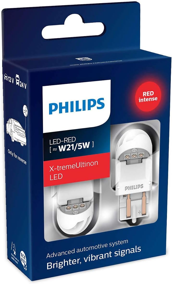

A gf commented on the rear running lights being quite dim.
They were.
Ordered Philips LED 21/5W direct replacements.
The swap is not even 5 minutes work.
The old ones definitely were ripe for replacement as the bulbs were blackening on the inside.
Being red LEDs they do not blind but they sure are brighter!!
