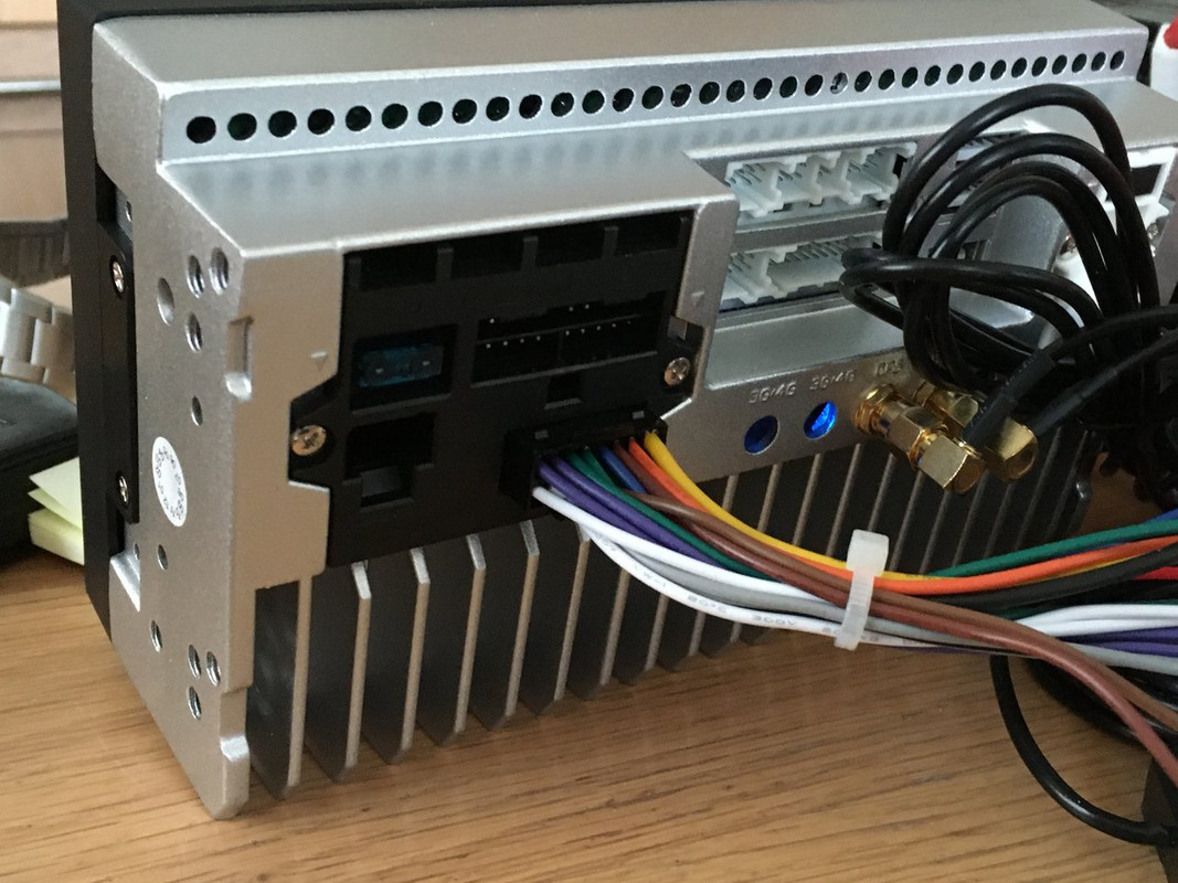

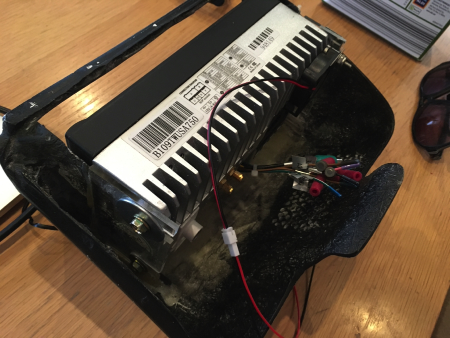

I've a bench top 12v DC battery and setting it up before I fit it into the navpod, I can see I'll be making cuts in to the pod to get the unit in
One thing I've discovered straight away, one corner of the unit after only half an hour gets a bit too hot to touch, maybe there isn't sufficient heat sinks for the PX5 with an 8 core
This is the location where it gets a bit too hot
now I'm looking for a heatsink to place at this corner and one of the fans attached to this heatsink while the other fan attached at the (inside) holes on the navpod
Am I right in thinking that the fans should be pulling the air away from the unit and also pulling the air out of the pod and not the other way round?

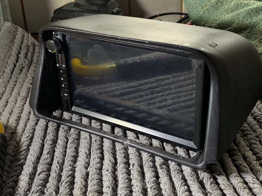

I made a start on cutting out the aperture in the Navpod last week, I took my time and did small cuts at a time, I still have more to cut out as it's very dusty cutting the fibreglass it's something to be doing outside and the weather hasn't been too cooperative in this respect so still have a bit more to do
I plan (if possible) to have the face off the head unit vertical  in the navpod and not follow the slope, so used an angle finder to see the angle of the cut I need to get the face as upright as poss, looks like around 20 degrees should do it

In the end I had to cut out most if not all of the nav-pod insert as it was just too small to get the head unit in

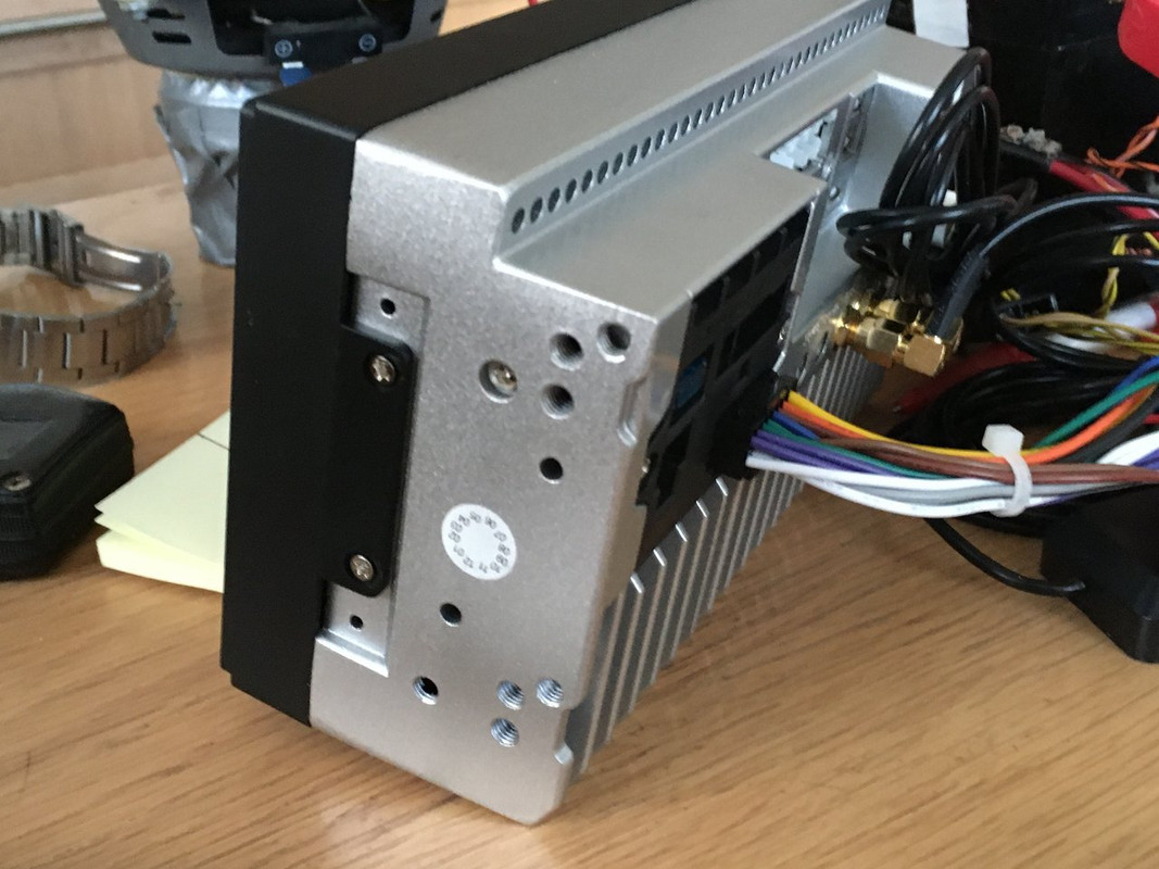

The insert is tapered so the bottom front is/was just over 200mm and the top front 175mm at the back it was even smaller, I didn't measure it but at a guessing it maybe have been 150mm x 80mm or there about

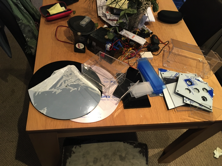

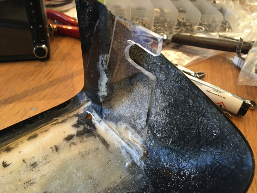

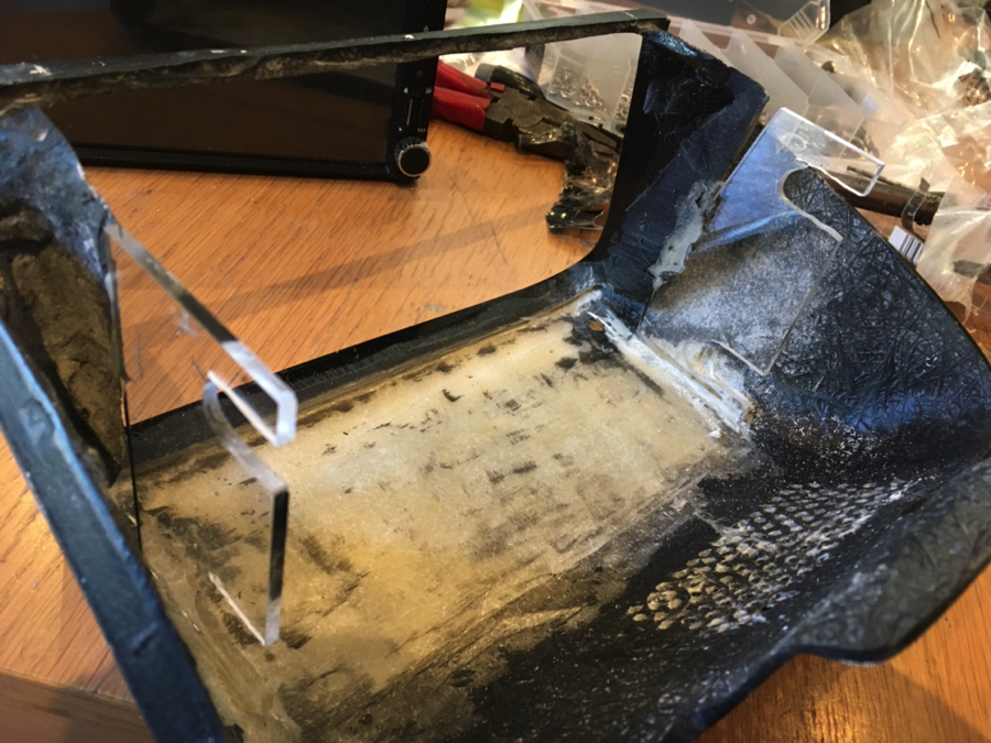

As I cut out the insert base and most of the sides I needed to make something to fix the head unit to, I popped over to a local perspex supplier local to me, I asked if they had any small bits of off cuts I could buy, they pointed me to their skip and said I could take all I wanted (for free)

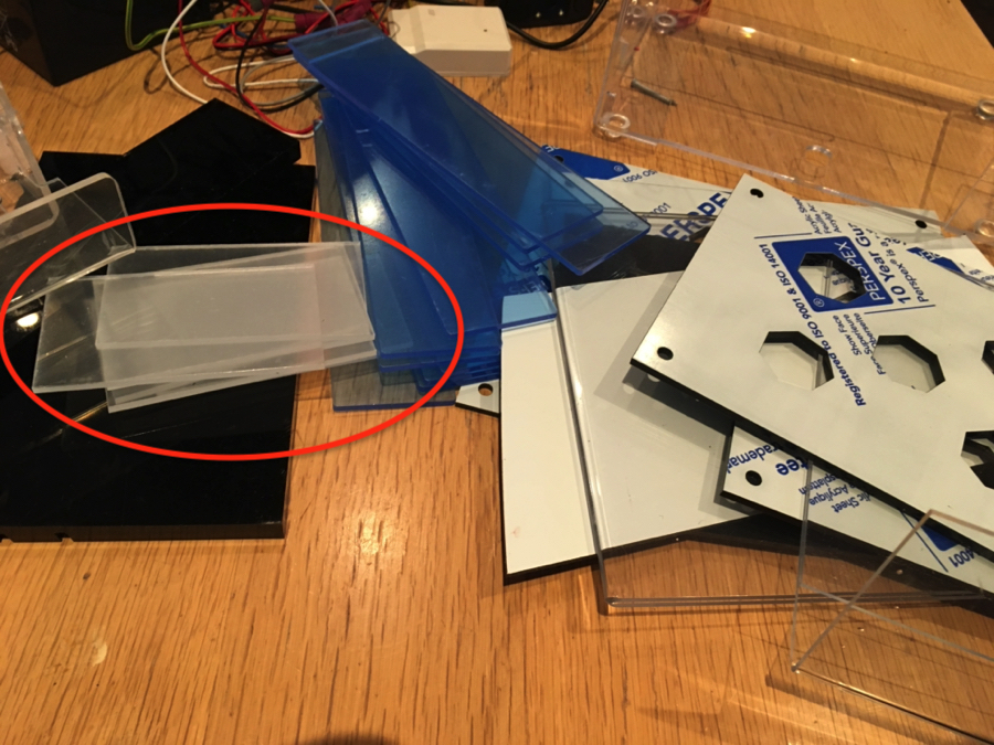

I  took a few bits I though might come in useful
I ended up deciding to make use of these bits here in the red circle

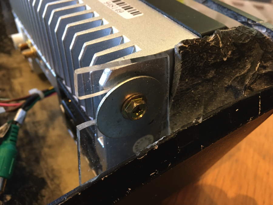

While I was waiting for the JB-WELD to arrive I was testing the perspex slithers using my hot glue gun after gluing the slithered to the nav-pod I left it over night, to my amazement the hold was very strong that when the JB-WELD did arrive I didn't use it and stuck with the hot glue

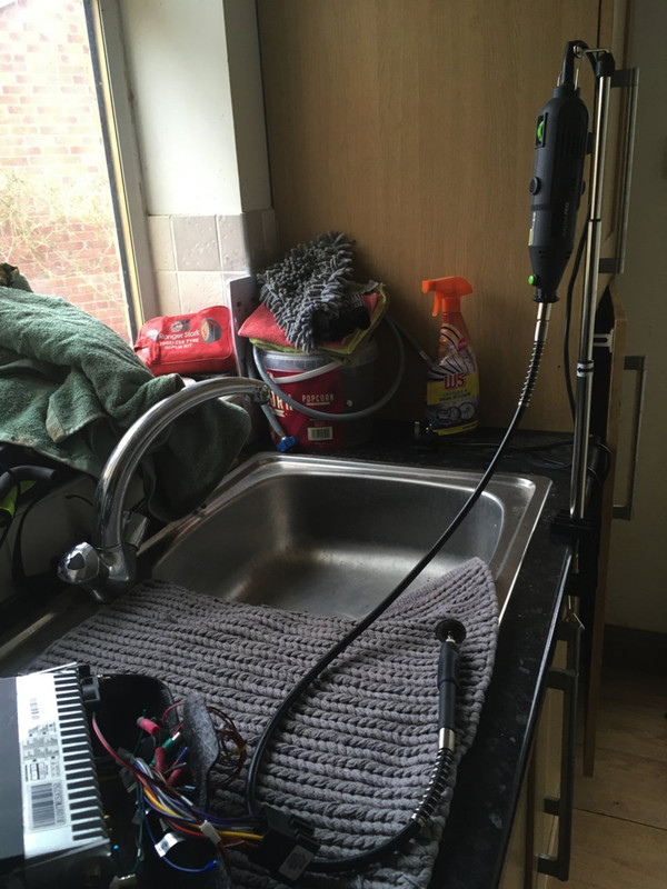

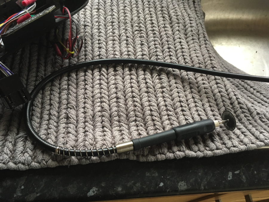

I use my Dremel to cut two slits on each perspex for the bolts holding the head unit, I had a couple of tries at this, I finally settled on cutting the slits before the perspex  was glued to the nav-pod for a better finish, I have a very understanding wife, I fixed my Dremel in our utility room to do the cutting, not a murmur  from her

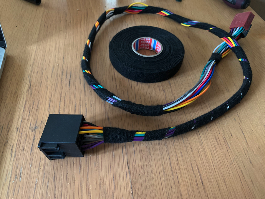

My Tesa 19mm 25m roll arrived the other day so wrapped the extended power leads

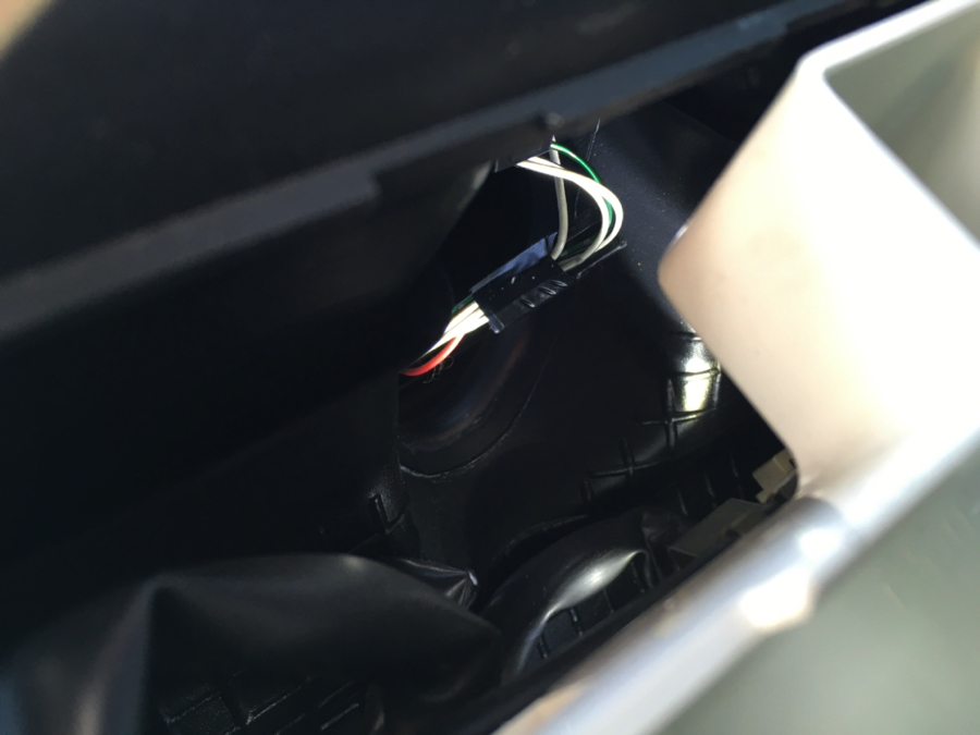

I discovered that I can thread my power leads, reversing camera & reversing buzzer  leads and DVR leads all from under the cubby, as there is a indent on the underside that will allow me to thread the wires through once I've cut a hole centre of the cubby,  I'm not sure how visible this is in the image but hope it's clear what I'm saying
The white wires are the extended power leads from the ISO connections centre consul below the heater switches
These are the wires in the loom from the ISO connections to the bottom of the cubby
Looking at the cubby the hole for the cables needs to be well back as the unit itself is a good 65mm deep,
So I've decided to cur the hole  approximately where the  tape is

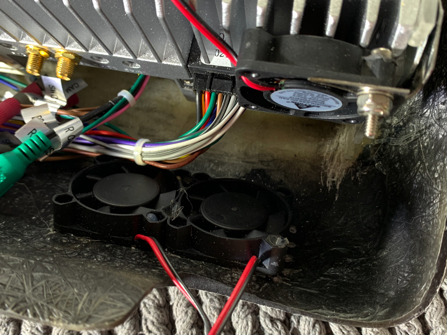

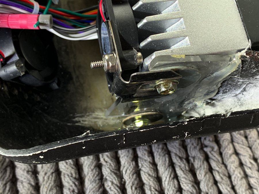

In the meantime I've also fitted the extractor fans, on e where the unit gets very hot
And two glued to the air vent on the nav-pod

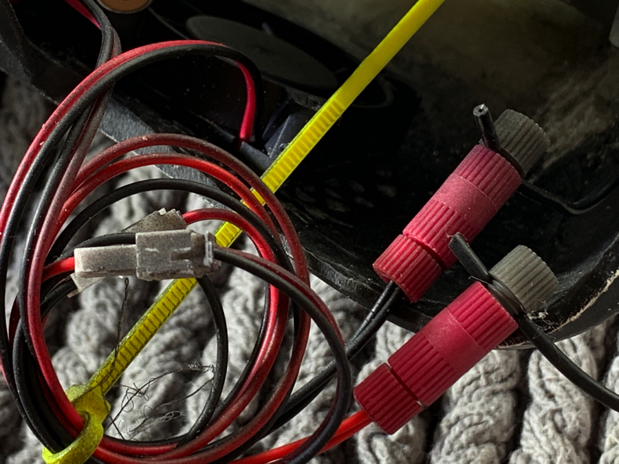

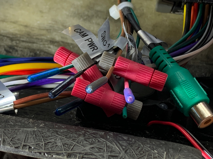

I'll be making two connections to the head unit, one is for the fans, the other is for the SWC ~(steering wheel control) for this I'm using these Posi-Tap connectors these  are a lot more expensive that the usual spade connectors but in my opinion these are far better in this build
For the SWC
For the fans

Quote from: Mollydog on February  6, 2022, 16:06One thing I've discovered straight away, one corner of the unit after only half an hour gets a bit too hot to touch, maybe there isn't sufficient heat sinks for the PX5 with an 8 core

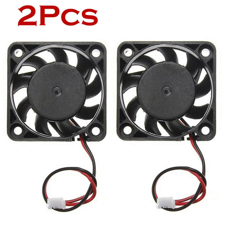

I've placed an order for 2 small 40mm x 40mm computer fans
For the SWC
For the fans

@Mollydog do the fans pull air into the NavPod or push it out the vent holes? I'd be inclined to push it out as the air out there will be hit under the windscreen but from below the dash should be cooler. And make the cable hope large enough to allow airflow through also. Something that concerned me with the NavPod ventilation for a head unit.
Sent from my M2102J20SG using Tapatalk
Tyler
RIPieces: Sable \'05 Roadster \'Red\' edition.
Project: MR-S import (JDM) now my toy and mule for:
SC build OR a 2AR-FXE swap (ref: Frankenstein Motorworks) OR Electric conversion
AND rebody with a fibreglass replica of Porsche 550 Spyder.
Quote from: MrT on April  2, 2022, 18:45@Mollydog do the fans pull air into the NavPod or push it out the vent holes? I'd be inclined to push it out as the air out there will be hit under the windscreen but from below the dash should be cooler. And make the cable hope large enough to allow airflow through also. Something that concerned me with the NavPod ventilation for a head unit.
Hot transfers to cold.
both pulling, on the head unit its set up to pull air from it to the vent and the two on the vent set to pull the air from the nav pod out through the vent
fawtytoo
#39
On the subject of cooling fans, the directions should be both. The fan on the heatsink should blow air ONTO it, and then another to blow the air out of the casing.
If you have a computer tower, that's how the fans work. One fan blowing air onto or across the CPU heatsink, and a case fan to extract the hot air.
EDIT: For your dash pod, you need a vent to allow fresh/cool air to get in too. But that doesn't necessarily need a fan.

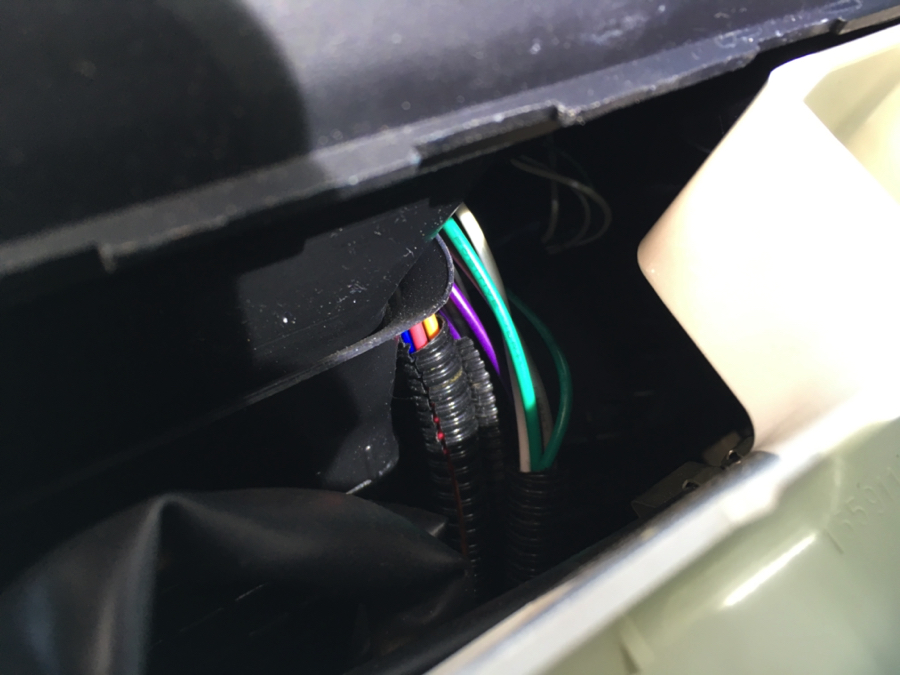

Busy  weekend this past weekend,
Made a start threading the wires through to the dash on to the Nav-pod, as mentioned before, nothing is easy on the MR2I ended up having to take out the passenger airbag to get to the bottom of the Nav-pod,
The air bag wasn't impeding me but taking it our made it easier to see where I was threading the wires through
As I needed to thread through a few wires, going to the nav-pod were: main head unit cables, aerial cable, USB cable, reversing cable
Coming from the nav-pod was the reversing alarm buzzer, I still haver to thread through the DVR cable but I'm leaving this till I get the roof latch bolts sorted this coming Wednesday, as the USB cable coming from the the DVR is one long one meaning I would have to be leaving the DVR sliding around
I've taken some images (I hope I get them in the right order) showing my progress
Through the glove box
Cables coming through this side of the centre to the Nav-pod

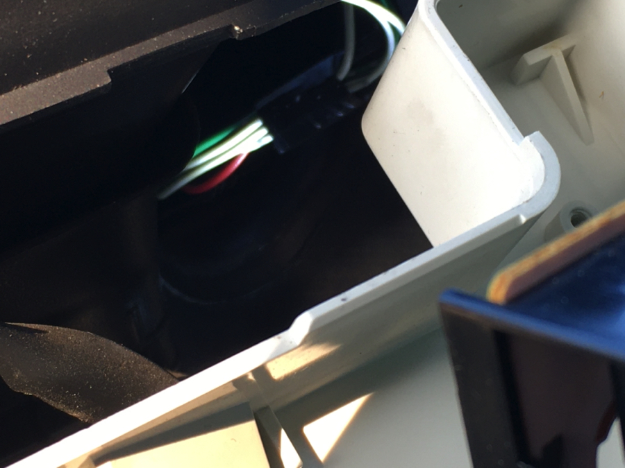

I worked out I wanted the hole in the Nav-pod approx 95mm back from the front of the head unit
 started off with a hole saw and ended up with a door drill
I popped an inspection camera down the hole, very tight whichever way I went with the cabling
To make my life easier I  took out the air bag, not as hard as I first thought, out in around 10 minutes and most of that time I was looking for the second nut to the left as you look at the dash
For sure not much room to pass anything through the gaps
First think I passed through was the buzzer cable from the nav-pod to the glovebox location, using a stiff wire to pull/push through the wire
Following this I started off with the head un it c ables and attached other wiring that needed threading through at the same time, I didn't want to be threading each wire individually, I'd be there all week doing it
just the head unit wires
Adding g the aerial wire
Adding the revers camera wiring
Finally the USB wiring
Stiff wire threaded to the hole and now just seeing if all these wires will thread through to the hole
Miracles of miracles I managed to thread the wires through
As mentioned I still need to thread through the DVR cable which I'll attempt after visiting the garage on Wednesday

I've noticed I never posted the finished job so today I took some images and a video clip of the head unit  fitted to the pod
Overall I'm happy the pod does what its supposed to do, hold the head unit above/on the dash firmly, quality and fitting is well, put mildly below par, I'm sure if I had the skills I maybe could of made a better job of a few things but overall  the pod is something that is better than nothing and from a distant or outside the car it looks OEM
A lot of work needed doing to get a head unit to fit, I can't now remember where I got the link from but I managed to get hold of a STL file of a scanned nav pod but once I discovered we were talking of a few hundred pounds (3 to 4 hundred) to get one made I stopped that line of thought, reason being if mine is a carbon copy of the original then unless the original is modified a 2 DIN head unit will be hard to fit
Back to my pod, here are a few images
If I get the front part of the pod resting in place then the rear looks like this, yes a good 30 to 40mm gap
If I push it back to close the gap
Then the front lifts up around 5 to 8mm
I suppose if I had another go with one I could manage to reduce this gap between the front of the head un it and the pod
I don't have any regrets buying this nav pod as it does what I need it to do "keep the head unit on the dash"  as such I can put up with the final Finnish of the product
