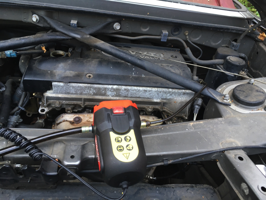

I killed to birds with one stone this afternoon, as for a change it wasn't raining I made a start on the oil change

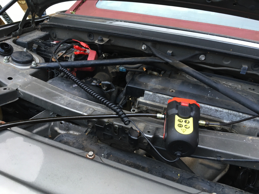

I have one of these car oil pumps to get out the oil so first thing was to get out as much oil with the pump before taking off the nappy and oil filter
Straight in to a large used oil container
https://youtu.be/7XZEwn7uwbo

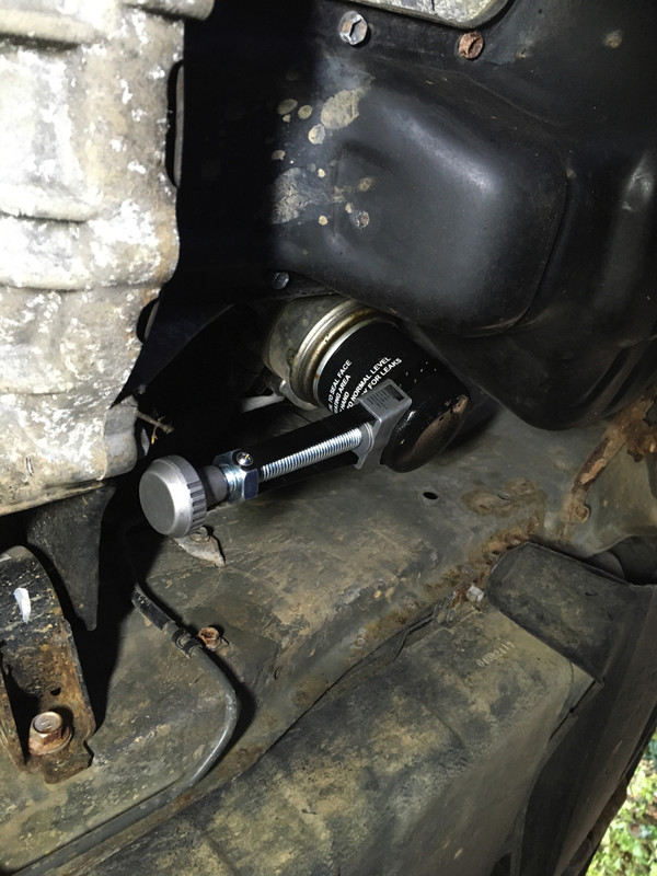

Once the oil stopped coming out, I took the nappies off and took off the drain plug, no oil coming out and after a couple of minutes seeing there was no oil drips I refitted the drain plug and took off the old oil filter with a thing  made to get the filter off I bought from Aldi (£2.99)

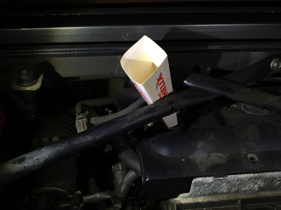

Somewhere in the shed I have a flexie funnel but was getting dark by now so used this paper funnel I was given from Mr T, when I first bought the car they included a free service and with that service they handed me a litre of oil in a bag that also included these paper funnels, we kept in the car, came in handy this afternoon
After replacing the filter and checked the drain plug was on, I filled the engine with as near as dam it 3.5Lt - 3.7Lt of oil
After doing this I fitted the 02 sensor (info on another thread) then took the car out on our ring road a couple of times all seemed well, I'll check the dip stick in the morning it's too dark now
