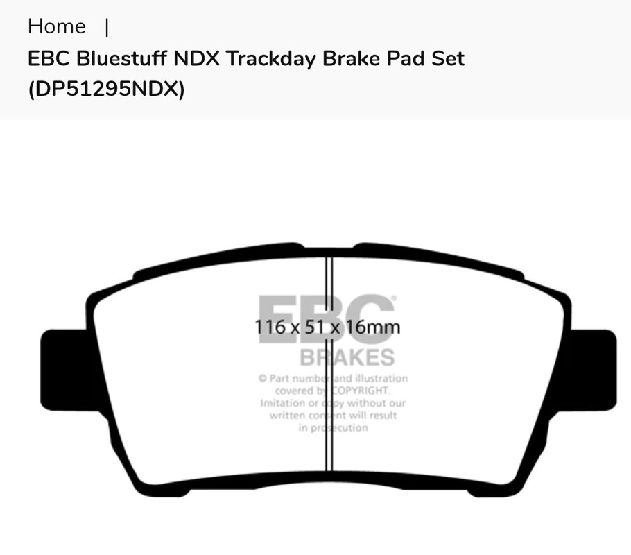

Quote from: JB21 on June 22, 2023, 17:21I can only find EBC greenstuff. Funny as the dimensions are similar to the MR2 front pad but they look slightly different in shape.
Prius pad:
MR2 pad:
@thetyrant could you make pads for the Prius backing plate?
Red Stuff DP31459C is dedicated for Prius and MR2 ZZW30.
MR2 prefacelift  and facelift model has different break pads number 04465-17100 vs 04465-17140, but  probably  there is no difference.
https://rcagarage.com/shop/brakes-rotors-pads/brake-pads-performance/ebc-03-07-scion-xa-1-5-redstuff-front-brake-pads-dp31459c/
