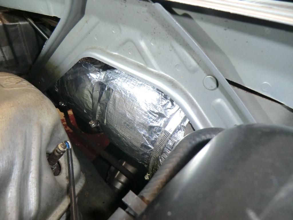

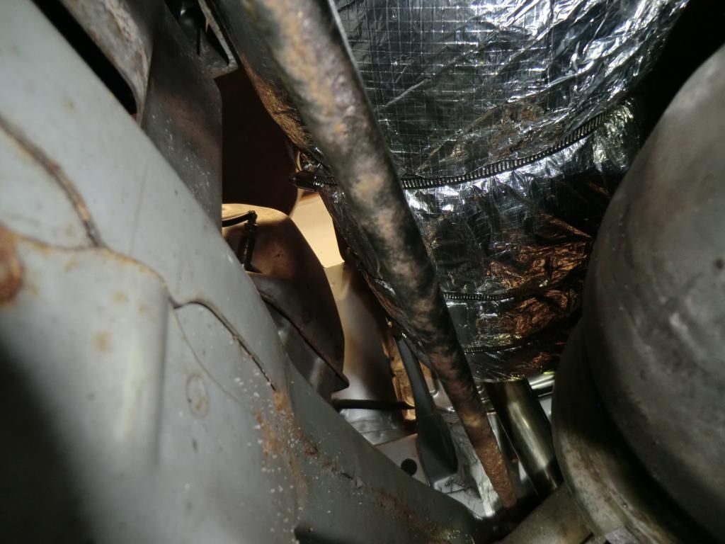

Managed to scrounge some jubilee clip so I have permanantly installed the noise mitigation insulation, I managed to cover right round the full body of the Proflow silencer see photos of job and few extra ones of my MR2 and toyota collection Hilux and a Yaris (not in pictures). I am out for a test drive this afternoon so I will report back tonight.

Right the verdict.
The sporty tone is still there with a little burble barble on the over run.
70 mph cruising I would say is only slightly louder than stock, but the booming resonating sharp annoying tone has gone.
On a private test track 80mph is still ok, above 80mph to 85mph the noise level rises but mainly from the tail pipes and obviously you ears are less than 2 metres from the source of noise.
After a 30 mile 70 mph run you can still touch the silencer lagging, still a lot of heat from the manifold/pre cat housing (original heat sheild fitted) but I guess thats normal.
Anyway most definately a worthwhile exercise, I will see how the sound proofing pads work next weekend on the rear bonnet lid. No complaints from the wife so it can't be too bad and she has hearing like a spy satellite. I will keep you all posted.
