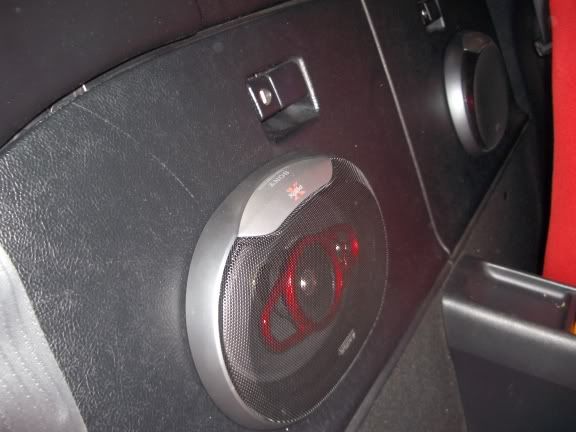

I have finally fitted some 6x9 in the stotrage doors and new stereo. Finall i have some good sounds.   s:D :D s:D    s:D :D s:D

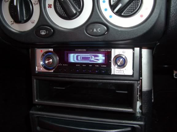

The only trouble is that the spare pocket under the stereo doesnt look good from the side, so if anyone knows where to get proper pocket please let me know
And the other thing, since i had this stereo everytime i put the key in the egnition my stereo start playing right away and my aerial comes out, even if i listen to the CD and it wont go away. Whay is that?

Would it cover the sides? As you can see from my pics you can see the silver brackets and it looks a bit messy
Have a look at the website I mentioned. On the right hand side there is a picture of my MR2 with the fascia installed. Click on it for a better view. Looks lovely. No gaps or metal....   s:) :) s:)

Quote from: "sexybrunette"The only trouble is that the spare pocket under the stereo doesnt look good from the side, so if anyone knows where to get proper pocket please let me know
Try re-fitting the surround trim from your original stereo - this should cover the gap at the sides.  It's the large, square, 'ring'[1] that clips under the heater controls.

I have tried, that didnt work, it did cover the side sides but there was a gap either side of the stereo

The aerial will automatically come up if you have the following options on the stereo
Traffic Alerts etc.
On the Sony - you could turn this off, which then meant that if you were listening to a CD - and you had the traffic alerts off, then the aerial would remain down.  If you have it on, then the aerial stays up so that it can then give you any Traffic Alerts that are broadcasted.

All of the adapter kits I have seen end up with a tiny half-sized pocket that I can't get my fat fingers into when I need to retreive some article.
What I believe you need are spacers that snap onto each side of the CD-radio/pocket assembly to fill the bit of gap between it and the original trim ring.  Fortunately Mr T has such a product.
I am not sure if these parts are available in the UK or not, but the part numbers on the spacers are: 86221-52060 and 86221-52050.  Toyota lists these as belonging to a 2000 Celica and you can order just these spacers instead of the entire audio kit.
If you can not source these in the UK, a potential solution (what I did until I found these), is to pick up a scrap bit of black sponge/foam (got mine from a plumbing supply company) and cut it into strips the height of the rectangular trim pice - stuffed the foam in - and while it did not match the interior (ghetto would be the US term) it did allow the full pocket while hiding the ugly side bits.

Apologies for the slow reply, I just re-read this thread in the light of lbridges comment:
Quote from: "lbridges"What I believe you need are spacers that snap onto each side of the CD-radio/pocket assembly to fill the bit of gap
which made me go back and have another look at your pictures (properly this time  s:roll: :roll: s:roll: )
It does look like the bits you need are the side spacers.  See my post here for the part numbers that I got from Mr. T when I swapped my head unit.
