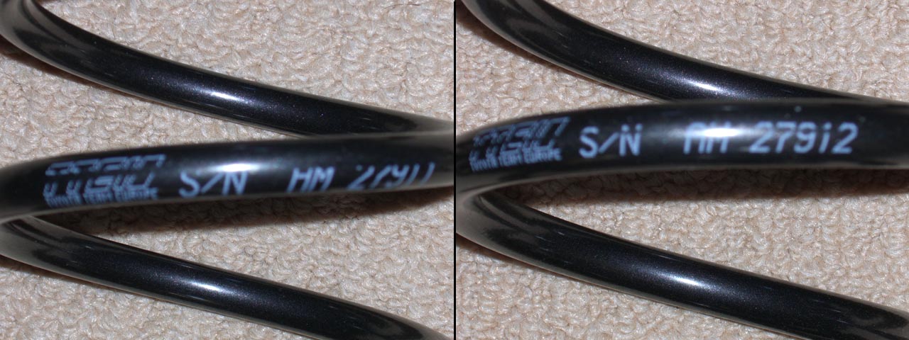

The springs were ordered from Inchcape Sandhurst and the part numbers are AM27911 (front) and AM27912 (rear):

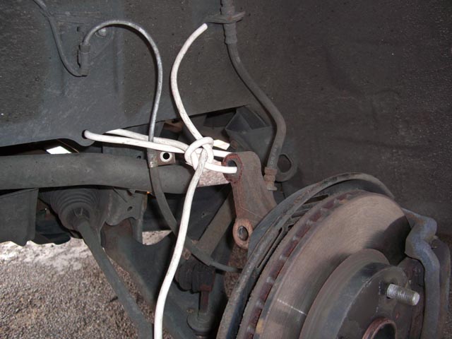

First I loosened up the bolts that hold the brake disk and completely unscrewed the ABS sensor lead and break fluid pipe from the suspension...:

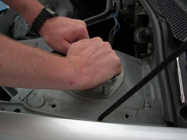

...while Kris of Belgium unscrewed the two of the three bolts that hold the shock in place:
While I finally had the shock free from all bolts, Kris of Belgium carefully unscrewed the last bolt.  The shock just fell in my hand.  Without the suspension to hold the disk in place, it will be hanging off the ABS lead and brake fluid pipe; it's not such a good idea and Kris of Belgium decided to tie it up while I was working on the shock:

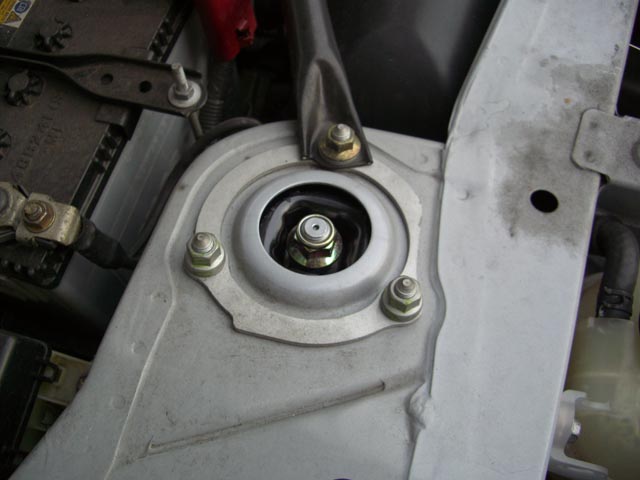

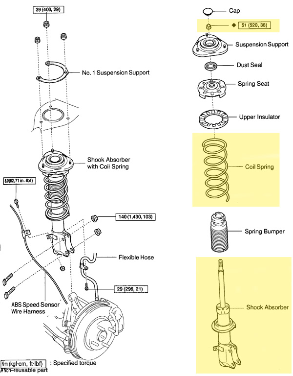

To remove the existing spring, I tightened the spring with a spring compressor and just unscrewed the centre bolt at the top (in the centre of the strut mount).

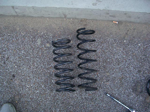

This is the stock spring in comparison with the TTE.  Uncompressed the TTE is more that 30mm shorter but it's a lot stiffer:

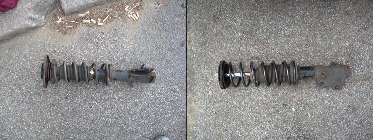

To install the TTE spring, I compressed it with a spring compressor and replaced the old one.  Compressing the spring allowed me to put the strut mount back in place easily.  One thing I noticed was that the strut mount is keyed; this made it easy to tighten in place.  The shock absorber before and after:
To fit the completed item, I followed the removal process in reverse.

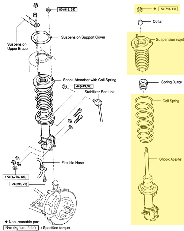

Front strut schematic and torque figures:

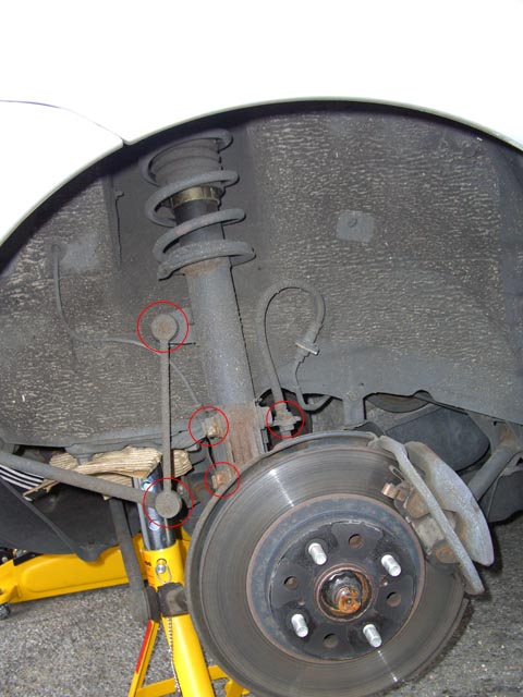

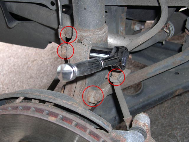

The process is almost identical to the front but there is the extra complexity of the stabiliser mounts.
I unscrewed all the bolts (circled) except the stabiliser mounts which were a real pain in the derriere; I first tried the top one but failed miserably as it was too tight and access was very restricted.  I then decided to unscrew the lower one:

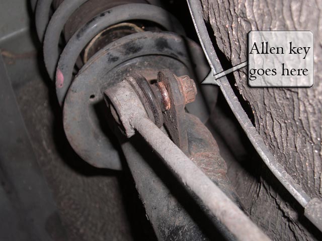

It's worth mentioning that these are not normal bolts; there is a hole where the bolt is screwed and an allen key is needed to hold the internal part in place while loosening up the actual bolt (otherwise it will keep rotating to judgement day):

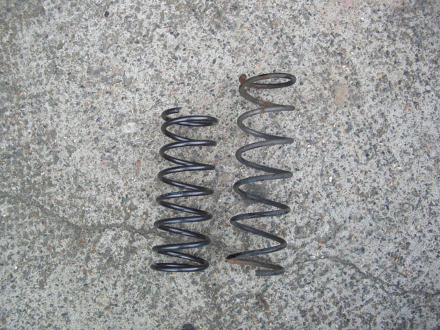

The difference between the rear springs is not as great as the front:

Rear strut schematic and torque figures:

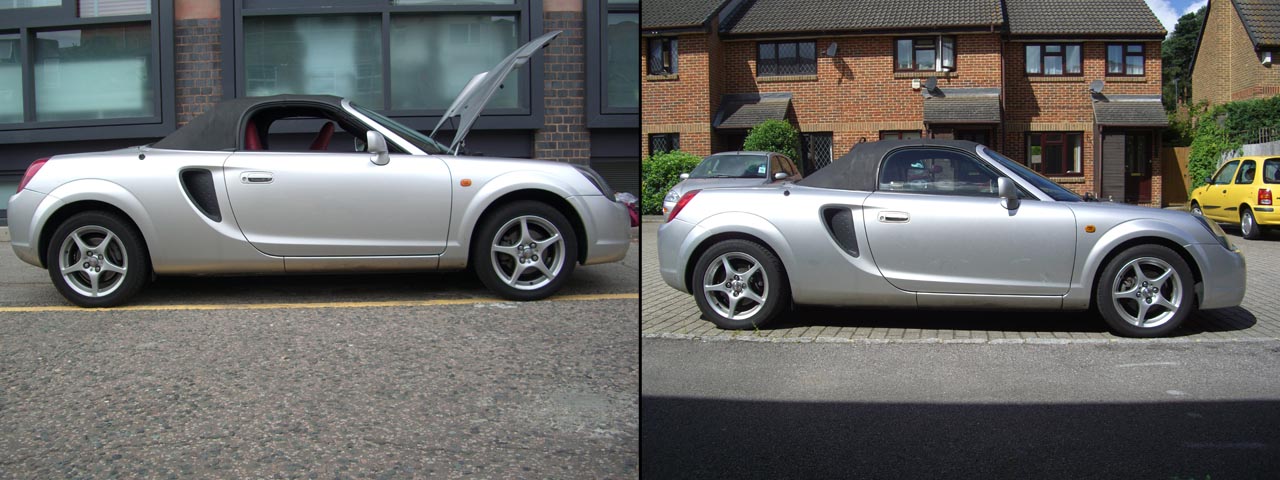

Result:
The difference is instantly obvious but I expect a drop of a further ~5mm within a year:

May be you can had torque specs to complete your write up.  s8) 8) s8)
Quote from: "kaidiss"May be you can had torque specs to complete your write up.  s8) 8) s8)
Funny you should say that... I don't have torque wrench and I was genuinely tempted to buy one just to include torque figures but I couldn't really justify it.  I'd be happy to modify the post if someone can confirm the torque values.
roger
Quote from: "Emmanuel"I'd be happy to modify the post if someone can confirm the torque values.
51 nm for the front, 73 nm for the rear
39nm for front "horseshoe" bolts, 80 nm for rear.
Guess a torque wrench is a necessity!
<edit> thats a standard set up, presumably TTE (or whoever) would give different values in their instructions if it was necessary. </edit>
