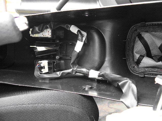

4. Pull the console up from the back, and tip it towards the front then once it is clear of the handbrake and gear lever, tip it slightly to one side, being careful not to damage or stress the wiring.
5. Clip the wiring. A connector to each of the window switches, and 2 clips holding the wires to the underside of the console. All 4 are held in by little clips which you might be able to press with your fingers, or if not a small flat screwdriver should do the trick.
6. With this done you can now take the whole console away from the car.

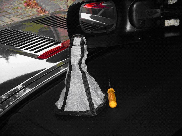

3. Turn the old gaiter inside out, and you will see how the silver "ring" at the top is kept in position by a metal circular clip. The clip sits in a recessed groove on the ring body. Remember this for refitting, and undo it.

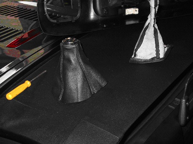

Fitting the new gaiter takes a bit of trial and error:
If you have a Rhonda gaiter she has given you a little extra material, so you can have it looking floppy (within the confines of the leather) or taut.
1. Turn the new gaiter inside out, and push the silver ring body narrow end first towards the narrow end of the gaiter. Replace the metal clip (or use a rubber band until you have the positioning just right), so that it resembles the original in the photo above.

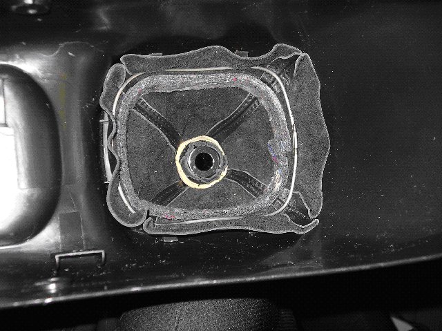

Consider if you want to replace the felt?
I have. There maybe some sticky left on it, but a contact adhesive will ensure it stays in place. You may have to cut a small piece of it since the inside edge of the new gaiter is slightly shorter than the old because of the stitching and fold back on the 4 corners. The picture below shows the overlap before I cut it, and also shows the temporary fix elastic band.

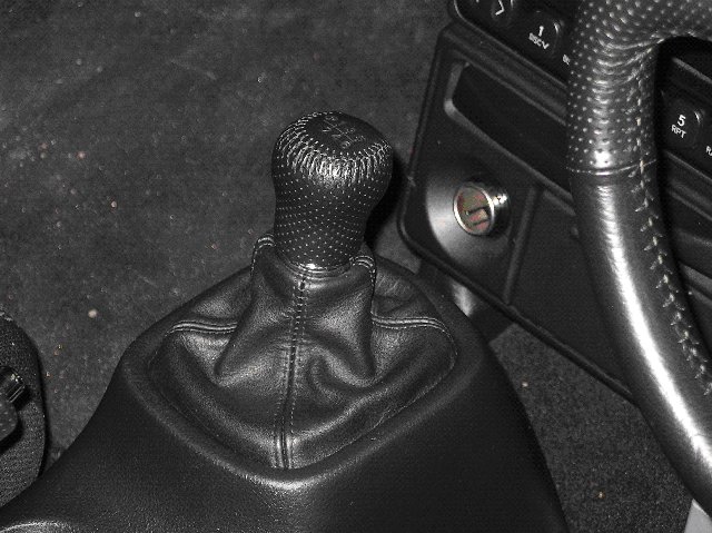

Finally refit the console to the car:
Remember to put the wiring sockets and clips back in. Replace the fixing screws, screw on the gear lever knob, and there you go, a nice new gaiter.
