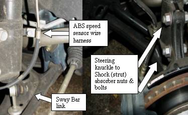

Now that I had reference shots I proceed to dismantle things. First I disconnected the sway bar form the upper portion of the link. It looked like it would get in the way so I started here first.

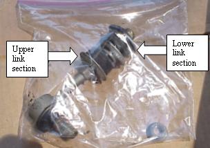

Then I removed the link from the lower suspension arm, and placed the entire assembly in a zip lock baggie. Please note that there is NO washer for the link where it mounts to the upper side of the lower suspension arm. The bottom side however does have washers. BTW I removed the links from both sides at this time.

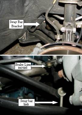

I then removed anything else that looked like it would get in the way. First was the ABS speed sensor wire harness.
Then the Brake line Mount.

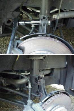

Now came the fun part, removing the steering knuckle from the strut.
I did not want to create any unnecessary stress on the brake line, and the ABS speed sensor, so I supported the calipers using my jack. This worked, but I just did not feel like it was as stable, as I would have liked for it to be. So I switched over to the jack case which was just the right height. (Sorry no picture of that).
I then proceed to what I found to be the most difficult part. Removing the front sway bar. First I removed the brackets on both sides (easy).

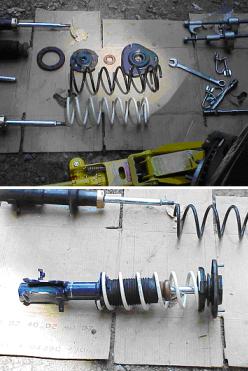

Now it was time to use those spring compressors. I placed one compressor on each side of the spring. Next I tightened them down by hand until I could not turn them any more. Then I installed and tightened the safety locks. Once I felt that every thing was secure I began to slowly remove the strut center nut.
Even with the spring compressors in place, when the nut came off there was still some tension, just enough to send everything flying a few inches. DO NOT LOSE ANY OF THE PARTS. YOU WILL NEED TO RE-USE EVERY THING EXCEPT FOR THE CENTER NUT! New center nuts are provided for all four struts/shocks. Here is a picture of everything disassembled in the correct order.

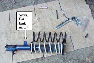

Next I removed the compressors VERY slowly a few turns on one side a few on the other. I have heard horror stories about injuries so I was being EXTRA careful. Then I put the new spring onto the new strut. You should be able to read all of the TRD labels from left to right bottom to top once you are done. The strut has a TRD sticker on it and the springs a TRD label on them. They should not be upside down. A cool side note, if you look at all f the writing on the struts you will notice one of the few parts in English shows KYB.
Do they make the struts for TRD? ? Here is a picture of the completed assembly, along with some comparison shots. I found that I did not need the spring compressors to accomplish the reassemble. My weight pushing down was suffecent. Also note that the center bar of the strut, mounts to a KEYED mounting hole in the dust cover/mountng bracket. Be sure this is aligned correctly.

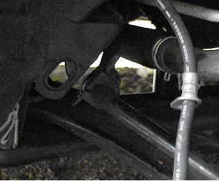

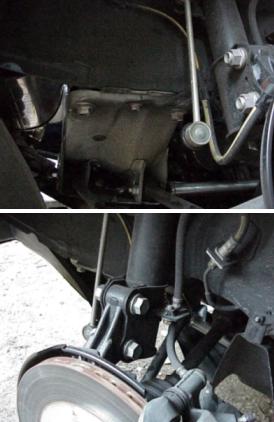

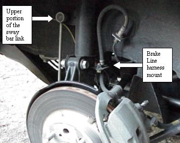

I then inspected everything to see what would get in the way. I went straight for the sway bar. I disconnected the sway bar from the lower portion of the link, leaving the upper portion of the link attached to the strut. I then removed the Sway Bar Brackets, and Bushings. I did this on both the passenger side and the driver side of the car. Once everything was disconnected, I removed the sway bar from the car. This was nowhere near as difficult as the front.
Next I moved onto the Brake Line mount. Just like before I wanted to get everything out of the way that looked like it would get in the way. The following series of photos will show what I did up to this point, along with providing some reference.
Please not that the above photo was taken after the sway bar was removed.

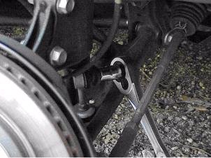

Now that everything was out of the way, it was time to remove the nuts from the Strut connecting it to the axle carrier. These are in at 128ft/lbs. I do not have a breaker bar, so it was one foot up in the wheel well resting against the frame, and the other on the opposite side, a few grunts and off they came. Once again I used my trusty jack case to hold up the calipers, and discs.
