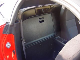

There are two drains, one on each side. They are located deep down inside the soft top folding mechanism. To find them, reach into the space between one side of the top and the package shelf (the part that is held up by the black strings). The drains are toward the front of this cavity. When water enters from the outside, through the gap in the weather stripping closest to the door, it flows down the inside of the soft top, and into the drain.
Start inside the car. Move the seat all the way forward on its tracks, and also flip the back part forward.
Get yourself a flashlight, and look down into the cavity described above. The drain has a grille on it, kind of like the drain in a bathtub.
Clear out any visible debris in the cavity, and in the drain itself. If you need to remove the drain grille, you can do it by pulling with a pair of pliers (it could probably break if you pull too hard, so be careful.)
Repeat this for the other side of the car.
