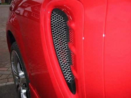

Meshing
First of all I cut out the black plastic mesh effect bits being careful not to leave any indentations or raised areas. The mesh is applied from the rear so that it will look nice and neat from the outside.
I cut the mesh approx 1/2" bigger than the hole (scissors) and snipped it around the edges (1/2") to enable me to bend it over all around the piece. Once I was happy that it was all ready, inc a slight bend to fit the curve of the vent, I taped it in place with two bits of masking tape.
Fixing it in place I bonded it on with 'Tigerseal'. (you can use 'no nails' if you don't have tigerseal or U-Pol seam sealant) these are mastic type sealants that dry hard but still remain semi flexible.
Try to keep the whole thing as neat and compact as you can as when you come to refit the vent you are restricted with space. whilst you've got the vent off, pop outside to your car and have another look at where it is going to have to sit to give yourself an idea of the requirements.
Once dry (next day) it was just a case of putting them back in remembering to put the clips back on the vent ready for the next stage. The easiest way is to slide the rear edge in first and then push the front edge in so that the clips 'snap' into place. You will also need to ensure that the top and bottom flaps go inside the wing. If they don't at first you can lift out the vent with your fingers and push the flaps in with a flat bladed screw driver.
Job done!
