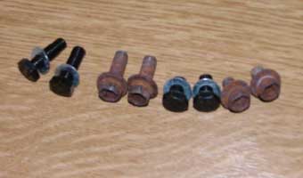

While leaving this to totally dry for a day I decided to sort out the problem of those rusty bolts. Remember them?
Obviously these would spoil the end result, so off once more to Halfords I went (I should own shares in them) taking the old bolts with me.
The bolts are standard 8mm however they are 2 different lengths. In the end I bought a box of assorted black powder coated bolts, and a small pack of stainless 8mm washers, total cost of just over £5. Now you see why I should have shares in Halfords.
The two longer bolts were easy as the pack contained an exact match. The shorter ones required a little dexterity with the Dremel.
Here's the end result.
