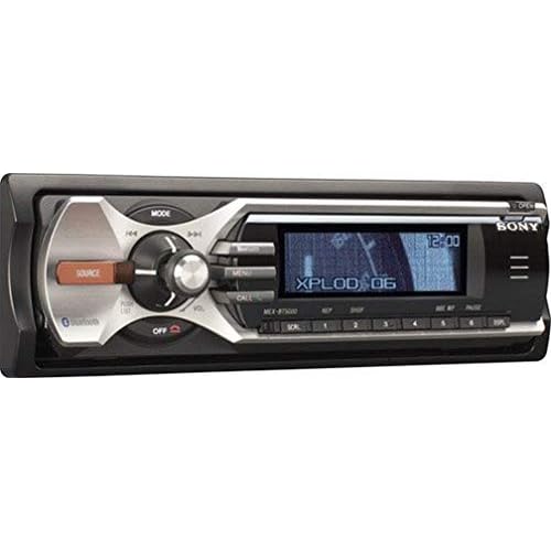

Well, I got my bits and pieces ready, tools handy, pot of tea brewing, and various printouts from the internet on how to remove the stock HU... and everything was going fine, until I came to the last 4 screws holding the HU to the car... JEEEEEEZ they're on tight, I can't shift em....
I think I nedd to get a thinner shafted screw driver, for a firmer purchase on the screws, cos if I'm not care full I'll end up rounding the bu99ers off.....
Oh, & FYI this is the HU that'll be replacing the '03 stock thingy-ma-bob:
Sony MEX BT5000  s:twisted: :twisted: s:twisted:
Should be a darn sight better than having one of those STOOOPID bluetooth things hanging off ones ear!
Also there's an option for an Ipod interface, but I had one on a old Kenwood Unit, and frankly it was pants! Does anyone have anyexperience of the Sony one? & before anyone says it I know it's not gonna be anything like as good as the full speed Alpine thing - but I CAN stream MP3's from my phone [Sony K800i] via bluetooth, which is novel and I can't wait to give that a bash!
Watch this space for a review (if anyone's intrested) once I can shift those 8loody screws!!!  s:roll: :roll: s:roll:
