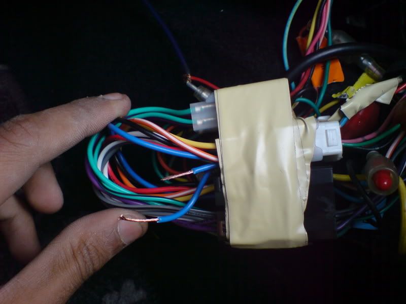

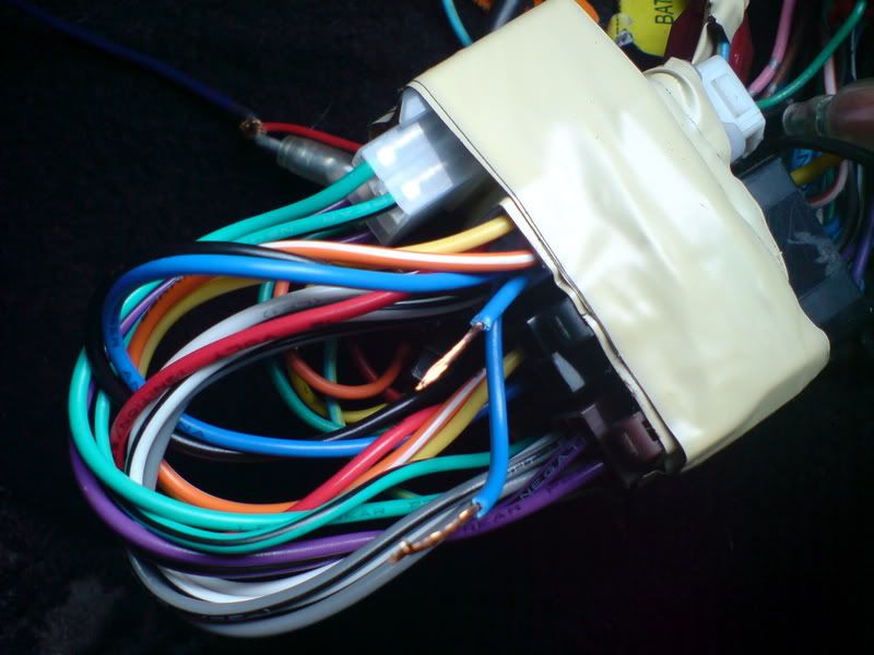

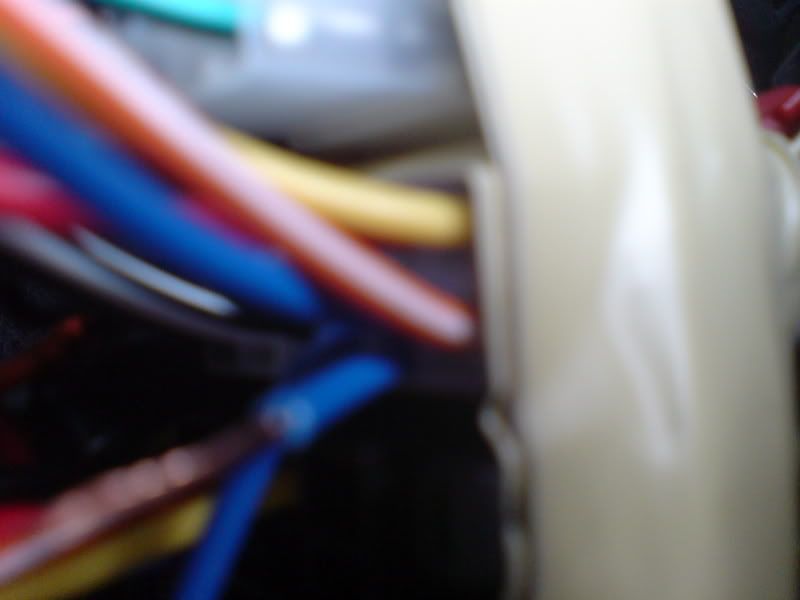

there is alot of confusion on this topic therefore i have taken some pictures that are long awaited  s:) :) s:)  my contribution for letting me join this great forum i guess lol, il post them up later on. its time to cruise with no ariel now

sticky timeee! noticed nobody had ever posted pics of the wire to cut so the blue one is the ONE! hope its clear to see which one has been cut.
