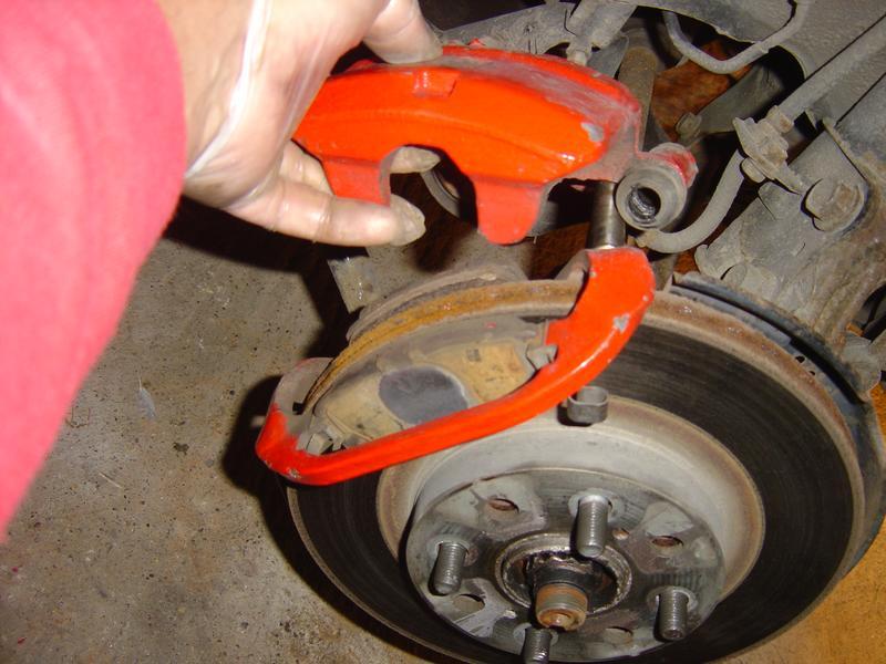

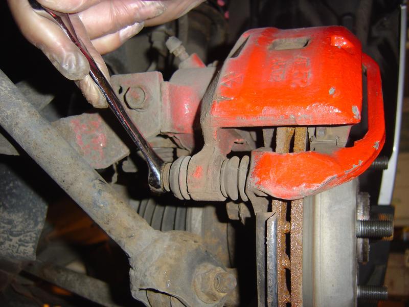

REMOVE SLIDER BOLT (12mm RING SPANNER)

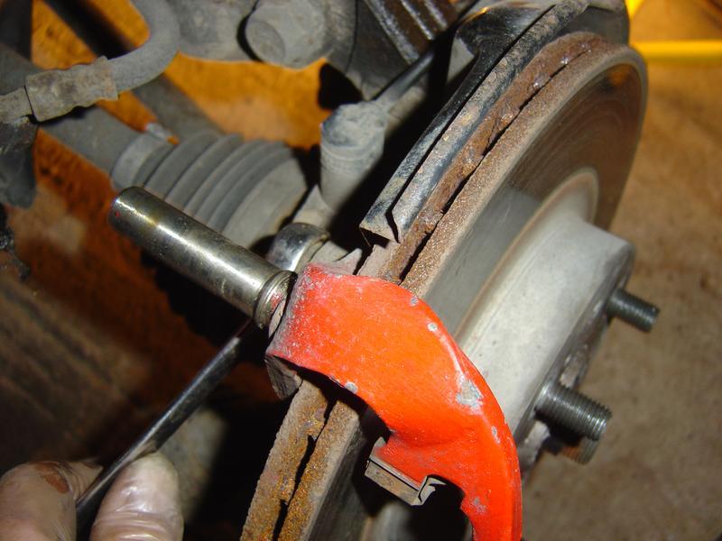

ONCE BOLT IS REMOVED

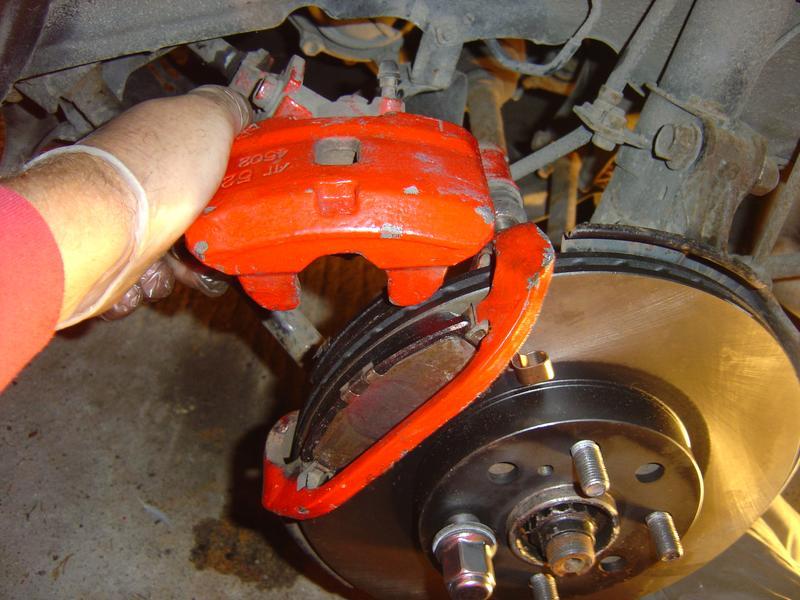

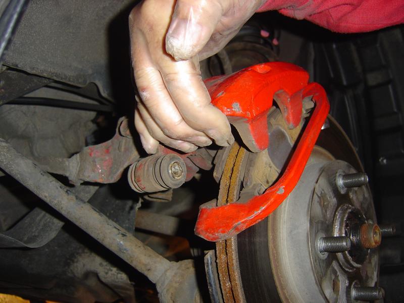

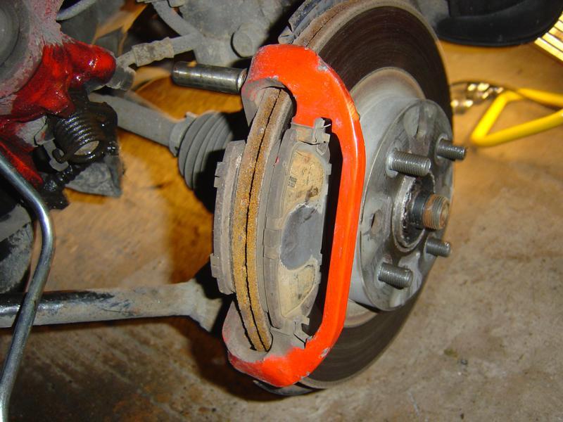

PIVOT UP THE PISTON ASSEMBLY AND SLIDE OFF TOP PIN (This can be a little awkward but it is doable)

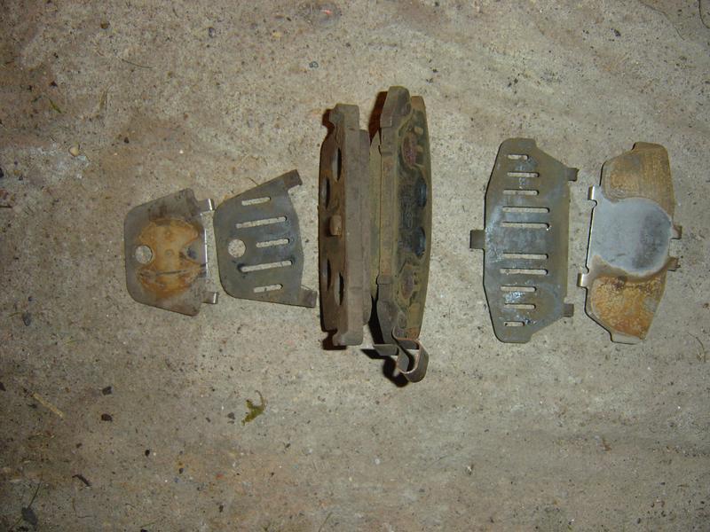

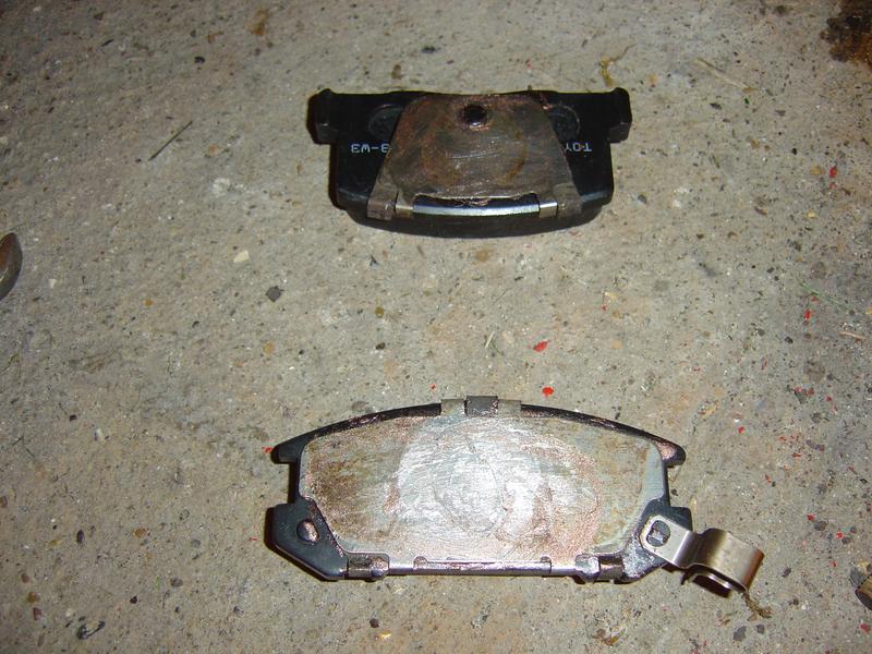

YOU CAN NOW REMOVE THE PADS WITH ANTI SQUEAL SHIMS

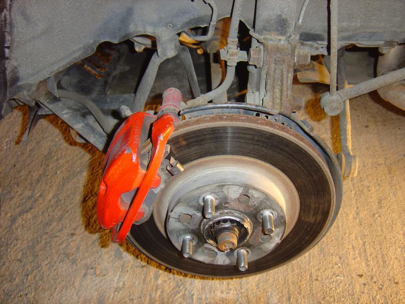

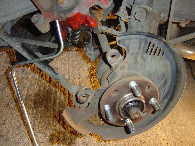

REMOVE TOP & BOTTOM CALIPER SUPPORT BOLTS (17mm RING SPANNER)
THE OLD DISC CAN NOW BE REMOVED 9There are two drawing holes if needed)

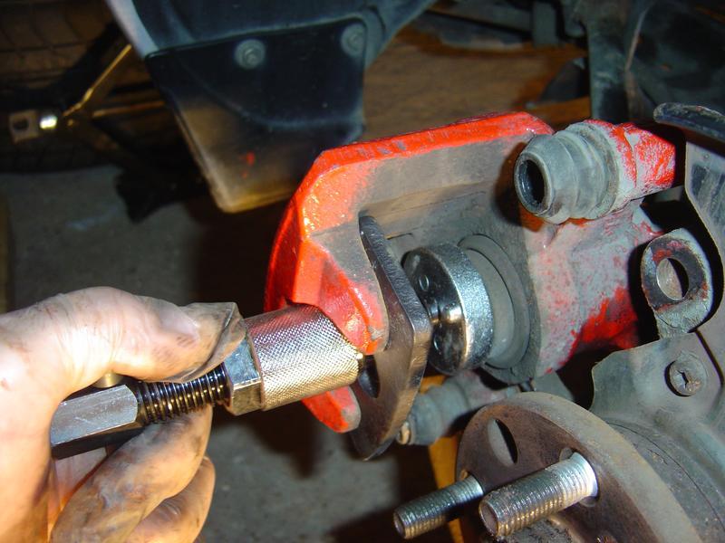

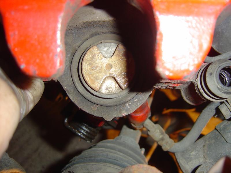

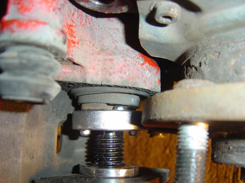

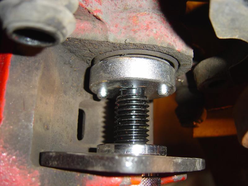

I USED A "WIND BACK" TOOL PURCHASED FROM HALFORDS FOR £19
THIS WAS MORE THAN ADEQUATE FOR THE JOB
WHEN DOING THIS REMOVE THE BRAKE RESERVOIR CAP AND DRAIN OFF THE EXCESS FLUID (As shown in the front brake replacement)
AFTER WINDING BACK THE PISTONS

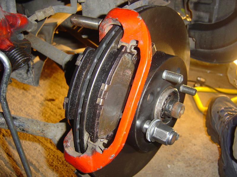

ROTATE THE SLOTS AS IN PICTURE TO ACCOMMODATE DOWEL IN BRAKE PAD

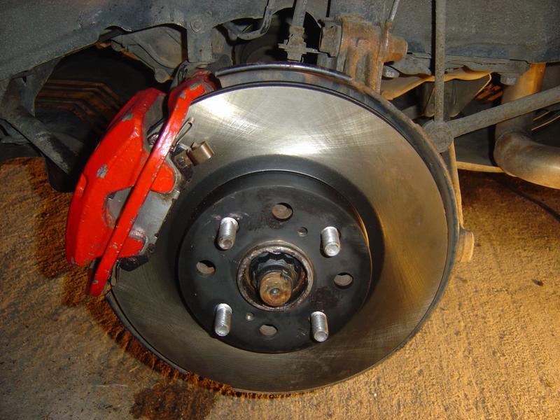

CLEAN OFF AND LIGHTLY COAT ANTI SQUEAL SHIMS WITH COPPER GREASE

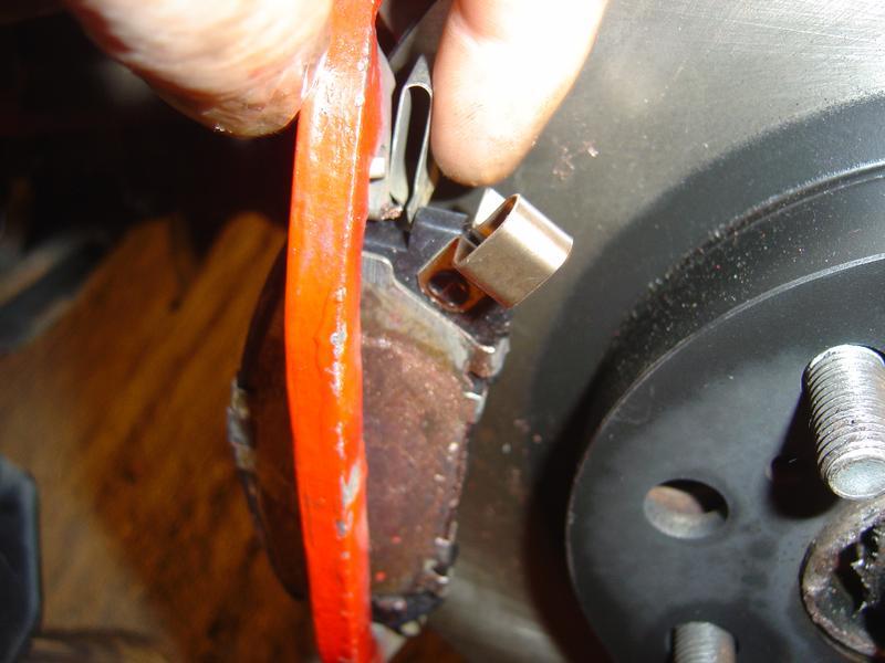

SQUEEZE SPRING CLIPS ON TOP AND BOTTOM OF CARRIER TO LOCATE SLOTS ON PAD NEAREST TO YOU
THE REAR PAD JUST SLOTS IN TO CARRIER (Note that I put a nut on the new disc to hold in place while assembling)
SLOT THE PISTON ASSEMBLY ON TO SLIDER (Again this is a bit awkward but doable)
REPLACE SLIDER BOLT AND JOB IS DONE
