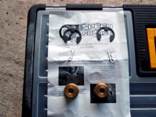

Bought from speedsource here
Cost about £12 shipped.
In the packet.
First be aware that the two bushings differ slightly, one is marked L for lower, and goes on the lower of the two linkages.

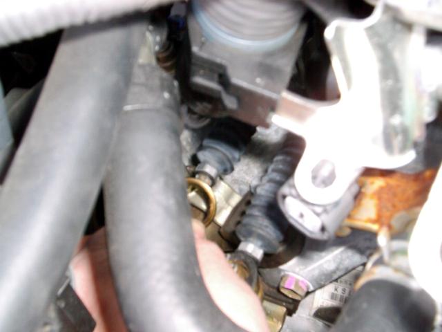

I unplugged the passenger side 02 sensor to give a little more room.
First remove both cable ends, simply pull off the cotter pin and remove the top washer on each one, this allows you to lift the linkage and bushing off the shaft.
Now we need to remove the oem bushings you can see in the picture above.
This can be tricky, i found the best way was to push a slim flat blade screwdriver through the rubber then lever the bushing out.

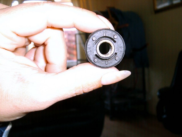

Once out you are left with an empty ring.
And two oem bushings,
