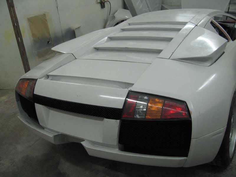

If you know what I'm like then I enjoy nothing momre than ripping a car to bits and sticking a glass body on top  :-) :-) :-)
Its nearly time for my next project and this time the donor is a mk2 mr2 turbo.. the car will end up looking like a Murcielago which will have speed releated moving spoilers and bat wings  :-) :-) :-)
The idea is to build a little box that will control these things depending what speed and temp your car is at. I have already managed to code up a little box that now reads the pulses from the dails and only need the temp now. Then I will make the box with a couple of relays. Its raining at the mo so cant be bothered going outside messing but if it stops will try and get a little youtube video done of whats I've managed so far  :-) :-) :-)
a la bat wings  :-) :-) :-)
