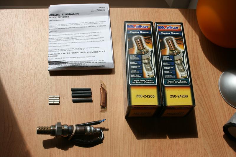

The sensors arrive well packaged with all necessary fittings

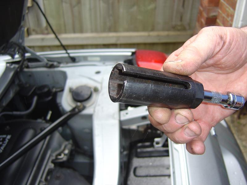

This socket is absolutely essential for removal and replacement

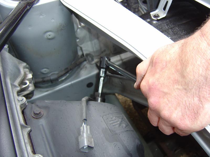

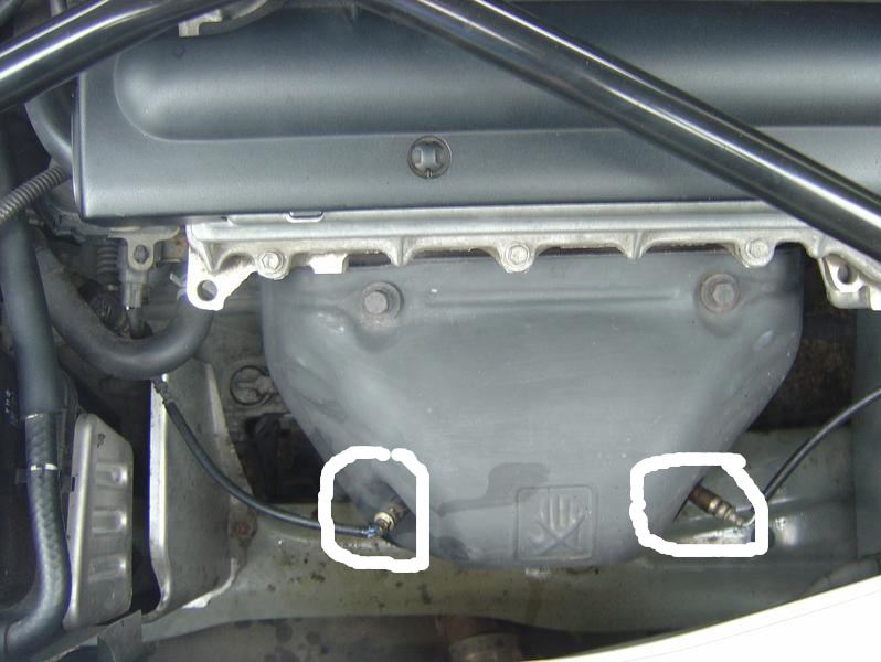

Pre-cat sensors (sprayed with release oil an hour before)
Removing is easy with the right tools

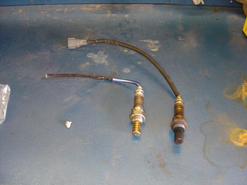

The old and the new

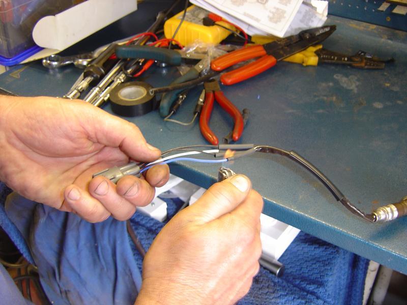

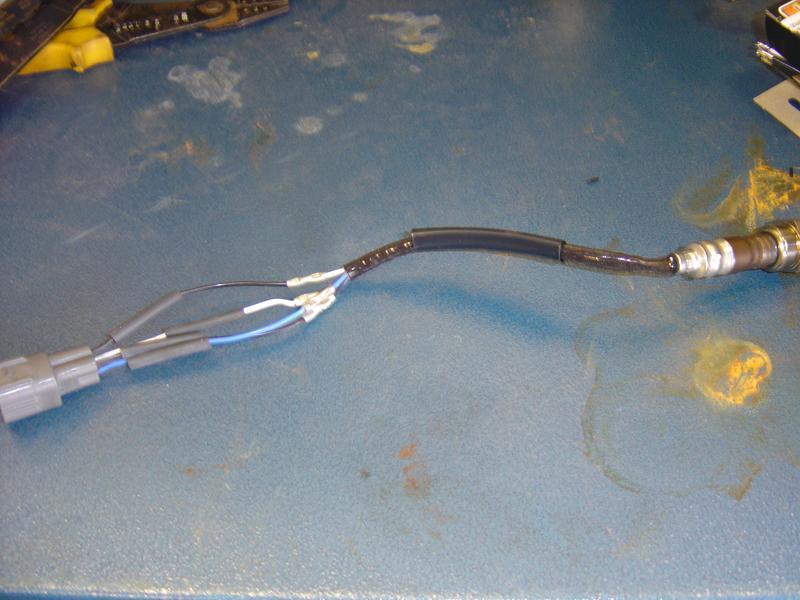

Wires crimped to the original plug
Heat shrink covers

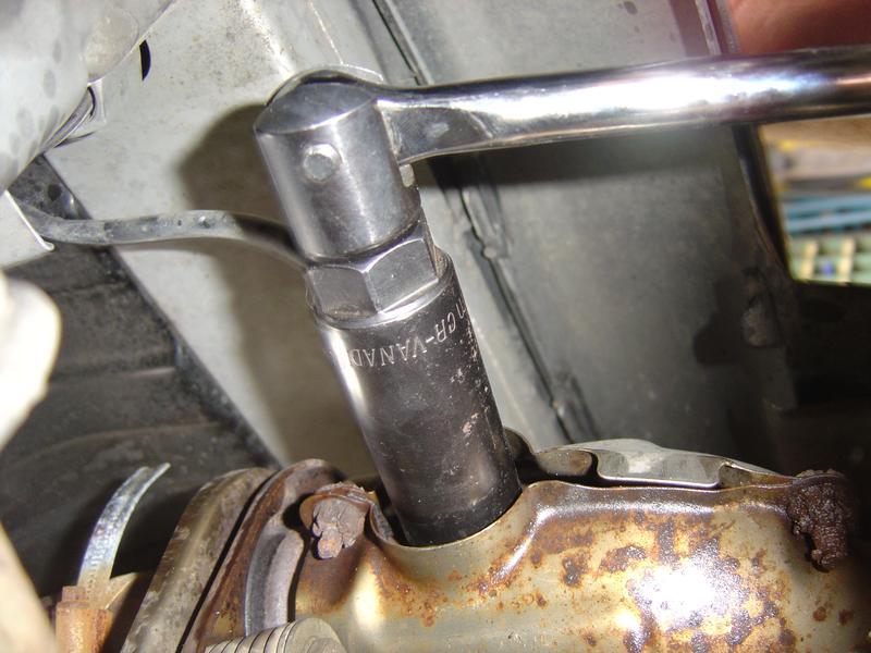

After cat sensor removed easily from underneath the nearside rear (even with my quad pipes in the way)
Copper grease (supplied) was used when replacing the sensors and all appears to be working well
