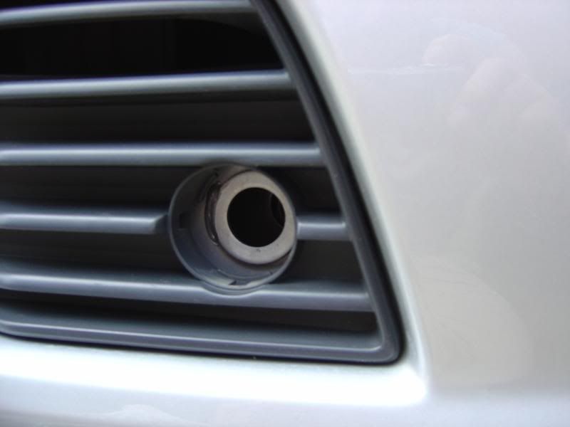

This is for the pre face lift models to replace the blanking plug with extra rear lamps.
The lamps in question are trailer marker lights and they can be bought from HGV motor factors just ask for a pair of THESE, you will also need 2 X 5watt single contact bulbs (nothing above this for side light application)
All you need to do then is fit two core cable and Scotchlock them into your rear side light wiring.
Fitting is simplicity in itself   s:wink: :wink: s:wink:
Remove bung
Feed wire through hole for connection
Push into place
Wire up and................................Voila

Lights have never been fitted in them, it was just an idea I had four years ago   s:wink: :wink: s:wink:
