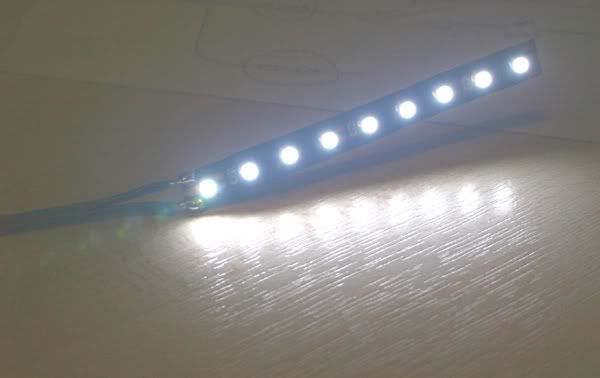

Gif
Here's the answer then   s:D :D s:D
It does just solder.  Not the neatest for a first effort but as someone else once said, let there be light

Gif
It is Maplins unfortunately.  Bit pricey but worth it.  That's a 9 led cluster attached to a 9v battery.  Just tried it in the footwell and it works a treat.  Easily bright enough for my purposes.  Two 9 clusters one for each side wired together and through the door switch circuit should be good enough.  Not really worried about using the interior light switch to control them.
Would have thought one more for the glove box with a door switch (suitably shielded from view to avoid snow blindness) and two more for either side of the rear bins again with door switches.

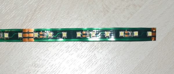

Lighting strips are similar to this
