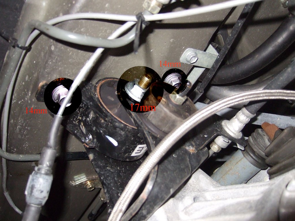

The first job on each mount is to take the centre bolt out with 17mm tools. This is done up tight so the torque wrench or a breaker bar could be very useful. With the nut off the bolt should slide out or unscrew fairly easily. Here is a picture of the mount nearest to the front of the car. The large 17mm nut is highlighted as are 2 of the 3 x 14mm bolts.
Please excuse the excess tubing which you might not have, oil feed for turbo and wires to the oil gauges!

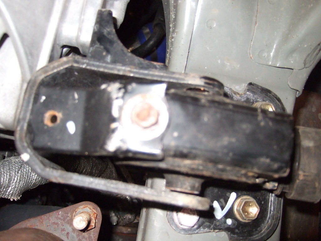

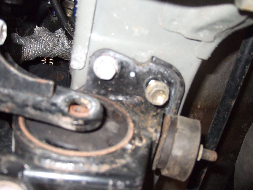

You then have to take the mount off the chassis member. 3 bolts in the case of the front one, 4 in the case of the rear. Here is a view of the front one. The centre bolt is already out, and 1 of the 4 mounting bolts is partially undone..
Here is a different view. Note this is the mount that you can put a jack on to lift the car. Also please note from the photographs that there are other nuts and rubber thingies around. These DO NOT have to be undone.

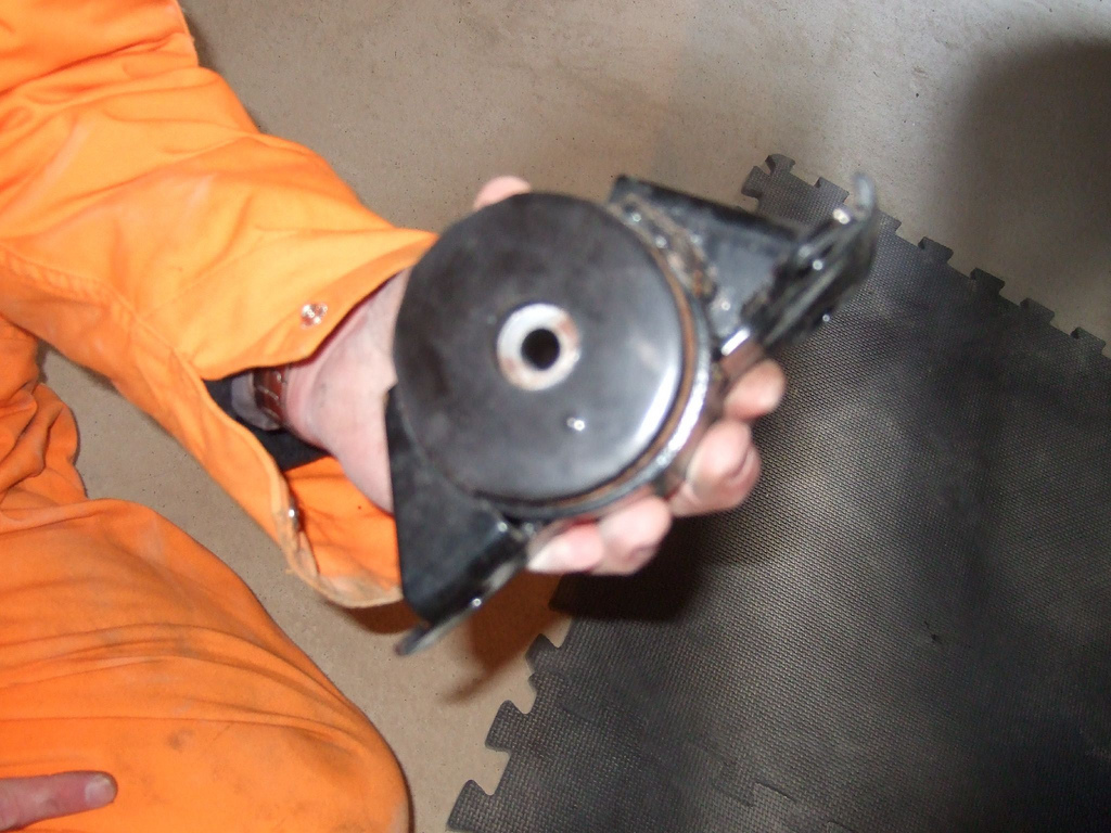

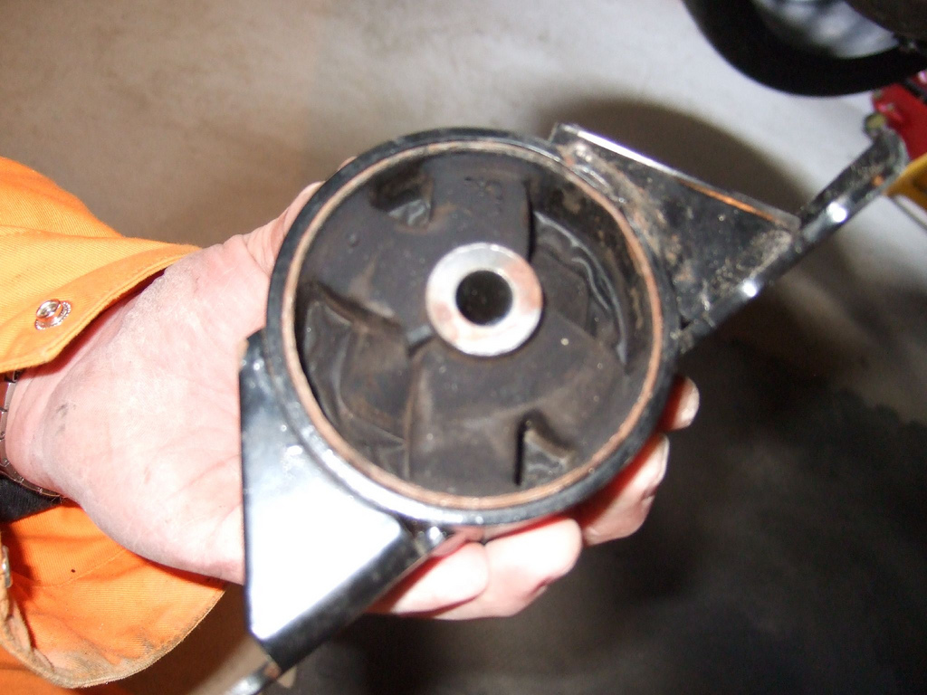

Once your chosen mount is off you can come out from under the car and study the pattern of the existing  rubber insert.
Firstly it's a good idea to give the original rubbers a brush up to release any dirt that may have accumulated. All you then have to do is match the appropriate Kirkosaurus and push it on. Note that there is only one way they can all go, so look at the designs carefully. We noticed on Jason's rear mount there was a little "nib" on one side of the OEM rubber mount which seemed to stop the Kirk's mount going fully in. We took this off with a Stanley knife, and afterwards all OK.

I'm afraid I couldn't cope with the vibration. After much thought it was decided that most of the vibration was not because the mounts were too stiff, but because the new inserts were transmitting resonance back into the vehicle. If you look at the last photograph you will see the flat face of the mount is very close to, if not slightly proud of the centre tube / ring. Having taken the mounts off the car we actually saw the indentation of the metal arm of the mount in the inserts.
So we cut off about 2-3 mms off that face with a hacksaw. Putting the inserts back in they definitely fell back below the metal ring.
