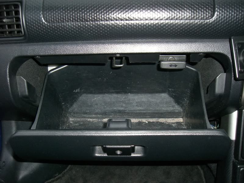

Before
Empty it
Remove it

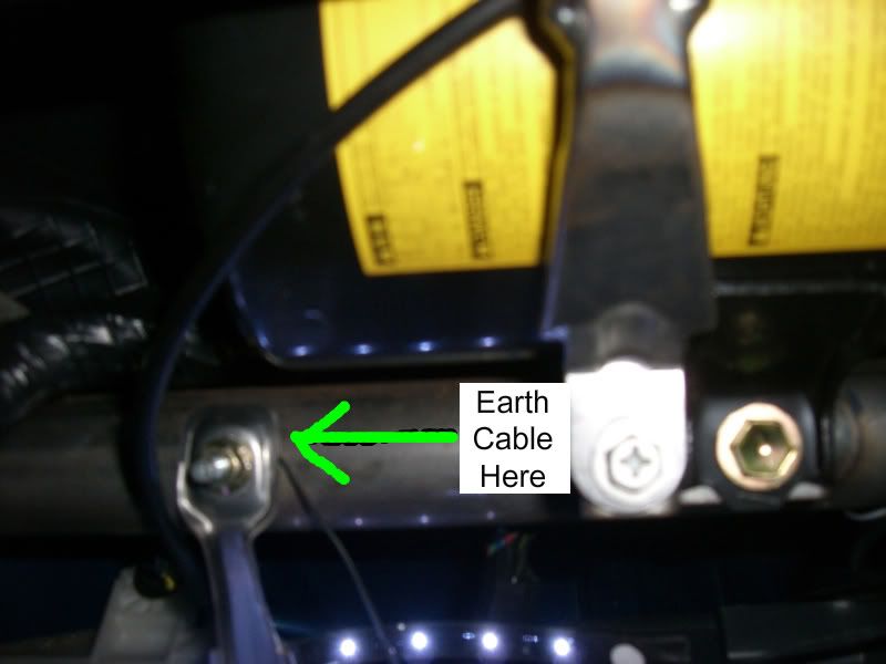

Earth it

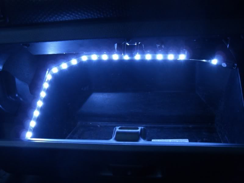

And VOILA!
Draggon
Im liking that.....bit too bright for me, but then that is is the purpose.....but still liking that.

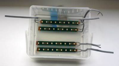

PS That's the exact same drill hole I made for a Maplins push to break switch.  It's better if you can position the LED unit up behind the glove box lip on the left hand side of the catch.  That way it shines into the glove box and not in your eyes.  Worked perfectly for me but I did have to make these to achieve it.  Also used them for footwells and they came out really subtle even if they don't look like Ikea manufactured them   s:lol: :lol: s:lol:

I did my footwell lights with the same led units I made. Picked up a permanent live for these behind the kick panel, think it was the lighting circuit from memory but not absolutely certain  s:oops: :oops: s:oops:  anyway it's done no harm if it wasn't and the LEDs are only low current anyway.
The door switch earth circuit is behind the same kick plate on the passenger side so all very neat.  Ran both footwell lights from here by taking the feed across under the dashboard and into the driver's footwell.
