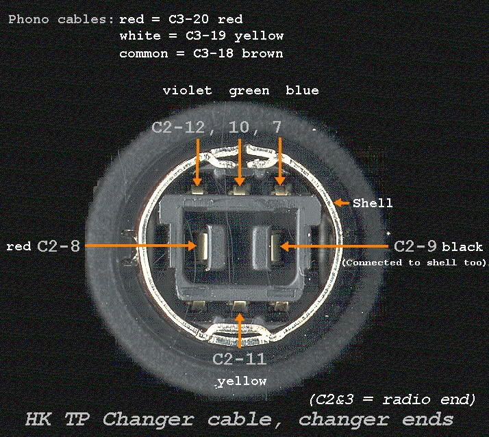

On a thread from the past, loadswine very helpfully posted up this pic of the rear of the stock pre-facelift Sony unit:
Which socket do you mean?  I'm guessing the one to the left of the blue remote control socket?  If so, I *think* thats the CD changer/minidisc changer input..?

Nothing even resembling RJ45
cd changer

I'd confirm again that the "in" by the blue remote is the CD Multichanger lead.
