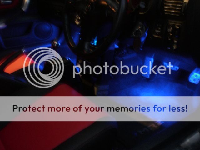

Found the connecton ok....... would have struggled without your picture......I put an inline 5amp fuse on the live.....
Had an issuse actually siteing the led strip lights, eventually put them at the bottom of the glove box frame on the passenger side and on the lower section on the steering wheel cowl..........
Initially was unempressed when I finished with it this afternoon.......
Now I've seen it in the dark, looks the bizzo, very happy with the overall effect............my youngest wants me to repeat the excercise on his Fiesta!!

Gif
I had exactly the same experience.  Doesn't look very good in the day but the blue/white light they emit in the night gives it a very professional look IMO.

Lights are on an ignition controlled feed. Used the lighter 12v and earth. switched either red or blue or both. very easy cheap mod with great effects. These are the lights i used but next time I would get the same model in both red and blue. (blue model is best imho)
