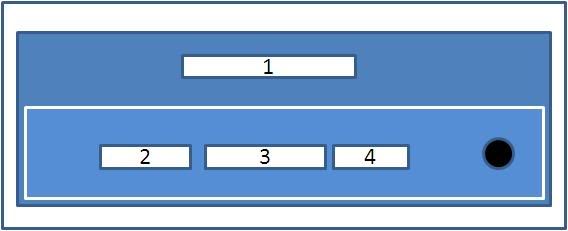

If this is the back of the HU:
Should I be trying to plug into socket 1 with one cable (ie CT10TY02), or sockets 2 & 3 with a split cable (ie CT10TY01)?

You have brought a T Harness, you need a CT20TY02 wiring harness
do you have two blocks behind the Head unit or one?
I can supply you the right cables if you want, let me know

Found this pic of the back of a fisher price. This isn't mine but is the same model.
As you can see, socket is different   s:( :( s:(
#42
Hi, my car is a 2001 so i used a CT10TY01 i have a sony standard radio, some facelift cars have the old wiring so this must be the case with yours you will have to try a CT10TY01 the CT10TY02 does fit as ive installed them in a 2005 Roadster with the same standard HU u have.
