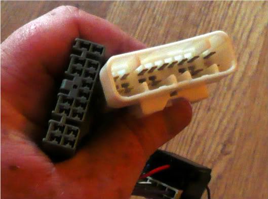

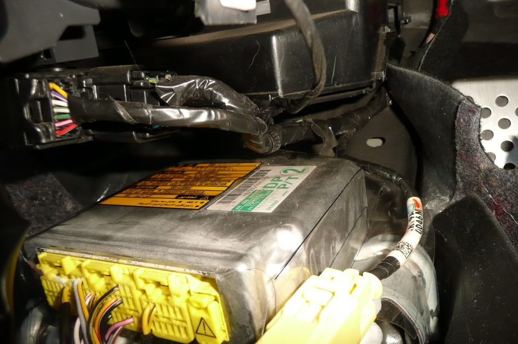

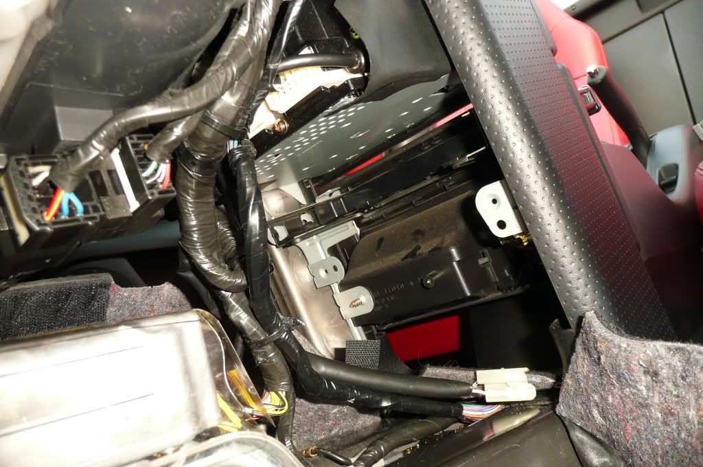

Right. I've searched the forum like mad, been on Spyderchat, the lot. I can't sort this.
It's an 04 Plate roadster, so presumably Fisher Price.
I've bought the adaptor:
Looking behind the dash clearly the plugs on the HU don't match. That's OK because I need to follow the wires to find the main Toyota loom, not the sub loom.
Is it the connectors to the left on the last pic? If so I have the wrong adaptor.
Alternatively, does the wire vanish under the carpet into the transmission tunnel?
Really can't sort it.
Epic Fail.
All help gratefully received.
