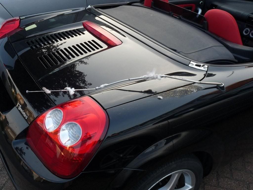

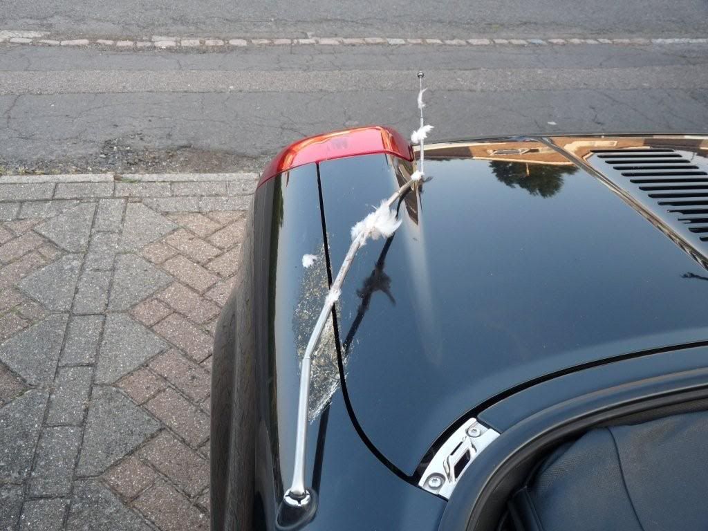

does anyone know the part number for the centre of the aerial (on post 03 if its different)? And how much?
I had a slight coming together with a pigeon at 60mph today, just missed my head but did this to the aerial....
Who won, I guess neither of us.

I believe that's 86337-17080 - 'ROD & PIPE, SEALED W/CABLE' (Yeah, strange description, I know!)

Thanks Aaron, Mr T was telling me its a sealed unit, but with this it comes out at £47 for the centre.

New mast in from Mr T and yes its about a 5 minute job, unscrew chrome nut - turn on - feed new plastic  -turn off - refit nut - job done.
