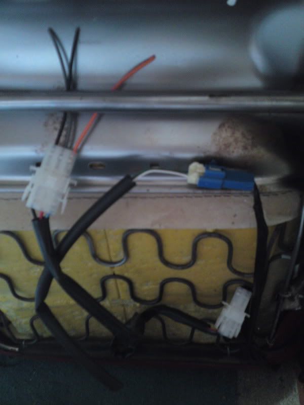

Seems I have purchased a heated seat.
The guy left the plug and the female plug plug 4 wires.
Question is, what do I do with them?

3 lots of wiring
Airbag
Seatbelt
Heater??????????????

Quote from: "uktotty"Heater??????????????
I'd guess red=12v, both black are ground...
You have a multimeter? Measure the resistance between red and black, should be few ohms.
Make sure you measure in coldish place, where the possible thermostat isn't open.

Quote from: "uktotty"3 lots of wiring
Airbag
Seatbelt
Yep, does look like the connectors I have on my heated seats (anyone know where those connectors can be bought by the way??)
The original gb/install thread is probbably still around on here somewhere, but basically they feed off the fag lighter circuit and go to two buttons in the centre console..

Its red, black and grey on those 3 wires
uktotty
#14
just to clarify, its ORANGE, BLACK and GREY
So my guess is
Upper heat pad
Lower Heat pad
Ground?
Tem
#15
Quote from: "uktotty"just to clarify, its ORANGE, BLACK and GREY
So my guess is
Upper heat pad
Lower Heat pad
Ground?
Just measure them and stop guessing.  s:lol: :lol: s:lol:
Makes no sense to have separate wires for both pads. It would make sense if it had lo and hi positions on the switch.

wbarrwebster
#16
Quote from: "Tem"
So my guess is
Upper heat pad
Lower Heat pad
Ground?
The original heated seats I have DO have hi and lo  positions on the OE switches!

uktotty
#17
Cheers B, that makes much more sense now as these are OEM seats
