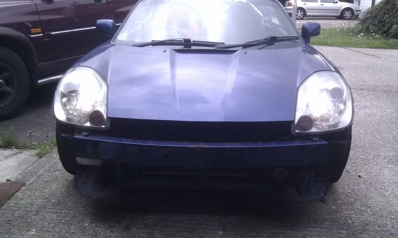

Well after a lot of questions and mucking about I have now got 2 fully functional facelift headlights to match my taillights
First position Sidelights
2nd position sidelights and dipped beam
3rd position sidelights, dipped and main beam, just like OEM
Now how do you take pics of lights without flash??
All on!

Better pics
