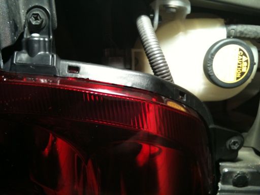

Remove 2 phillips screws on top of cluster and gently maneuver cluster out without snapping bottom plastic knob (once the tops out the rest will follow)...
Also remove the electrical socket for the lights by squeezing it and gently pulling...
Remove small phillips screw in middle of light cluster at the back.
Then with a small screwdriver gently prize apart the clips STARTING with the black ABS housing. The last 3 remaining clips should be the Red plastic ones on the lens itself.
These come off by pressing down on the black abs that is slotted behind the clip. They take some very very gentle persuasion. I must admit I snapped a couple (naughty boy).
You can see one of the black ABS clips you should start with in the above photo.

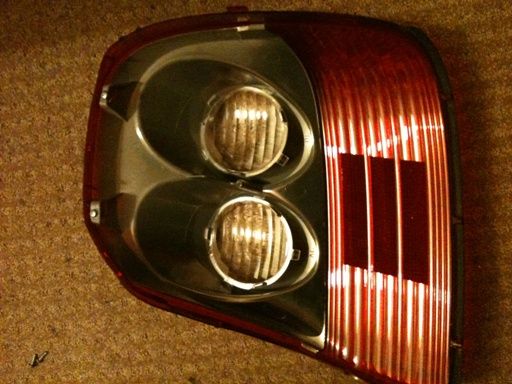

Now your lens should be apart from the back section there is a middle section you need to split. Just 2 phillips screws and you have these apart and should be where all the water is.
(now you see why you can't dry them out from the rear).
Taking out the two screws reveals...

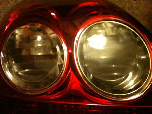

So, clean it out using a combination of toilet roll to get the worst and then your wifes favourite hairdryer (with or without diffuser will be fine) !
Replace as per opposite to destructions and heres what you have when you're done...good as new...for a week until they get rained on again.
