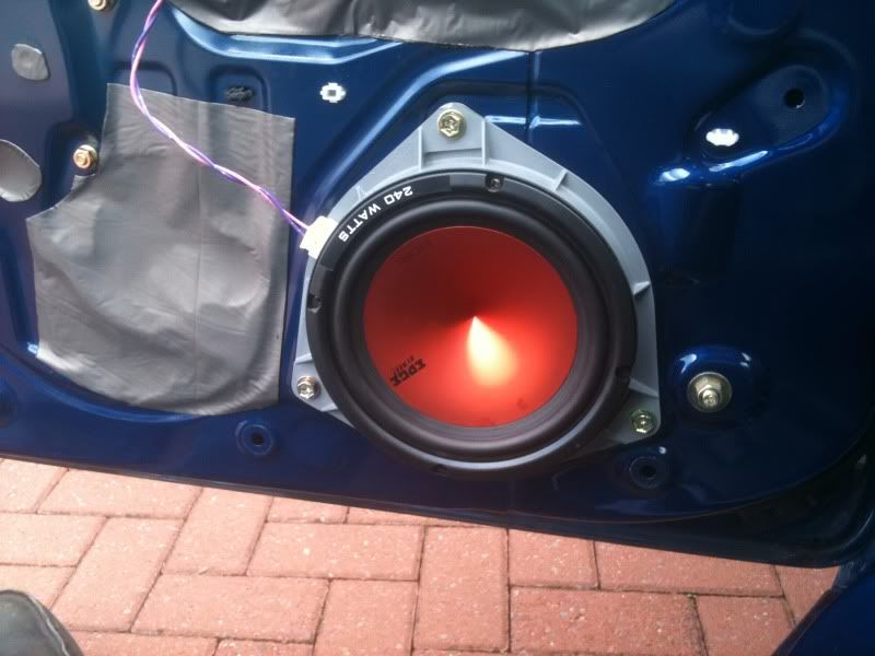

Speaker
The component speakers are cheap and nasty Halfords specials for £45!.  Remember peeps quality doesn't come in a box from Halfords   s:oops: :oops: s:oops:  .  As a rule I'd never recommend doing what I did here.  Infact the only reason I have them is the bangermonics Micra I had before my MR2 had no speakers so I bought anything cheap as it wasn't worth doing a decent install on it.  But to my surprise these EDGE 306 speakers are fairly decent for the money, they seem to be the exception to the rule.  So since I'm skint I bought another set for the MR2, the last set went with the Micra when I sold it.

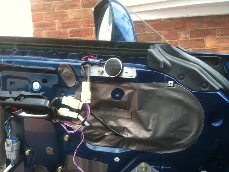

Tweeter
The tweeters are again on the stock mounts, I had to swap out the capacitor though.  The crossovers on the Halford's specials were in a nice plastic box, when I took it apart it was just a capacitor   s:lol: :lol: s:lol:    s:shock: :shock: s:shock:
Looks very OEM  :-) :-) :-)

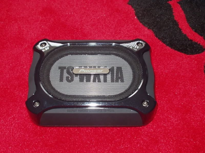

Pioneer Active Sub
Most my budget went on this £140 ouch.  Nice bit of kit, small, light and active and its a really good fit in the passenger bin

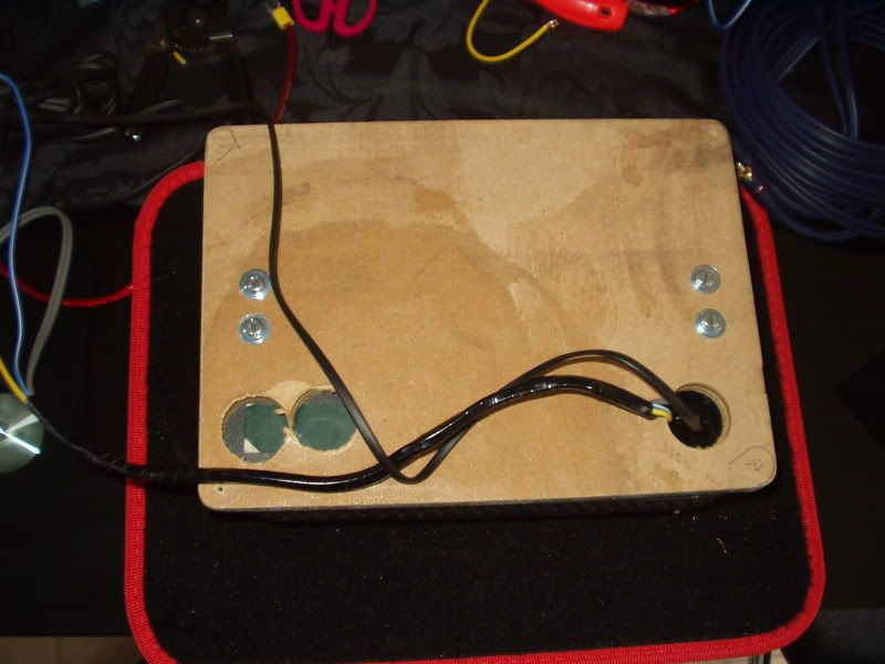

This is the base I've made up for the amp, as you can see I've used MDF and dowels so I can sit the sub on a 2nd base above the amp.
MDF Base
The top MDF part bolts onto the Pioneer sub, like so..
Sub Base

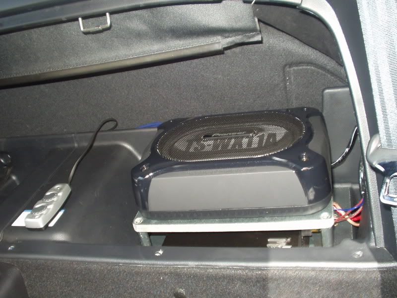

Finished!
Sound wise I'm very happy with it.  The best part are those cheapy speakers, given what they cost they do sound very good with the amp driving them.  The sub does its job but like all small active subs it won't punch much, it just gives some nice bass fill.
