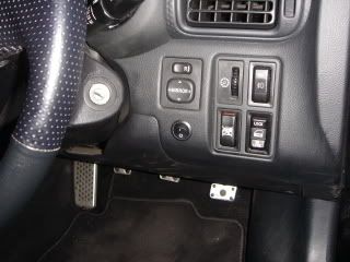

Had a great guy over today to do some wiring work on my motorcaravan, so I asked him if he could sort out my aerial for me now that I know the correct wire to cut!  He tested the black wire & proved it was the correct one.  Then cut it and fitted a rocker switch for me so I didn't have to worry about molesting the window disable switch.  I must admit I'm very pleased with the result which I think fits in very well with the factory switches.  s:D :D s:D
I can now blast along with the roof down listening to CD's without the wind whistling through the aerial.

Wow... That looks fantastic! I want one of those. Knowing nothing of wiring etc, how would you wire that up? Any pointers?

All done
I have now lost my coin holder  s:cry: :cry: s:cry:
But I can now keep my aerial down.   s:D :D s:D
BTW my facelift 56 plate was a blue wire not black. So it looks like it can be either colour  post facelift.
Well pleased.  Been meaning to do this little mod for ages. I wish I had done it before going to Italy when I nearly lost the aerial getting out of a very tight garage space.

Installed a rocker switch with LED today like in the pic for my aerial, hardest part was getting myself in the drivers side footwell to get to the radio cables but got there in the end then out for a spin round the lakes in the lovely sunshine and aerial tucked away.
Mark.
Yeah black wire on the plug nearest the drivers side, it's a bit fiddly but can be done without taking the radio out
