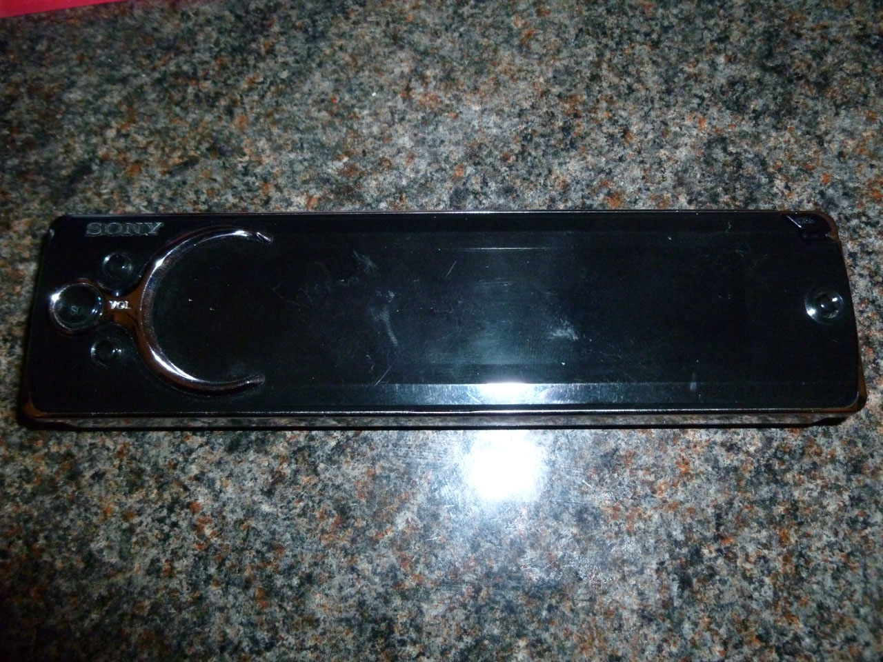

Yeah, I did think it didn't sound like the stock one. So basically just take the Sony single HU and the Toyota->Sony plug out of the MR-S (that should hopefully be there already) and put it in the MR2, then the stock facelift unit should just plug straight into the MR-S (well having to change the double din holder over too)?
Here's a photo:
