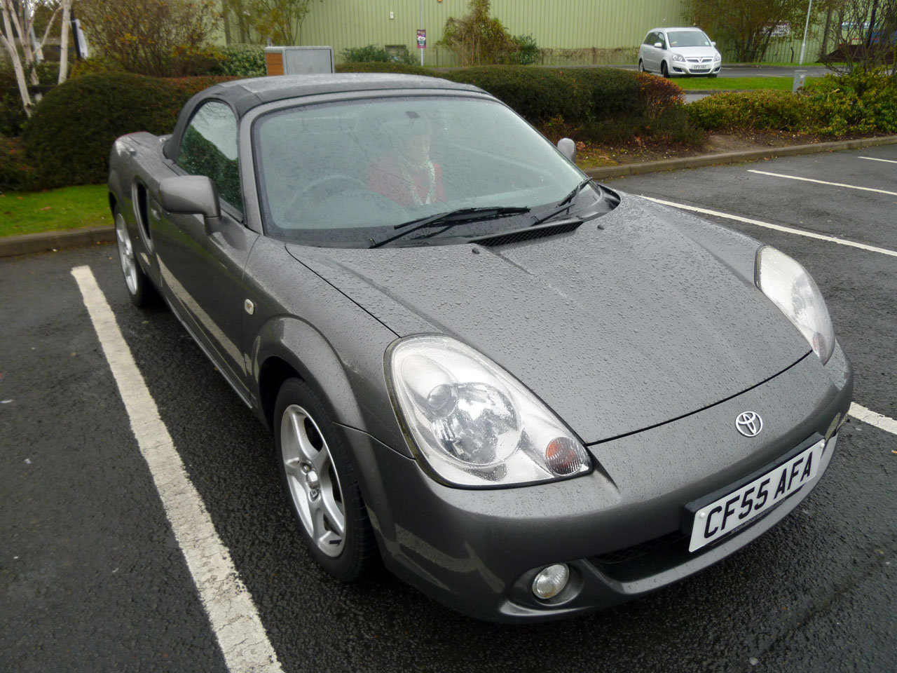

December I bought myself my 2nd MR2 from Barry in Wales, a Sable 55 plate with A/C and Heated Leather seats. She had a few more miles on than my 11 year old MR-S but I thought I'd take the plunge at the price and upgrade to a facelift in my favourite colour. Went over on the train and picked her up on a lovely December morning... in the rain...   s:crazyeyes: :crazyeyes: s:crazyeyes:

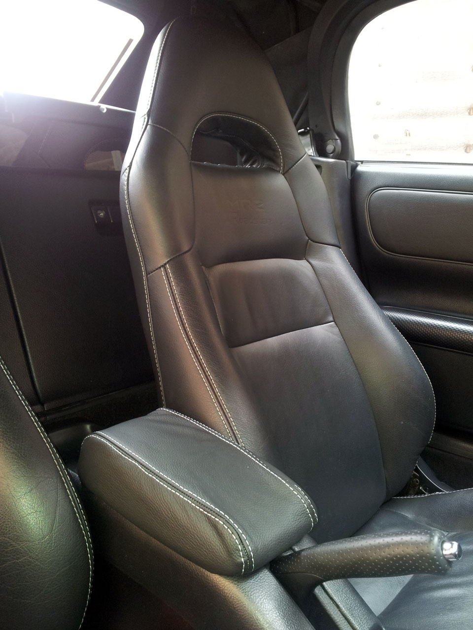

I transferred over my old centre console with my armrest and cut out slots for the heated seat switches, these are now hidden under the armrest which means I don't accidentally switch them with my elbow:
As I can't keep the armrest with the leather matching my old seats I got a new leather cover delivered today; it's only on as a test fit but I think goes pretty well, I will be adding some padding and installing it properly in the next few days as just leather on plastic was still a little uncomfortable:

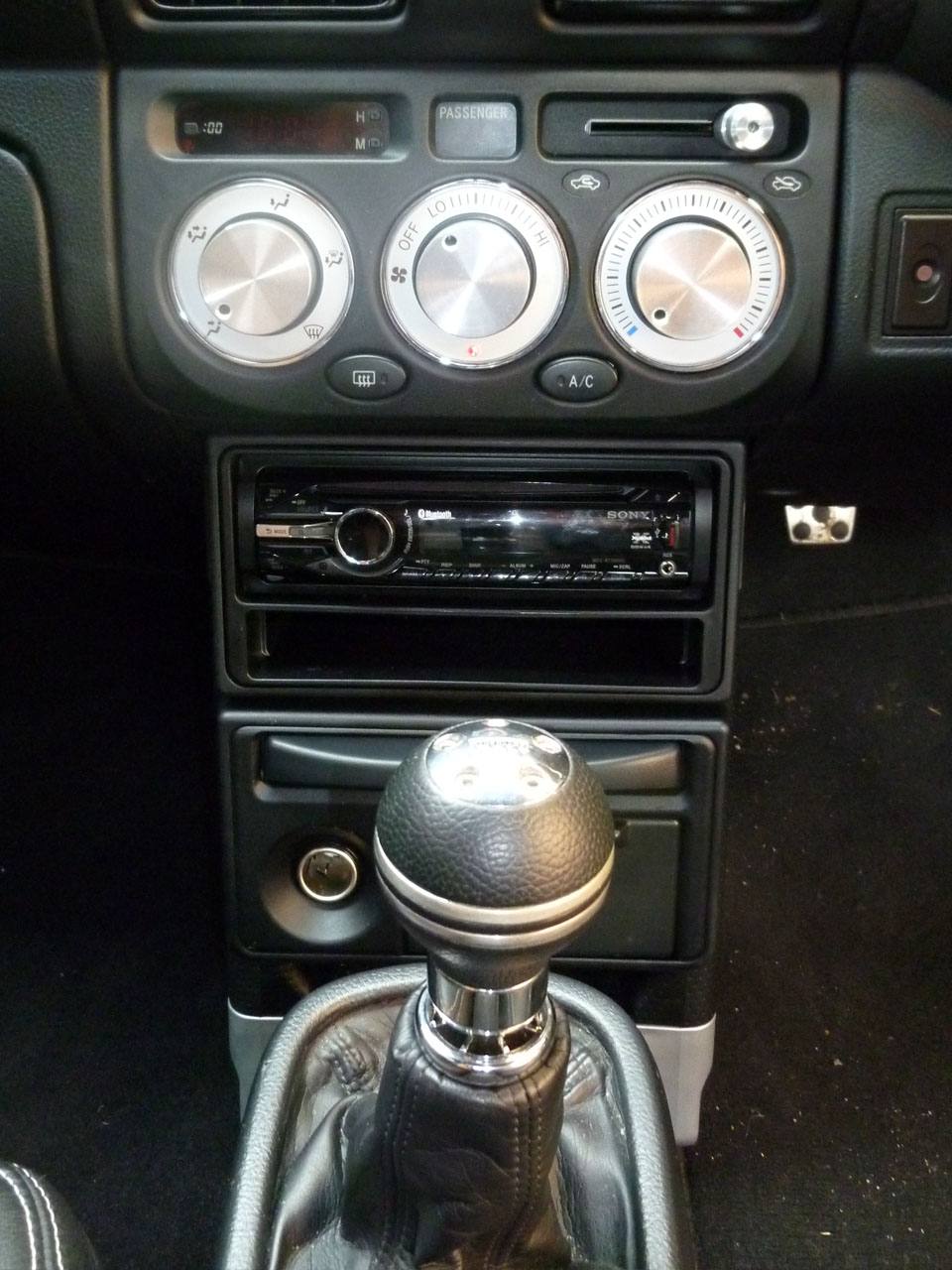

With the chrome tweeters and extra shiny bits inside the facelift I thought I'd go with a subtle looking black/shiny finish rather than a lot of spraying I did in the old car which has been made easy by Steve's (widermuller) hvac knobs. I tried out a couple of gear knobs but I've decided on this Momo one along with my TRD short shifter that I think goes great with the black leather/shiny bits and alloy/black leather tax disc holder!
From seeing a recent thread from steve-m-uk I thought I'd go for a Yaris T-Sport Sable steering wheel to match the outside of the car (it's slightly lighter than I was hoping but is a nice change) as well as purchasing some chrome binnacle rings and MR2 carpets to replace the 'lovely' red outlined ones the dealer put in.
So here's the finished dash and a top down view with my club sticker  s:D :D s:D

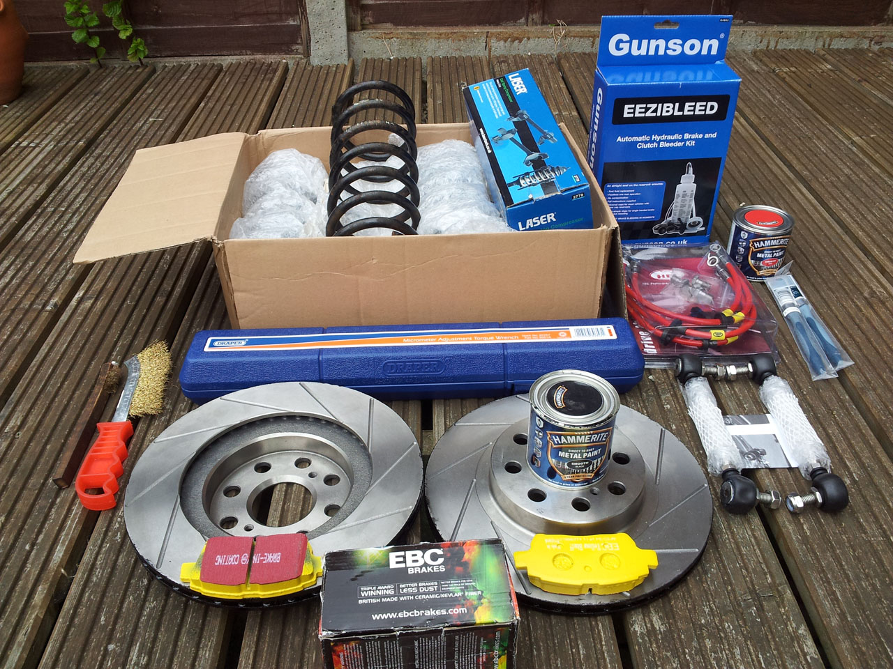

Got this little lot ready to go on now  s:) :) s:)

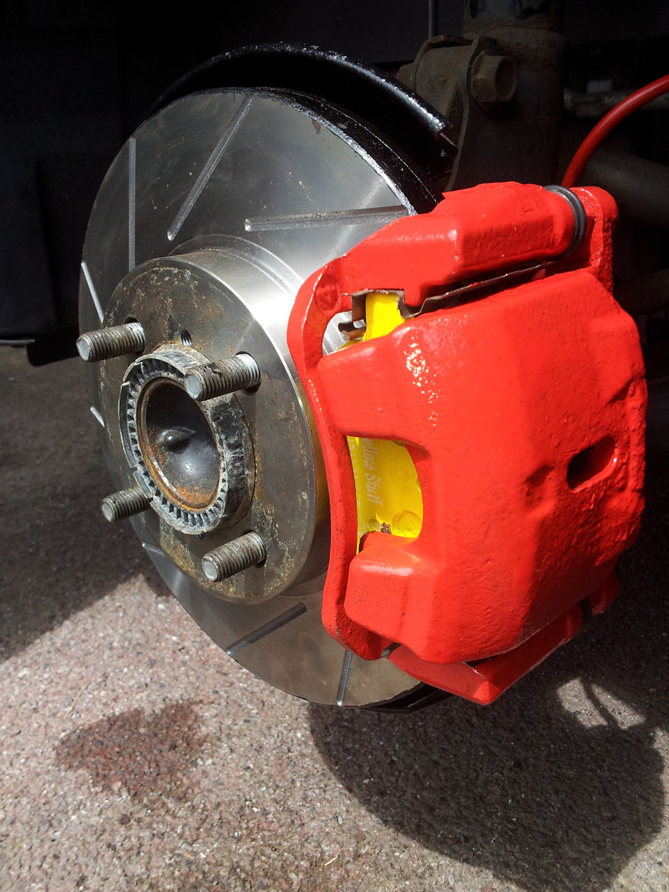

A lot of waiting for paint to dry today and not keen on the weather forecast so not going to get as much done as I want on this long weekend (just brakes really). Need the car on Thursday for a 400 mile round trip so leaving the lowering springs/ROCLinks for another week as I won't have time to get a wheel alignment done with all the bank holidays. Luckily I removed one of my droplinks from the ARB just to check and it came off easily so might not have to get the Dremel out like the last car! Doubt I can get the top of the droplink off with the tools I have so have to wait until the shocks are off the car.

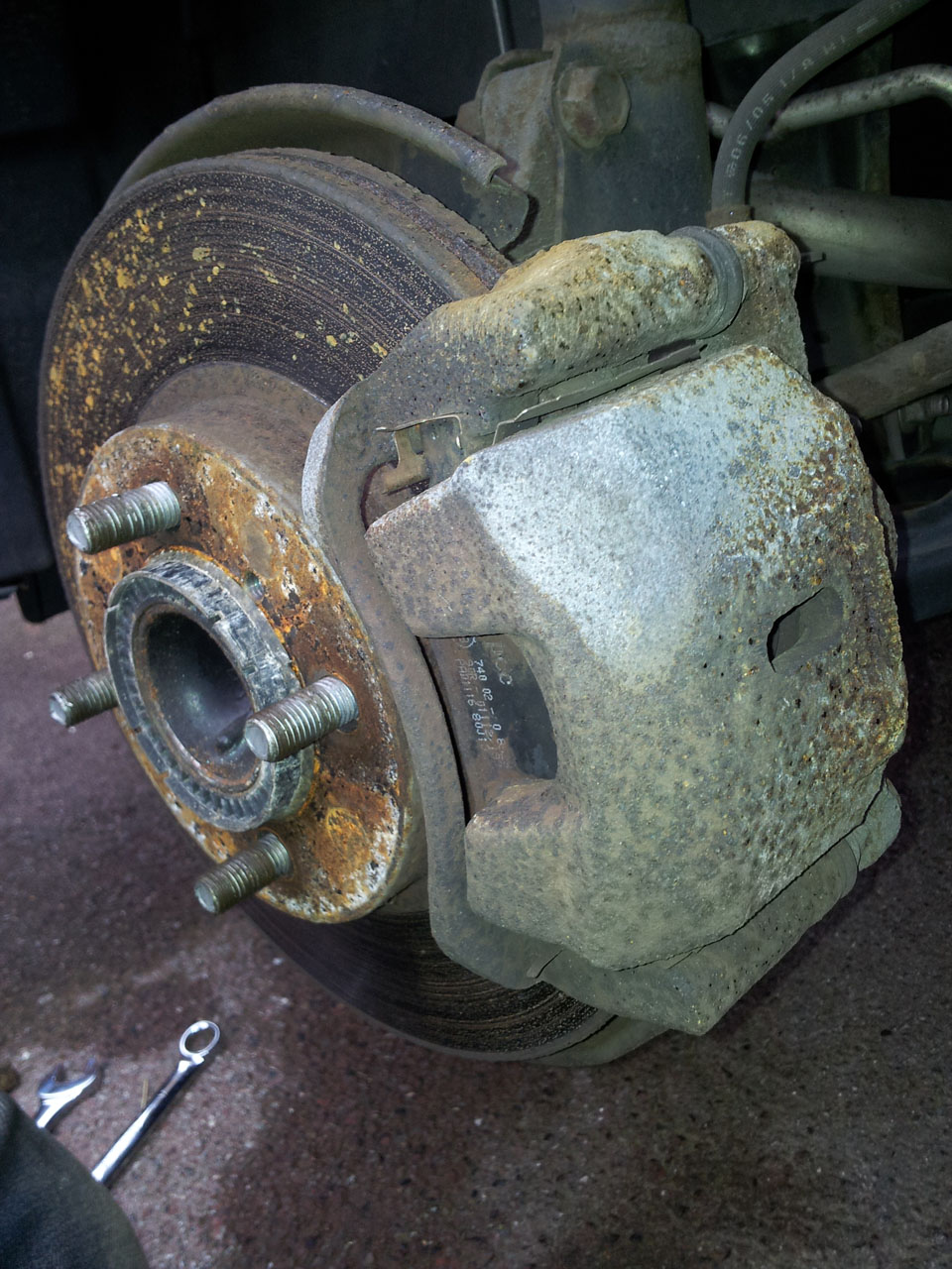

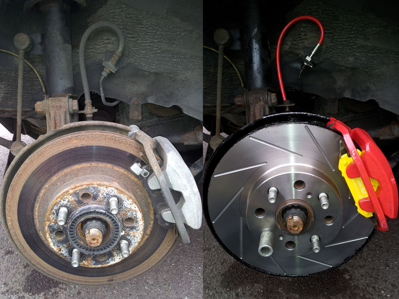

Was busy this morning so only got the back discs done this afternoon before the rain started. I really should get a trolley jack I keep forgetting... had to do one side, wait for it to dry, put it back together, jack up other side... Front's tomorrow!
Well after battling with the rain for 4 days, using lots of bin liners to protect paint during showers and managing to only just get the front brakes bled yesterday after 6pm due to not wanting water near the brake fluid I managed to finish the job I started on Saturday  s:lol: :lol: s:lol:
First issue on Monday was the Eezibleed doesn't fit our car (screw cap for brake fluid resevoir rather than push cap) so I took that back and replaced it for the simple pipe with valve from Halfords which I should've got to start with and used the 'girlfriend brake pedal' method.
The next issue was that the rear bleed nipples seemed to be 7mm (shops shut now!)... I borrowed a small adjustable off my neighbour as mine was too large to keep grip and got the back two done fine (these are refurbished units so weren't rusted). I then moved onto the rusted front O/S and the adjustable wouldn't even grip that, I gave up before I rounded it deciding to buy a 7mm spanner Tuesday morning when B&Q opened. Come Tuesday went to N/S front and 7mm spanner was too small, turns out the fronts were 8mm no the same as the rears  s:? :? s:?  a size I had all along... So N/S bled perfectly with the 8mm. Now because of the issue Monday the 8mm wouldn't grip the driver's side and rounded it off. Out with the Dremel, grinded it down to 7mm and got to use my new spanner in the end anyway, job done  s:) :) s:)
Before / After   s:bounce: :bounce: s:bounce:
I must say it definitely looks 100x better, I know I went for the common red in the end but definitely gives that extra something to the car, very pleased, juse would've been nice if it hadn't rained and I'd got it done on 1 day!

Steve Green
I have never got on with an Ezibleed that pressurises the master cylinder from a spare tyre.
I have however tried the vaccum version that sucks the brake fluid out of the bleed nipples.
Much easier when changing the fluid as you can be pretty certain you have sucked all the old fluid out, rather than diluting it.

Looks great mate. Well done for battling on  s:) :) s:)
wotugonado
What a difference the discs and some paint make, very nice. What discs are they ?
---------------Tte turbo----------------
      Graced the tarmac from 2014-2019
They're Pagid grooved discs. Managed to get a good offer from CRN brakeson the full set: Pagid discs, Yellowstuff pads and HEL brake hoses for £255 delivered (probably around a £45 saving). Great service over the phone, ordered Thursday and delivered Monday (they had to wait on the hoses). They recently did a GB for the OC so were still letting the offer through I think.

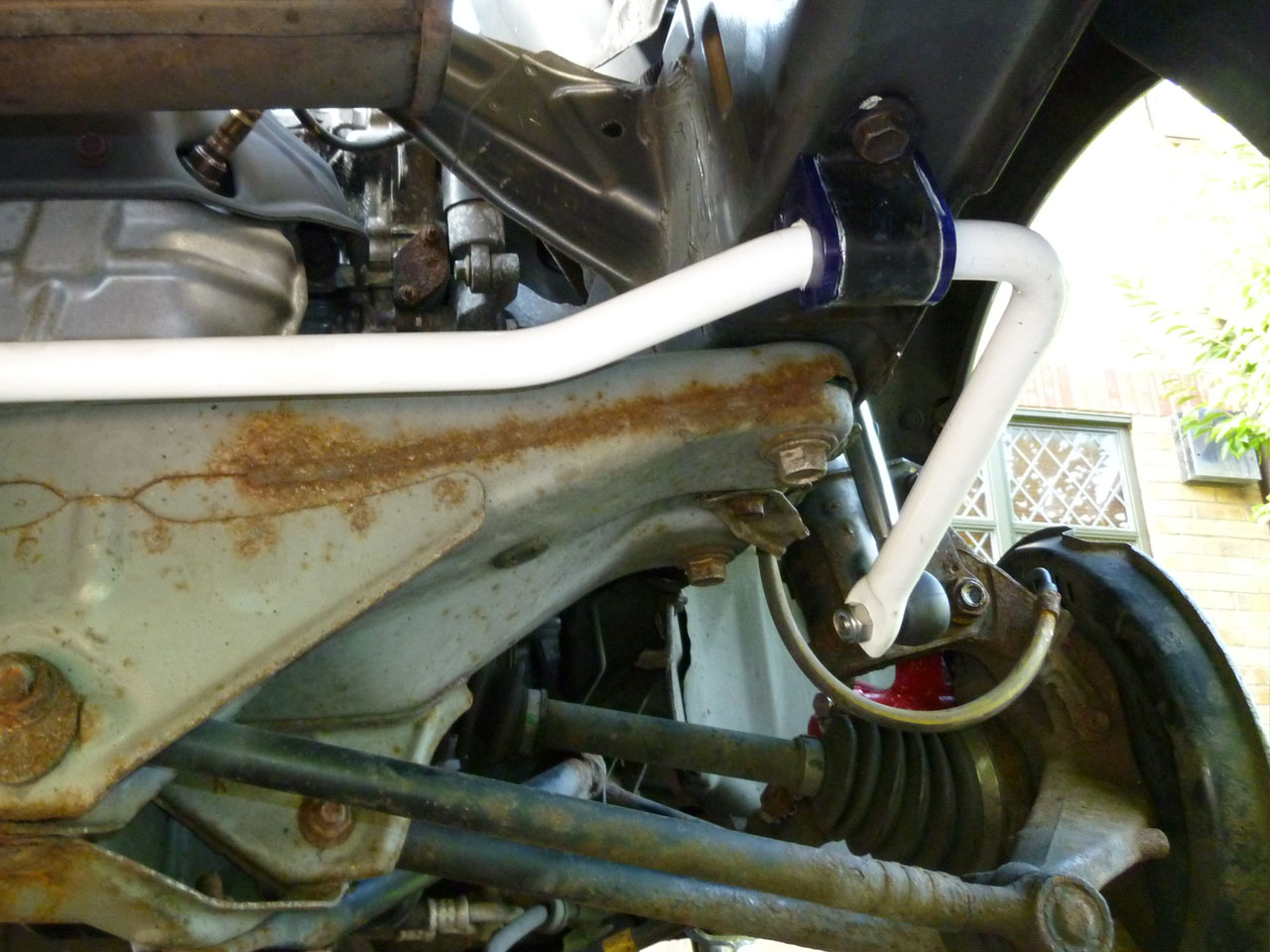

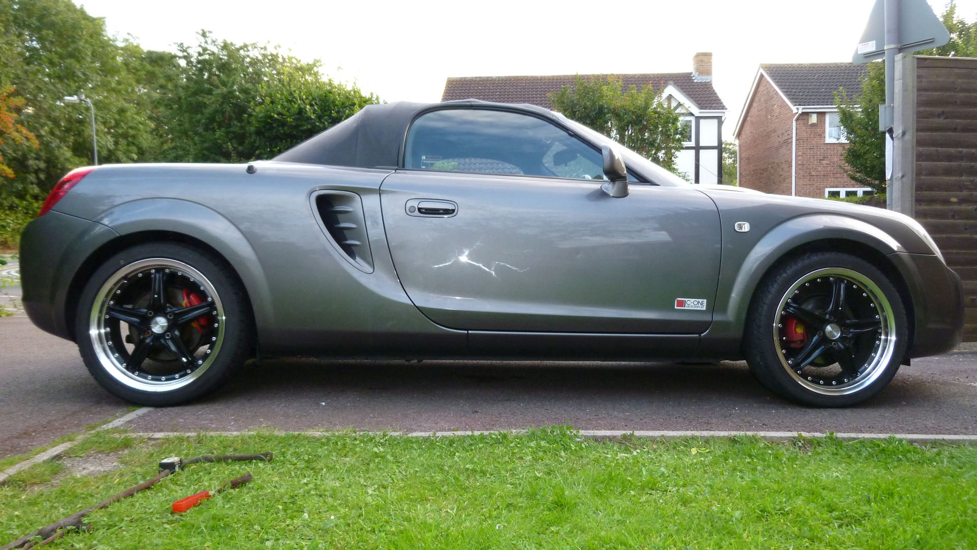

So this weekend sees the addition of this little lot:

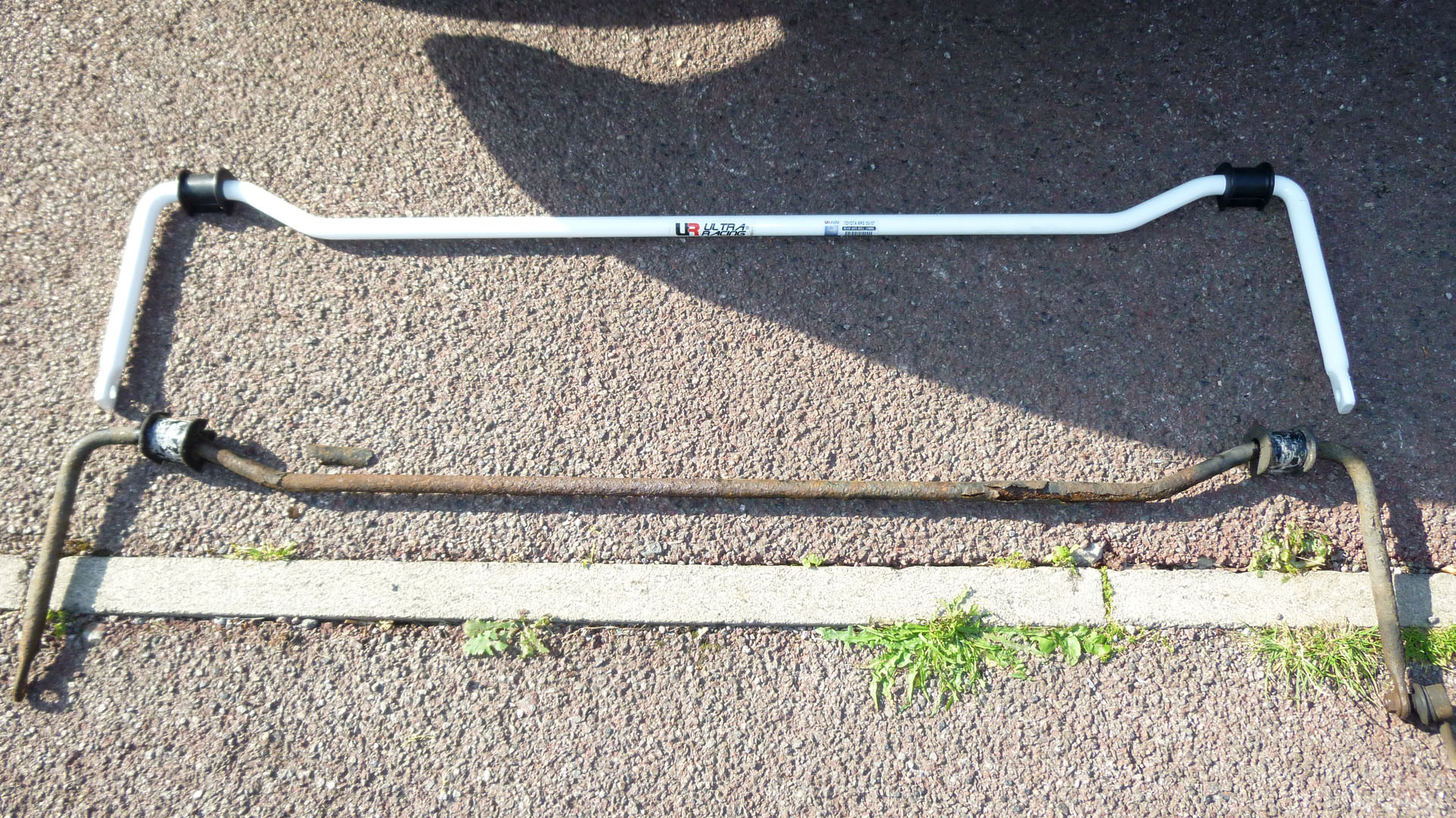

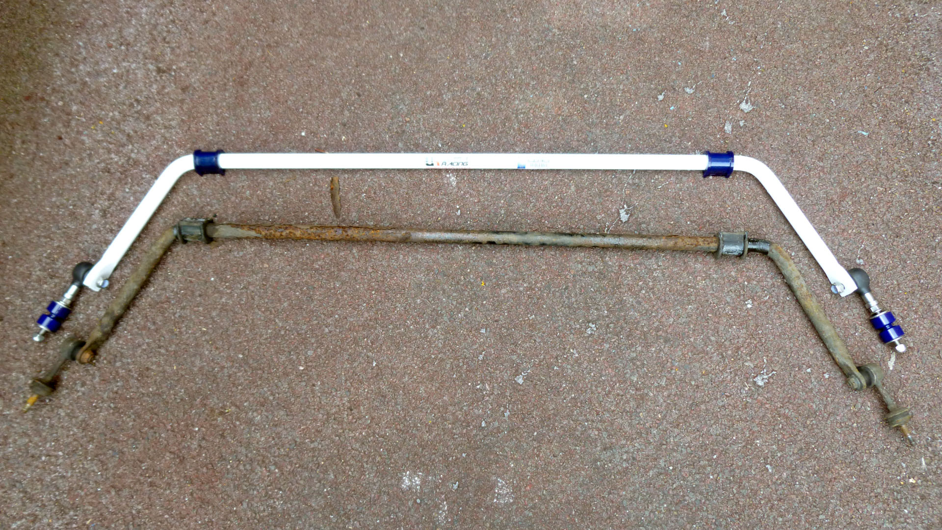

Managed to get the rears done this afternoon as I was at work this morning. Driver's side no problems, had to Dremel off the droplink from the passenger side of the ARB though.
Bye, bye Rusty ARB!
ARBs are all 1mm larger than the bushings from the GB, so enlarged the hole to fit:
*EDIT*
Sunday I did the fronts, other than difficulty removing a very awkward topmount was pretty trouble free.
As with the rear, ARBs are all 1mm larger than the bushings from the GB, so enlarged the hole to fit:
And ROCLinks in all their stainless glory:
Car looks much better now but very subtle, front's tomorrow.
*EDIT* Fully lowered:

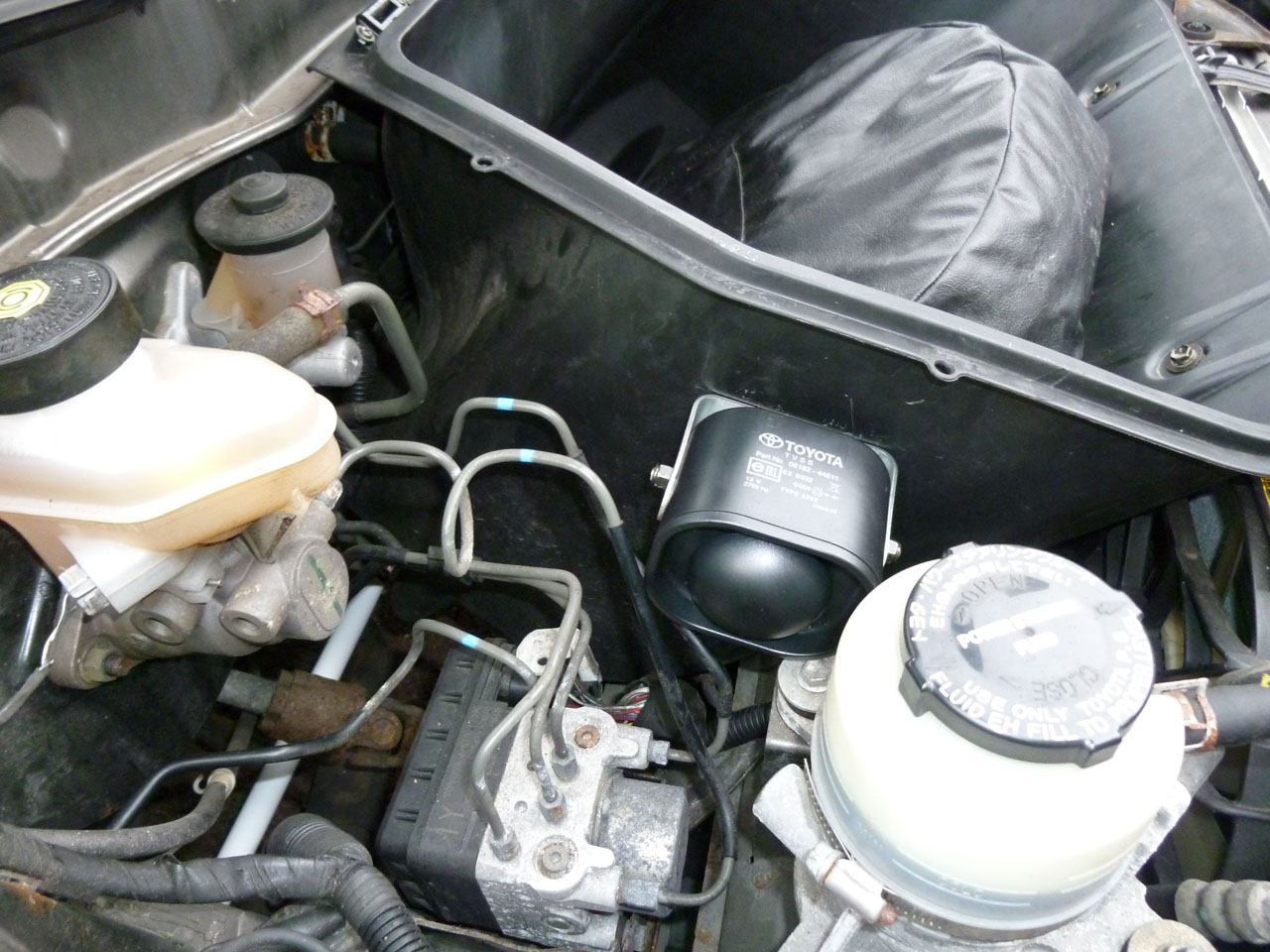

Also relocated my alarm whilst I was at it:

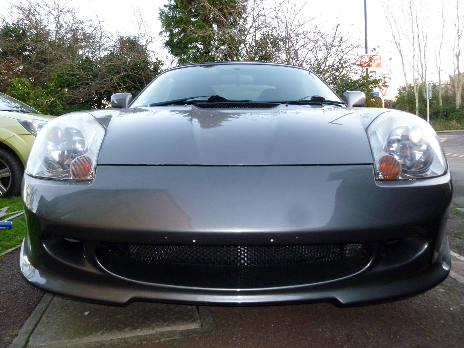

Fitted the Front Bumper today so my kit's almost finished (rear and side vents to go). Love it now!
And topless  s:D :D s:D
Also had the car jacked up to do the bumper so thought I'd fit my SP Brace:

Looks awesome mate. Some nice mods done there  s:) :) s:)
Sent from my GT-I9300 using Tapatalk 2
Looks smart! The grey really suits the kit. What's Next..?
Ex TTE Turbo
loadswine
Nice Stu!  s:) :) s:)
Front bumper looks spot of fella  :-) :-) :-)
simers
Looks mint mate....
