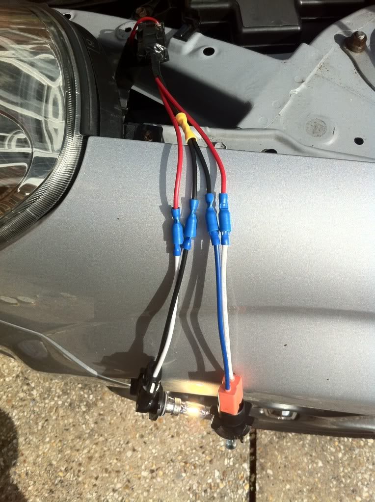

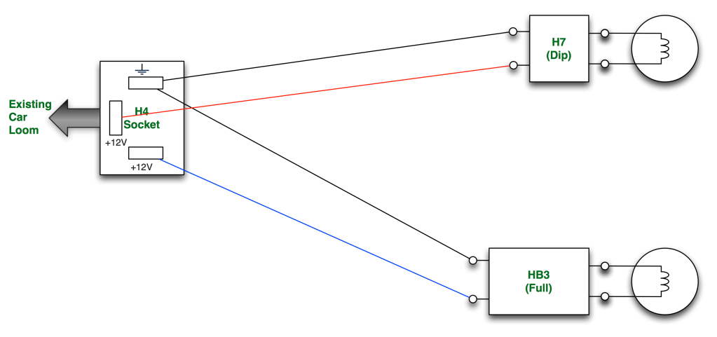

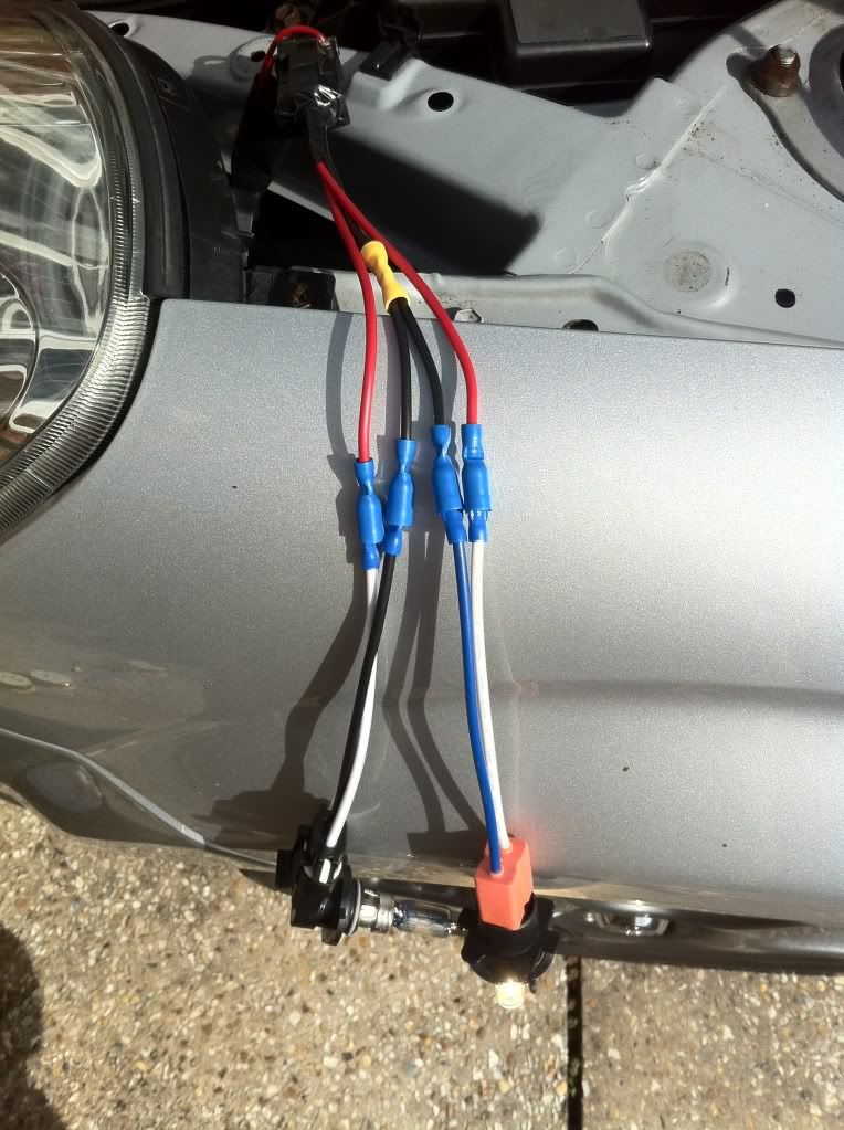

Last week I tackled the FL headlight upgrade. I tried the relay circuit and like everyone else, lost my full beam indicator. I tried a more simple circuit that mimics the H4 wiring (i.e. separate dip and full) and the full beam indicator functions correctly. The full beam is more than bright enough on its own and the switch-over is instantaneous - it functions just the original H4 bulb. The circuit is below:
Just a few more words so that they don't get buried at the bottom. While I was trying to get the relay option to work I discovered something, it's feeding the 12v onto the dip circuit that causes the full bean indicator to not function. When I placed a diode in the circuit to prevent the 12v going back up to whatever switches the light, the full beam indicator would work but the full beam would not switch off without switching off all headlights. I am wondering if a fully isolated relay circuit (where the both dip and full headlight feeds only switch relays and a separate 12v feed) may work. I have wired with bullet connectors so that I can try this another day. Also I managed to get some H4 plugs rather than cut into the existing wiring (http://www.ebay.co.uk/itm/180596756261).

Just a little info for you but the full beam light has two neutrals on the circuit board of the clocks when full beam not on and then when full beam is on the clocks circuit board changes on of the neutrals to a live. All of the switching control is in the stalk and is switched on the neutral.
