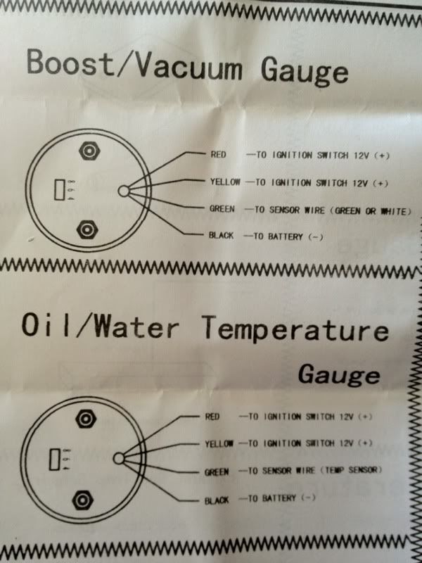

1. All 3 gauges have got the same 4 colour wires coming out of them Green (signal), Blacl (- earth) , Yellow (+ ignition switch), Red (also + ignition switch).... Now is there any problem connecting the 3 Black wires together and just routing one wire to the earth? same with the Yellow and Red going to the Live? Why route 9 wires if you can just route 3??
2. The red and yellow wires. Am i correct in thinking one is a constant live (ignition?) ant the other is a switched live (headlights?) which is which?
3. what/where shall i connect the Earth, Live to? Cig lighter? Headlight?
Ta for any help  :-) :-) :-)

wiring instructions i got with

Not sure about your wires ,but on a stereo, the yellow is permanent live, and red switched live
cigarette lighter would have them on when the ignition is on ,light circuit would have them on when your lights are on
again not sure if the live is needed to power the gauges ,or just light them up ? yellow might be for the illumination, red for power ?
Sounds easy doesn't it   s:roll: :roll: s:roll:
Hold one black wire from a gauge on the negative and try yellow on the live and visa versa on using black with red. One power will light it up the other will move the needle.

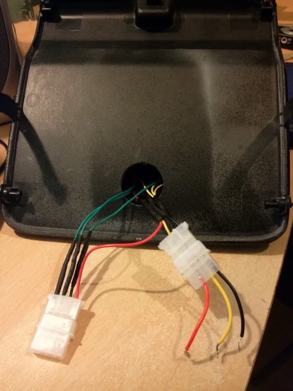

Ok so i nearly exhausted all my electrical knowledge today and  ive found that the yellow is for the lights and the red is for the constant live, ive got the pod all wired up now ready for wiring in to the car, even had the vac gauge working on the kitchen table   s:bounce: :bounce: s:bounce:
Now... is there any problem with wiring the constant in to the cig lighter? i dont want to have the gauges on then try charging my phone with the lighter and see smoke   s:flame: :flame: s:flame:     s:? :? s:?   or would anyone recomend a better place to splice in to??
Also... where do i find a wire to splice in to for the lights? same applies, am i going to see smoke when i turn the gauges/lights on   s:? :? s:?
 On a plus note i managed to get the batteries in the tv remote the rite way round this evening   s:bounce: :bounce: s:bounce:     s:lol: :lol: s:lol:  (this just about wasted all my left over electrical knowledge   s:roll: :roll: s:roll:    s:lol: :lol: s:lol:  )
pick a colour, any colour   s:D :D s:D

Cigar lighter should be fine for moth battery and eartg, it's designed for the current draw of the lighter so can easily cope with the gauges and a charger or two.
p3t3
cheers.
I got this wired up to the cig lighter no prob. I put a 5amp inline fuse in too for price of mined. maybe over kill though but as im not too clued up with this sort of thing I thought it wouldn't harm anything.
just in the process of routing the sender wires to the engine now
