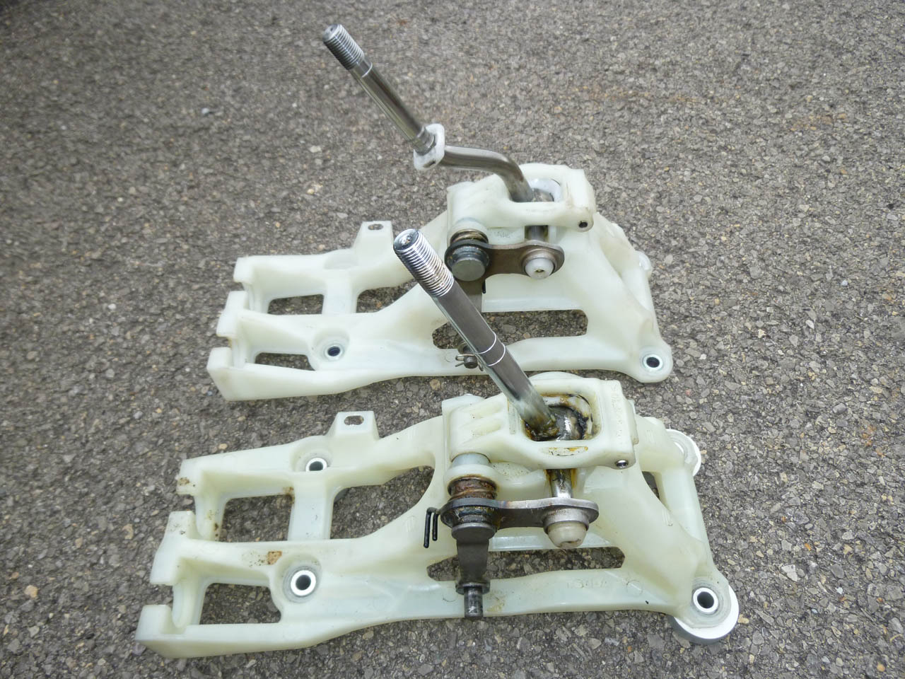

I have had both but definitely prefer the TRD; the eBay is still a marked improvement over the stock one on a budget though. The main difference of it being more solid is the metal cage bushings that come with it (to replace the existing rubber ones), even just changing them could be an option. The gears are in a slightly different place (further to the left), due to it being straight and not curved like the stock/TRD, but you get used to it pretty quickly.
I took some pics when I changed the eBay to TRD, here is a comparison (if you hadn't worked it out, eBay is closest to camera) :
 m http://www.azekiel.co.uk/mrs/images/shortShifters1.jpg m  - in 3rd gear position
 m http://www.azekiel.co.uk/mrs/images/shortShifters2.jpg m  - in 4th gear position
And here is stock vs. eBay -  m http://www.azekiel.co.uk/mrs/mods/shortshifter.html m
