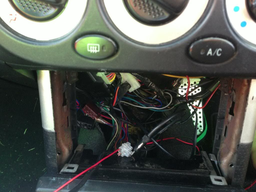

Hiya I just brought a jvc av61bt and I slotted the DVD in and gaps are showing each side I was wondering
What facia kit do I need and by the looks of it it don't look like there's anywhere to fix the kit as there's two metal plates each side .... Photos to follow

 m http://s1059.photobucket.com/user/vini1 ... 1670062293 m
did yours look like bellow when u took yours apart?

pretty much, before i had a tidy up  s;) ;) s;)

Quote from: "vini"Hiya I just brought a jvc av61bt and I slotted the DVD in and gaps are showing each side I was wondering
Trim Varies  depending if facelift or not
 l viewtopic.php?f=47&t=17670 l

Thank you was very helpful thanks didnt know u had to take the side plastic trims off all sort of make sense now but the one I'm fitting is a double din hop the fitting kits will be simular when I push my double din in it touches both sides where the metal plates are !
trevsmr2
Quote from: "vini"Thank you was very helpful thanks didnt know u had to take the side plastic trims off all sort of make sense now but the one I'm fitting is a double din hop the fitting kits will be simular when I push my double din in it touches both sides where the metal plates are !
The fitting kits are mainly to convert from double (as standard) to single aftermarket units ,
sounds like you need the 2 standard Toyota fitting brackets and trim pieces  instead
as in this write up , (CTP in the affiliates section maybe able to get them,pm him.)
86221 -52050 : Left hand spacer
86221 - 52060 : Right hand spacer
86211 - 17050 : Left hand mounting bracket
86212 - 17050 : Right hand mounting bracket
 l viewtopic.php?f=47&t=12583 l
