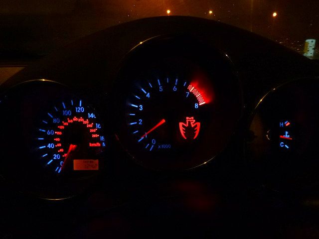

Jay67
before you pull the binnacle off drop the steering wheel, makes it easier
wide angle LEDs work fine in mine
Jason
1999 Lagoon blue MR-S, lots of stuff
OldMan
Quote from: "Jay67"
That looks nice, but it doesn't look standard.
Have you started a thread explaining how you did it?

Jay67
purchased from a company call Metal Monkey a few years ago, several people have had them made up, straight swap for original dial faces. Posted something in the appearance section when I first fitted them.
Jason
dj2k21
I also got mine from metal monkey along with the heater ones too. Great quality
