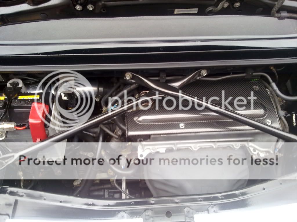

CRACKED IT
The plunger in the engine bay had been bent down and wasn't being pressed by the lid.
The bracket was straightened and all works OK now.

patc
Sorry to bring up an old thread, but what do you mean by the plunger in the engine bay and what bracket?  Many thanks , Pat
2000 Silver, Red leather interior
AndyM
If you look just to the top right of the red battery terminal you'll see a bracket with a black press sensor on...
Ex-owner: 2003 Sable - Hardtop, Black Leather, A/C, lots (and lots) of mods
Where the red plastic battery terminal cover is, it's the round black thing at 1 or 2 o'clock.
