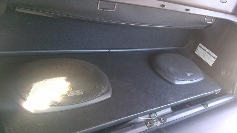

Markb
The Sony WX GT90 BT can run a sub by using ONE rear channel if not using rear speakers..........OR if you fit rear speakers the unit has a rear bass enhance feature which turns the rears into subs.....not earthshaking but not bad at all tbh.
I did the latter with some old Pioneer 6x9s i had in the garage,fitted them in the rear cubby hole......happy enough with it although i might fit one of the powered subs sometime as i have one in the Rav4 i really like.
