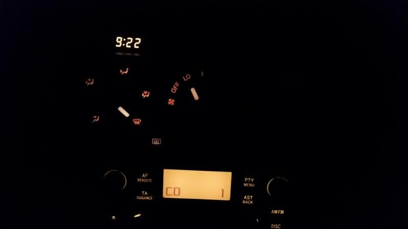

Anyone any idea why my heater/blower controls are only half lit as pic below:-
Was hoping it was just a fuse, but no idea which box or fuse it might relate to.

More likely a bulb behind the panel.
Quote from: "StuC"More likely a bulb behind the panel.
^ This
If you need to take a look, pull off the knobs and there are 2 screws behind (ooo err).

I have this every now and again in the exact same area!
... I give it a good smack - it always comes back on!    s:lol: :lol: s:lol:

Haha, ok, I will give it a good smack and if that doesn't work will remove the dials and check the bulb and replace if necessary.

Meant to post before, but yes, giving the dash a wallop had the desired effect!
